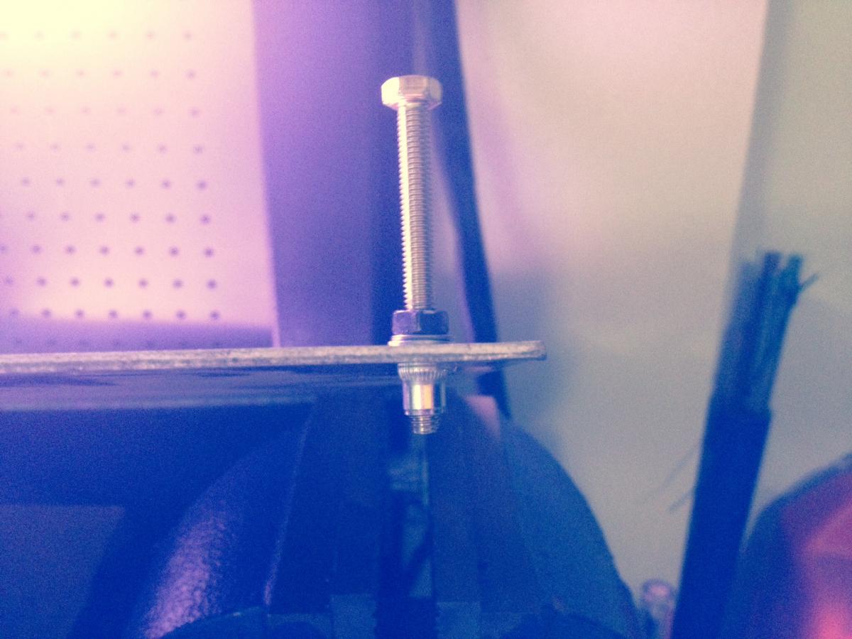

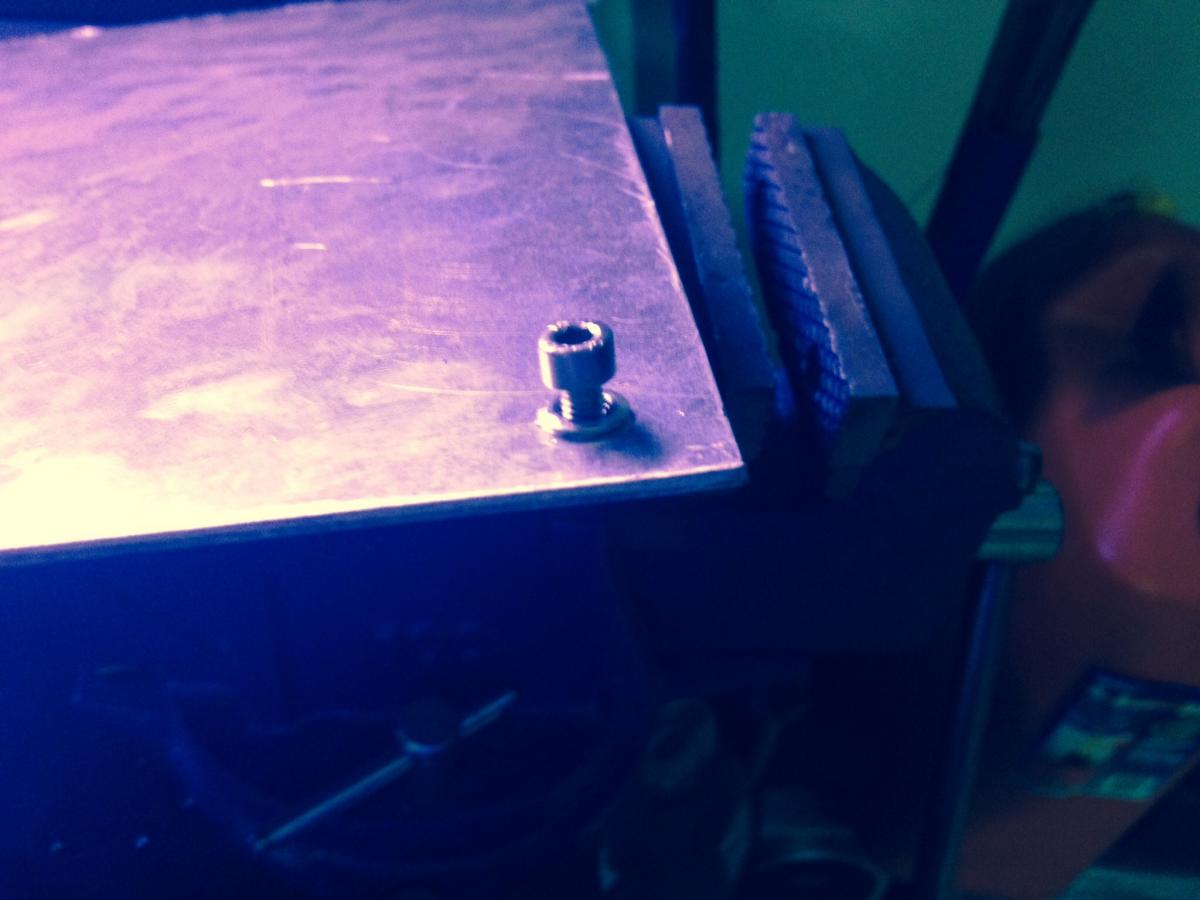

I used nutserts for the first time today.
I'm now in love and am thinking of leaving my wife to marry one.
What an awesome little invention !!!!
Here's a 5mm one I did a test run on.
post-48538-0-80982200-1401103432_thumb.j
post-48538-0-11706400-1401103476_thumb.j

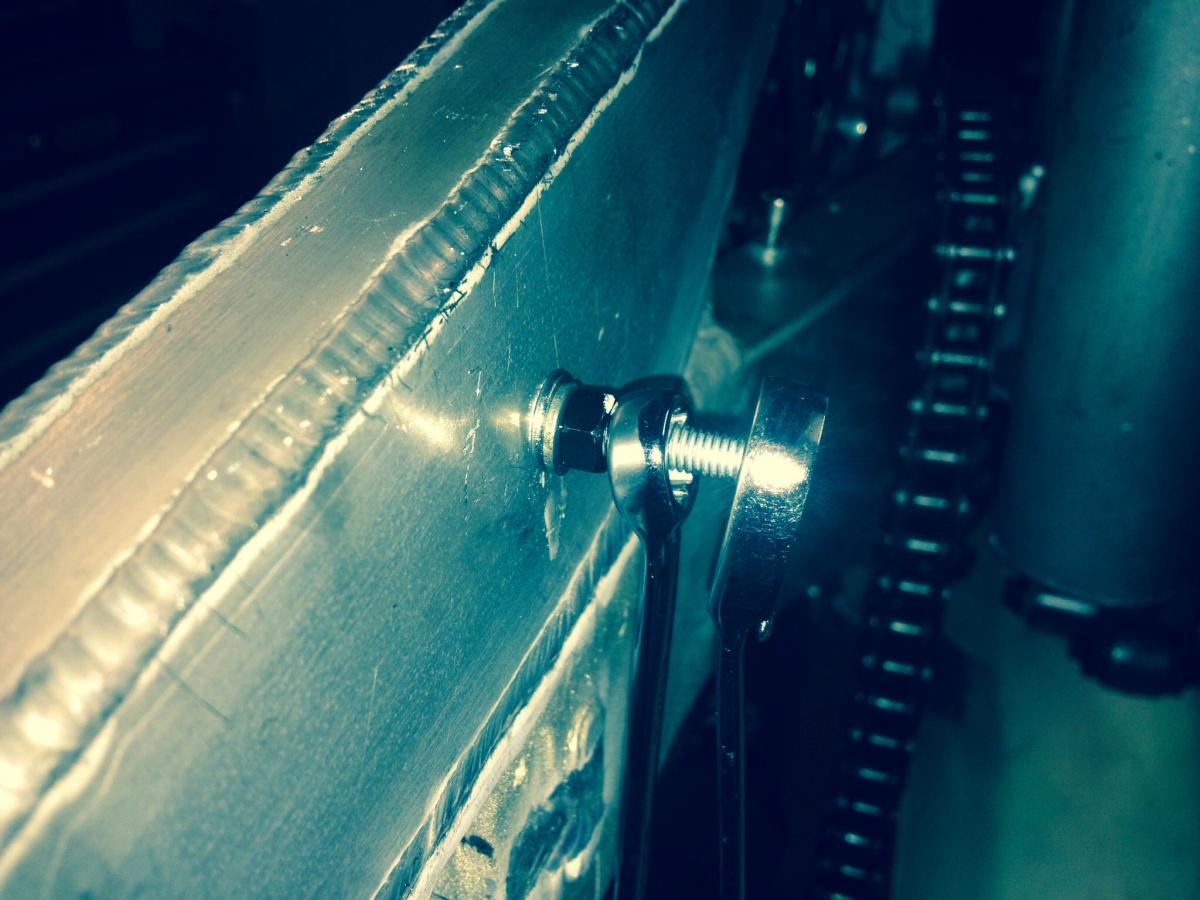

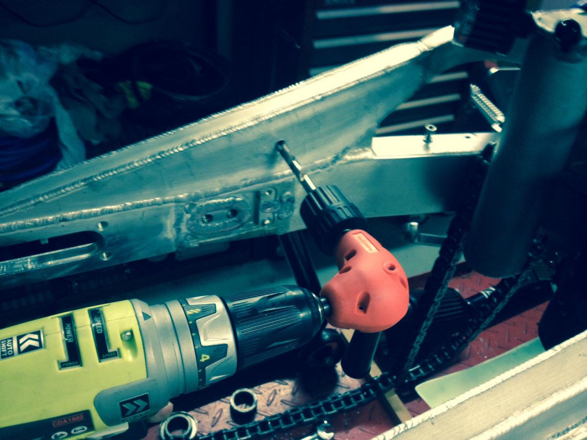

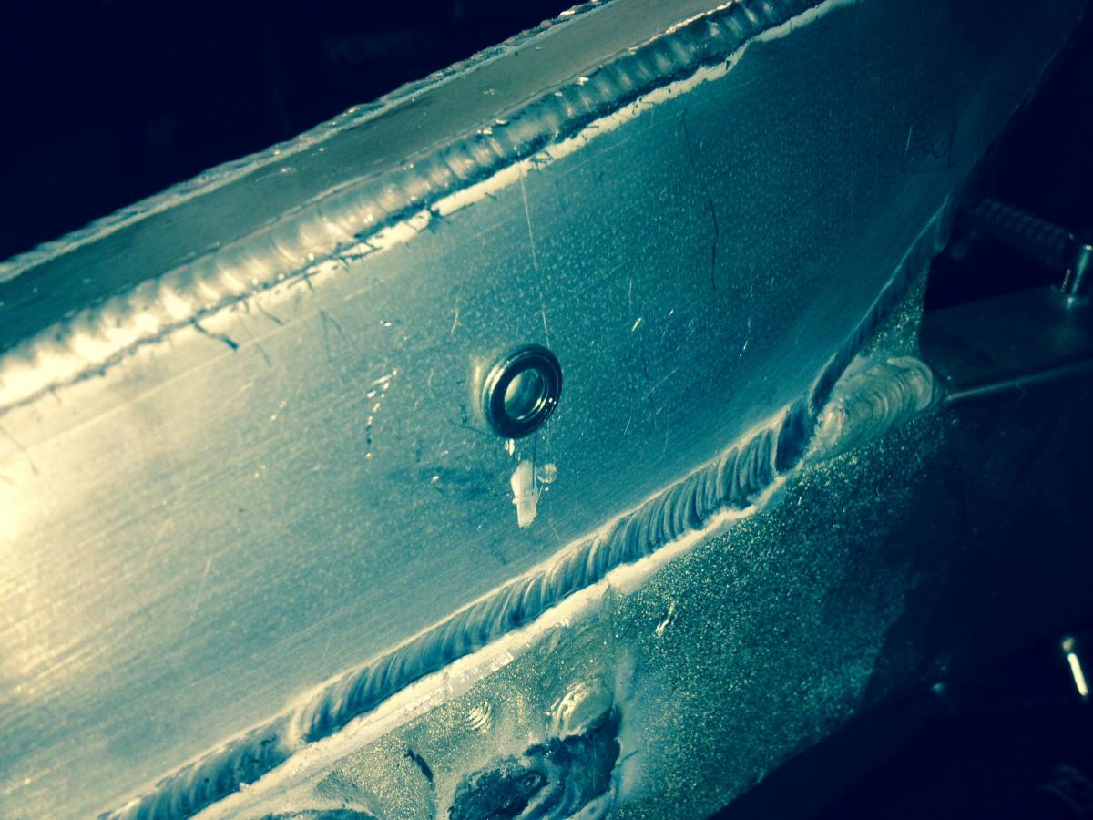

Then it was time for the real thing, this time in 6mm.
post-48538-0-42150700-1401103620_thumb.j
post-48538-0-23433700-1401103754_thumb.j
post-48538-0-52561600-1401103850_thumb.j
So easy to install with just a nut, bolt and washer.
I have a few things to mount on the Alky bike and this will make most of it a breeze!!
So awesome :) I'm stoked !!!
