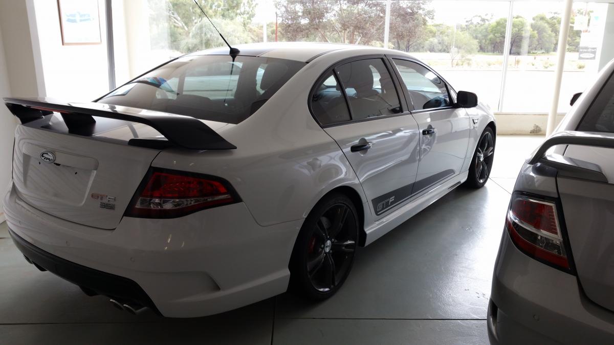

Ralph Wiggum Moar Powar Babeh Legacy Donating Member 19,334 Member For: 20y 10m 30d Gender: Male Location: Perth Posted 25/07/15 11:09 AM Posted 25/07/15 11:09 AM 1
PTR_NITRO_FG Legacy Donating Member 3,214 Member For: 13y 2m 27d Gender: Male Location: NOR Perth Posted 25/07/15 11:43 AM Posted 25/07/15 11:43 AM Buy it ralph....have the best of both worlds 1
