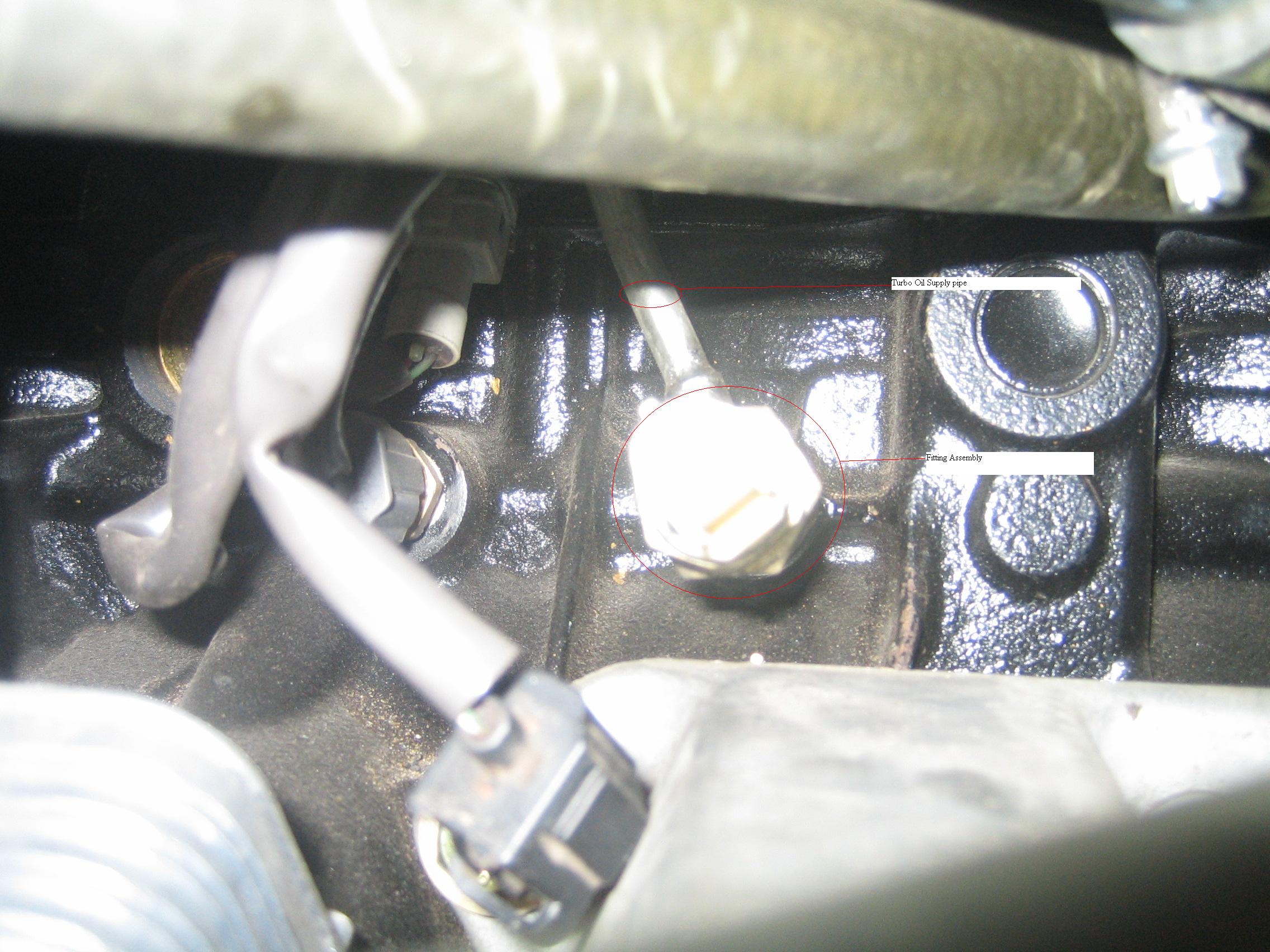

Hey guys the new engine in my car has done almost 10000k's now so i decided i would be a good time to remove the oil supply screen and inspect and clean it. I wanted to ensure there was no metal or debris in it from the running in period and with Ninka helpful expertise removed, cleaned and refitted the screen. I took as many photos as i could but its very difficult to get a decent shot of the assembly on the car. With the recent run of turbo failures i thought a how guide might be helpful.
Heres a basic how to guide...
Step 1: Find the Damn thing:Jack the car up and place it on good jack stands.The Turbo oil supply fitting is located on the left side of the engine block directly above the LHS engine mount. The easiest access is from under the car up and over the engine cross member near the starter motor.

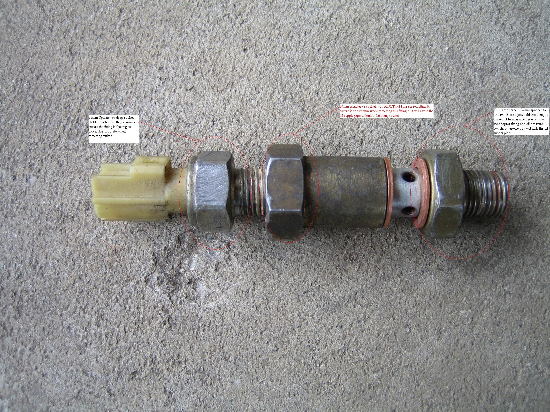

Step 2: removing the fittings:1st you need to remove the oil pressure switch wiring. Then you need to remove the adapter fitting for the oil pressure switch to remove the pipe from the screen. To do this you need a 24mm spanner to remove the adapter fitting and another 24mm to hold the screen fitting that screws in to the block. Its VERY VERY important that you hold the screen fitting in the block to prevent it from rotating and kinking the oil supply pipe as you try to remove it. If you remove the oil pressure switch first (22mm socket or spanner, once again make sure you hold the filter screen) you can use a socket to remove the adapter.
Step 3: Remove the Screen: Not quite as easy as it sounds....If you car has an FPV oil cooler fitted and has a ZF6 speed trans this step is going to make you cry.. :spoton: The access is very tight. Remove the screen from the engine block with a 24mm spanner.

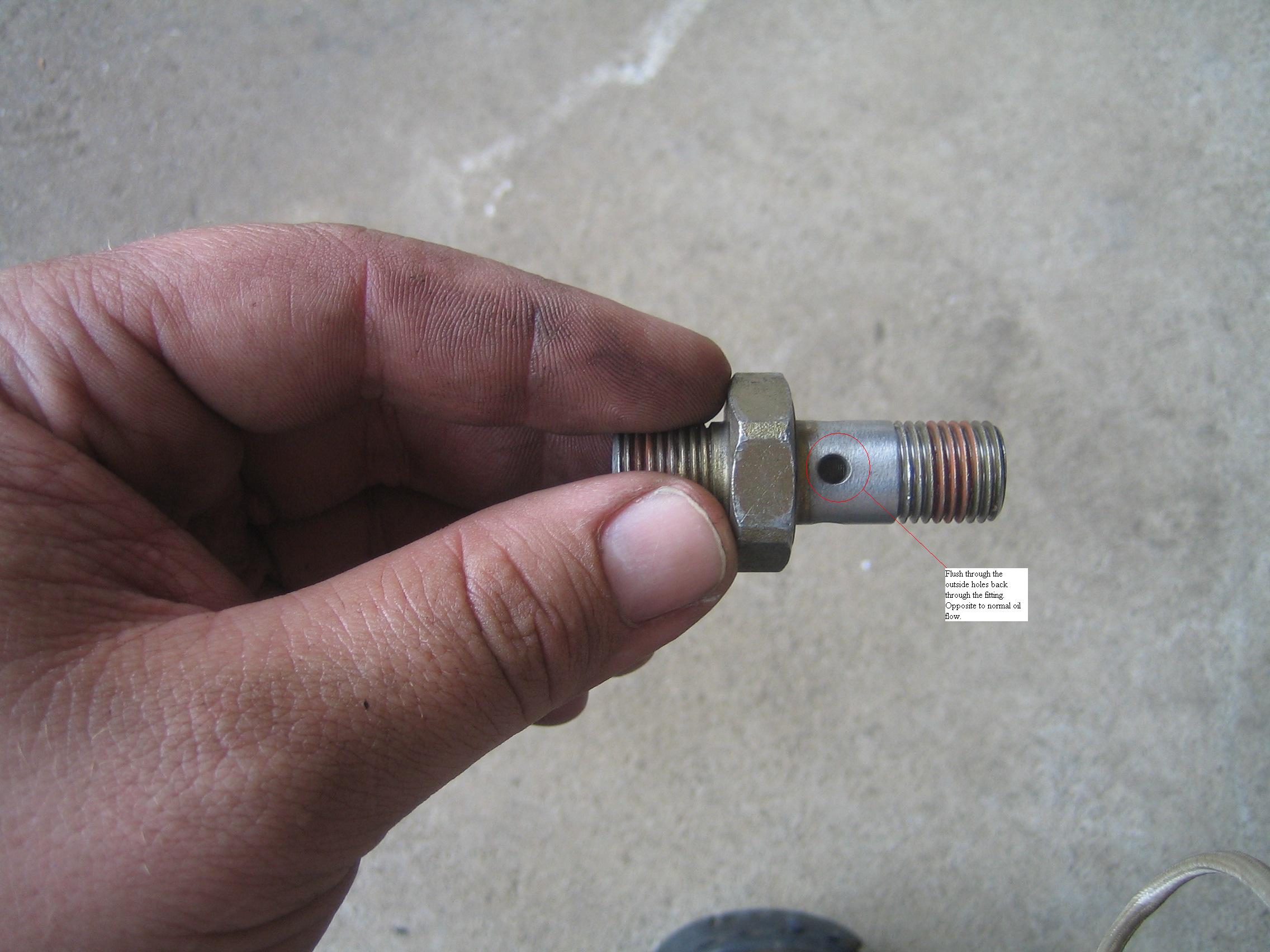

step 4: cleaning the screen: I used CRC contact cleaner but any spray solvent will do.(ie carby cleaner) Spray through the hole back into the fitting. This is the opposite direction to the normal oil flow and will flush the screen. Once you have flushed the screen spray any debris from inside the fitting with the solvent. Use a wire brush to remove any old sealant from the screen and oil pressure switch. Use your solvent to clean out the adapter fitting.

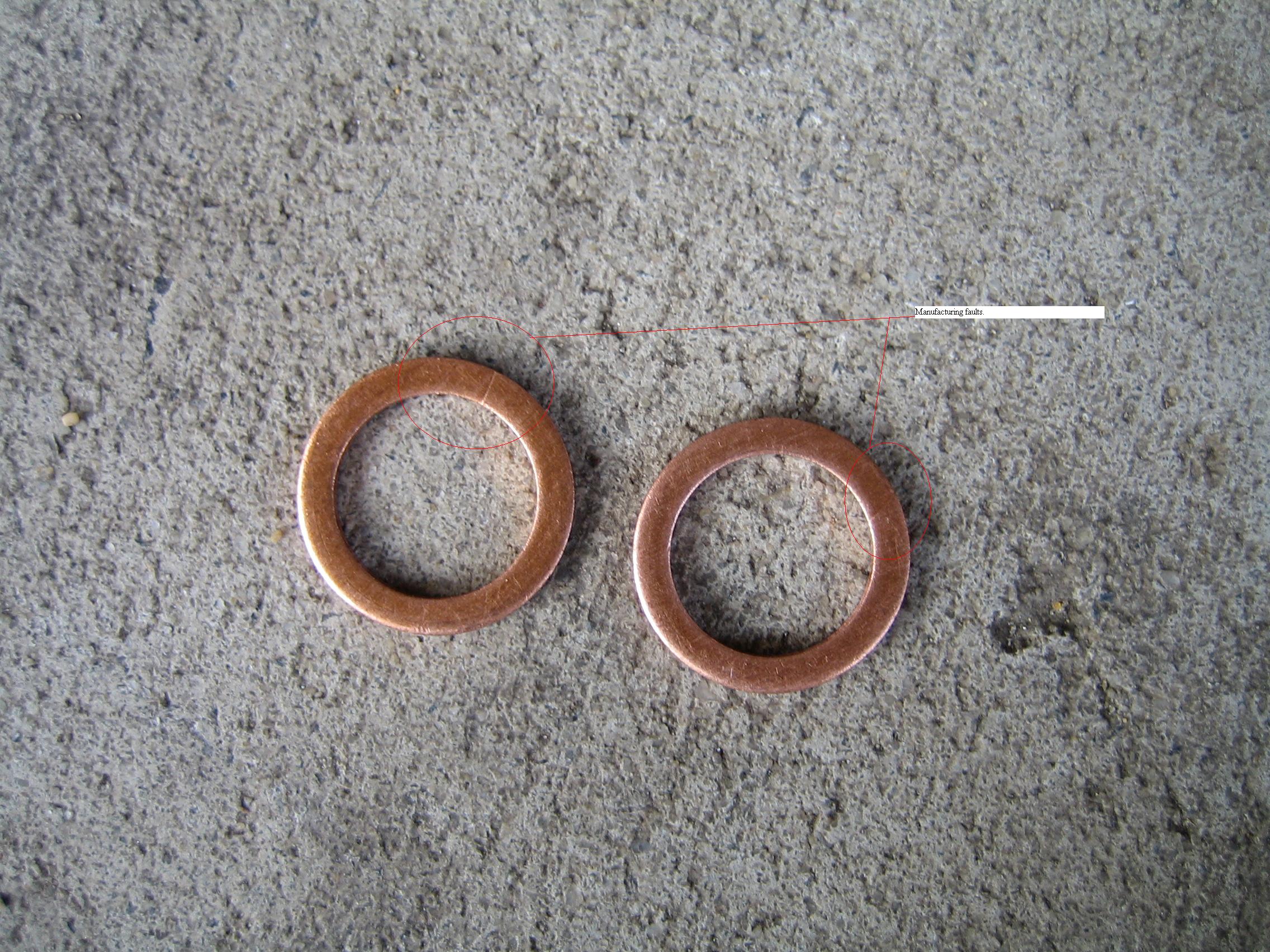

Step 5: Sealing washers: The washer are available from Ford (part number: E8321495300) They all come from Ford with marks in the sealing surface from when they are manufactured.(Ninka Tip #1) To ensure the best seal its advisable to remove these marks. The best way to do this is with a piece of Wet and Dry sand paper on a flat piece of wood or glass. A smooth piece of concrete also work well (thats what i did... :spit: ).Annealing the copper to soften it will also enhance sealing
They should be more like this.....the smoother the better you want to get ride of any deep grooves. The very light surface marks don't matter.

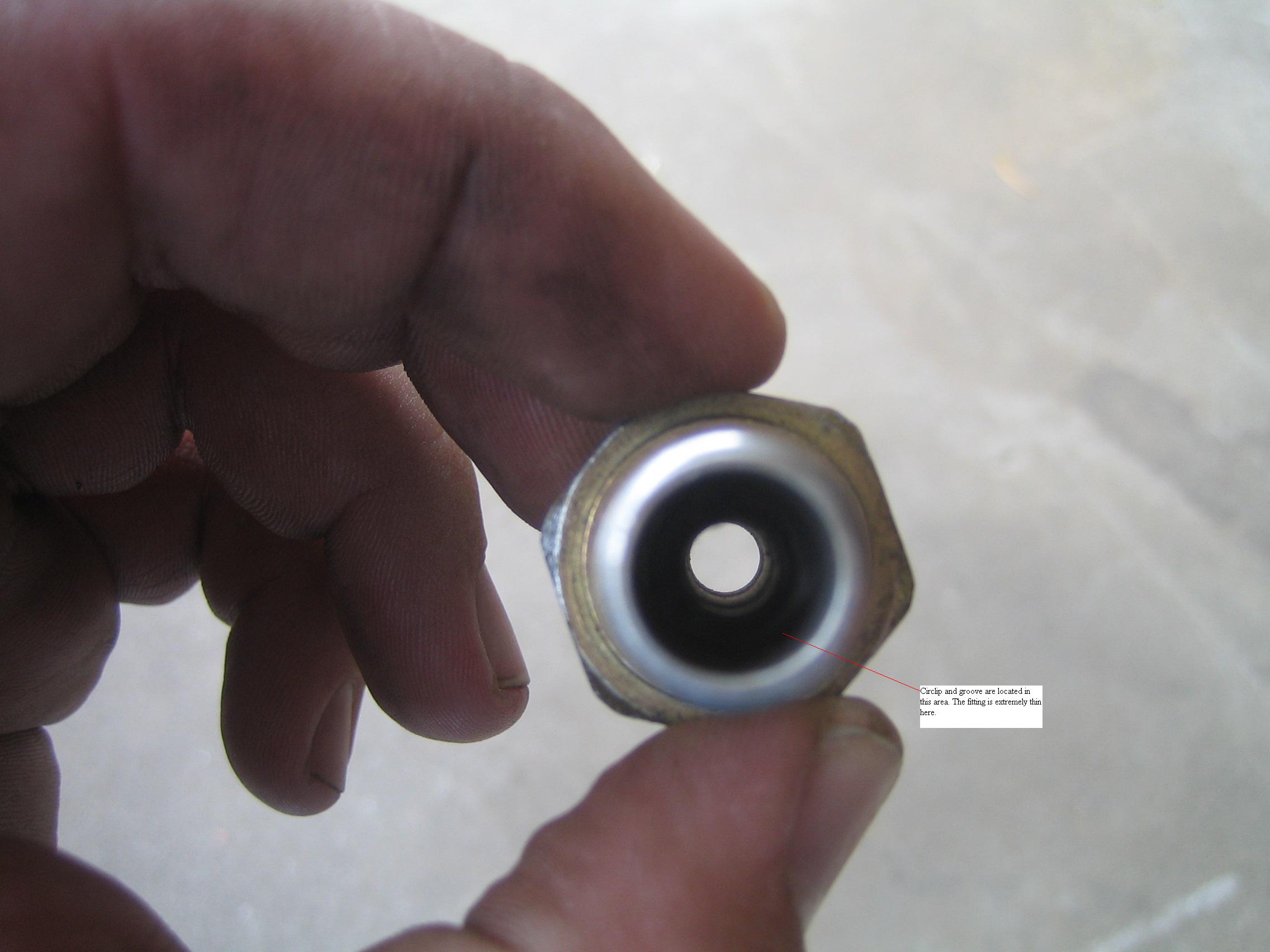

Step 6: Reassembly: The Screen fitting has a circlip groove cut into the inside of it for the screen retaining circlip. The fitting is EXTREMELY THIN . in this area if you try to over tighten the adapter fitting onto the screen YOU WILL BREAK THE SCREEN the scrren fittings are $70 a pop from your local Fraud service center.
