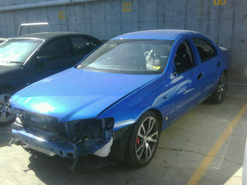

BF_F6Shockwave Member 444 Member For: 17y 6m 4d Gender: Male Location: Newcastle NSW Posted 20/08/09 03:22 AM Posted 20/08/09 03:22 AM 5 days , is that for a full bare metal respray? The pic below was mine yesterday, they have had it for 4 days and said it will be about a 4 weeks, they are stripping back to bare metal by hand.
jackal Member 13 Member For: 21y 6m 12d Posted 20/08/09 08:29 PM Posted 20/08/09 08:29 PM 5 days , is that for a full bare metal respray? Yes. When you do a few of them the process starts to streamline a bit. We usually go pretty hard on them, disassembly/glass out by lunch time, paint off by the end of the 1st day, 2nd day undercoat, 3rd day rub/paint, then assemble, glass back in, buff/detail and out the door looking better than new. We usually try to get them out the door as fast as possible because of the nature of the job you end up with parts and panels everywhere taking up floor space.
