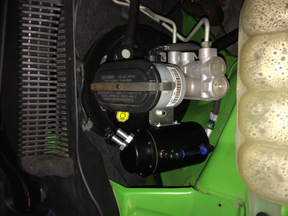

10SECN Member 516 Member For: 13y 2m 22d Gender: Male Location: west hoxton Posted 11/12/14 12:14 PM Posted 11/12/14 12:14 PM Grabbed this tiny one off ebay. $40 something delivered. Gave it a coat of satin black to get rid of what ever gay brand is on it. Filled it with steel wool and all good. My car did not need it so far ( zero oil ) after 2000 kms and yes it has hoses connected now
masda74 To Loud Legacy Donating Member 4,114 Member For: 14y 7m 24d Gender: Male Location: WA, Perth Posted 12/12/14 02:00 AM Posted 12/12/14 02:00 AM ^^^^ you may want To remove the steel wool and put some scourer instead, as per a few posts before in one of the pictures. 1
10SECN Member 516 Member For: 13y 2m 22d Gender: Male Location: west hoxton Posted 12/12/14 03:40 AM Posted 12/12/14 03:40 AM yeah that's what I got ... don't know the technical name lol 3
masda74 To Loud Legacy Donating Member 4,114 Member For: 14y 7m 24d Gender: Male Location: WA, Perth Posted 12/12/14 04:30 AM Posted 12/12/14 04:30 AM Just making sure as it has been mentioned about the steel wool bit. 1
10SECN Member 516 Member For: 13y 2m 22d Gender: Male Location: west hoxton Posted 12/12/14 09:06 AM Posted 12/12/14 09:06 AM Mrs brought home the soap ones to start with 1
