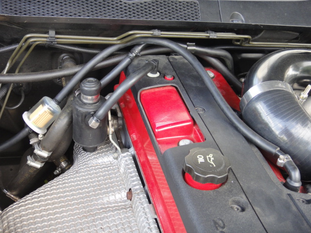

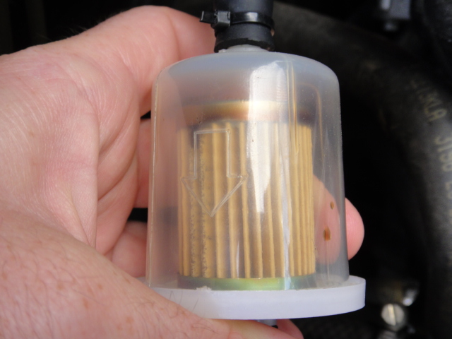

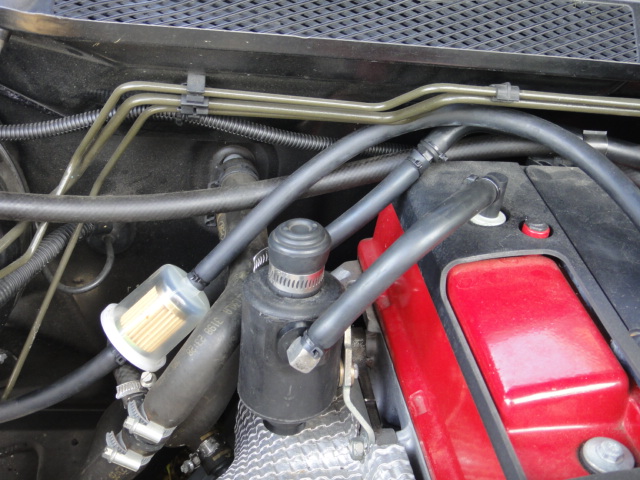

bjc Legacy Donating Member 2,823 Member For: 22y 10m 19d Gender: Male Location: Townsville Posted 02/10/10 04:37 AM Posted 02/10/10 04:37 AM Totally agree with the rear line on the rocker cover having a catch can attached. I had the front breather hooked up to a catch can for ages and found it had virtually nothing in it until recently I changed my injectors and looked into the plenum and found easy a teaspoon of oil sitting in each donut runner thingy!See attached pics now for my recent setup, nothing special as I just went off what someone else did with the fuel filter inline from the front breather and my $50 catch can stuffed with steel wool (steel shaving like ball shaped scouring pads!) in the back breather. I'll check in a month or so the amount in my catch can and see what it accumulates but dare say it will be a fair bit. The front breather as you see in the photo has stuff all oil and this is about 2-3months worth.p.s. Yes that is a rubber chair foot on the top of the catch can!
hawlass Legacy Donating Member 1,161 Member For: 18y 8m 14d Gender: Male Location: left right out Posted 02/10/10 05:18 AM Posted 02/10/10 05:18 AM Awesome, thanks bjc, that's what I was wondering too- if the rear breather was the big offender.Looks like the front one is hardly worth a catch can.So where does the other end of the rear vacuum line attach too/end? (not the rocker cover end)
bjc Legacy Donating Member 2,823 Member For: 22y 10m 19d Gender: Male Location: Townsville Posted 02/10/10 07:35 AM Posted 02/10/10 07:35 AM Awesome, thanks bjc, that's what I was wondering too- if the rear breather was the big offender.Looks like the front one is hardly worth a catch can.So where does the other end of the rear vacuum line attach too/end? (not the rocker cover end)Yep rear breather is the offender for sure. The other end attaches underneath the standard plenum, roughly in the centre if I remember?. I originally didn't even take notice of it until the injector change and holy fck it was worse in there than my old BA XR8 and it was supercharged! I just put breather filters on both sides of the V8 and that was a big mistake, use to smoke its tits off under wide open throttle, lol.
