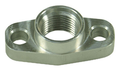

1600dave Legacy Donating Member 872 Member For: 15y 6m 21d Posted 15/12/11 03:02 AM Posted 15/12/11 03:02 AM Use the parts I listed, everything you need is on the Sonic Page. Use a gasket and goo at the turbo end and goo only on the sump and you wont have any problemsDid you reuse the factory bolts with the flanges from sonic? Looking at them, there isn't much room for the bolt head between the mounting hole and threaded pipe section.Just want to make sure I have everything before I go ahead to do this job, as its my daily, going to get different bolts isn't that easy once the pipe comes off!
Ralph Wiggum Moar Powar Babeh Legacy Donating Member 19,334 Member For: 20y 10m 8d Gender: Male Location: Perth Posted 15/12/11 03:04 AM Posted 15/12/11 03:04 AM Your quite right, I used a couple of domed head Allen Key bolts too secure the flanges. 8mmX 20mm would be long enough
bjc Legacy Donating Member 2,823 Member For: 22y 10m 27d Gender: Male Location: Townsville Posted 15/12/11 04:49 AM Posted 15/12/11 04:49 AM What he said. We have a bolt masters up my way that I get all that stuff from. Just take the part into the shop so they can dummy fit them.
Ralph Wiggum Moar Powar Babeh Legacy Donating Member 19,334 Member For: 20y 10m 8d Gender: Male Location: Perth Posted 15/12/11 04:51 AM Posted 15/12/11 04:51 AM I got lucky and had a bag of Caterpillar bolts in amongst my old work stuff. I believe they where a set of D10R interior panel bolts. Where the perfect length and even came with threadloc installed. NOICE! not that thread loct would do much at the turbo end!
1600dave Legacy Donating Member 872 Member For: 15y 6m 21d Posted 19/12/11 08:27 AM Posted 19/12/11 08:27 AM The 19mm hose is a snug fit, but does get in there. 16mm would be easier.Used allen head bolts, that exact size too, 8mm x 20mm long thread.My pipe had a split up on top of the very first rib. Pretty crappy quality thing it is, glad I didn't pay Ford RRP$117 for another (without gaskets)
