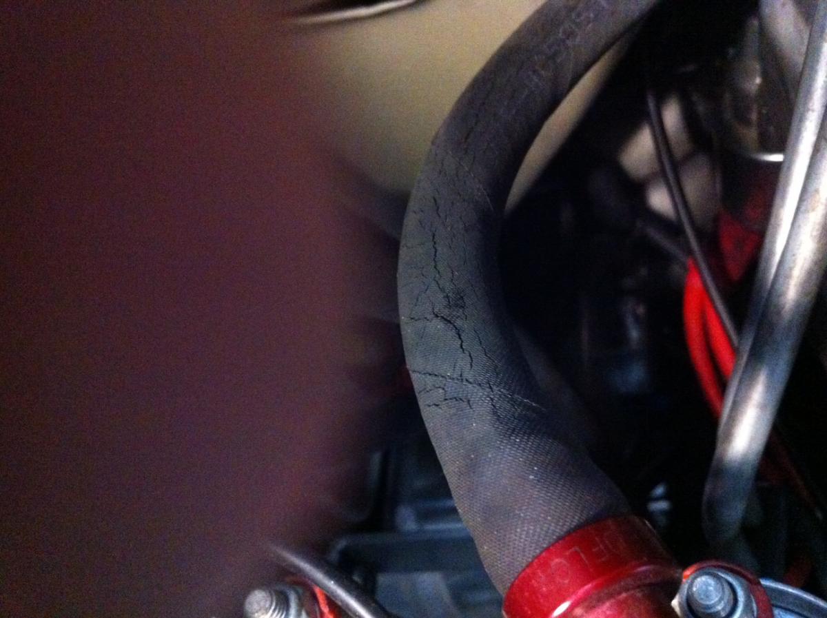

CHLAXN Legacy Donating Member 932 Member For: 18y 2m 23d Gender: Male Location: north QLD Posted 06/05/12 03:03 AM Posted 06/05/12 03:03 AM (edited) Ok guys..Had the ute up on the hoist on Saturday...was having a look at the hoses coming off the Surgetank and found what I believe, E85 was doing to my hose. Am now sourcing a E85 compatible set now.Just a heads up for everyone else that's all.That's why I spent extra money and went with speedflow Teflon braided hose and fittings instead of the rubber hose that come with the kit. Lucky to pick that up mate before it was too late. Edited 06/05/12 03:05 AM by CHLAXN 1
