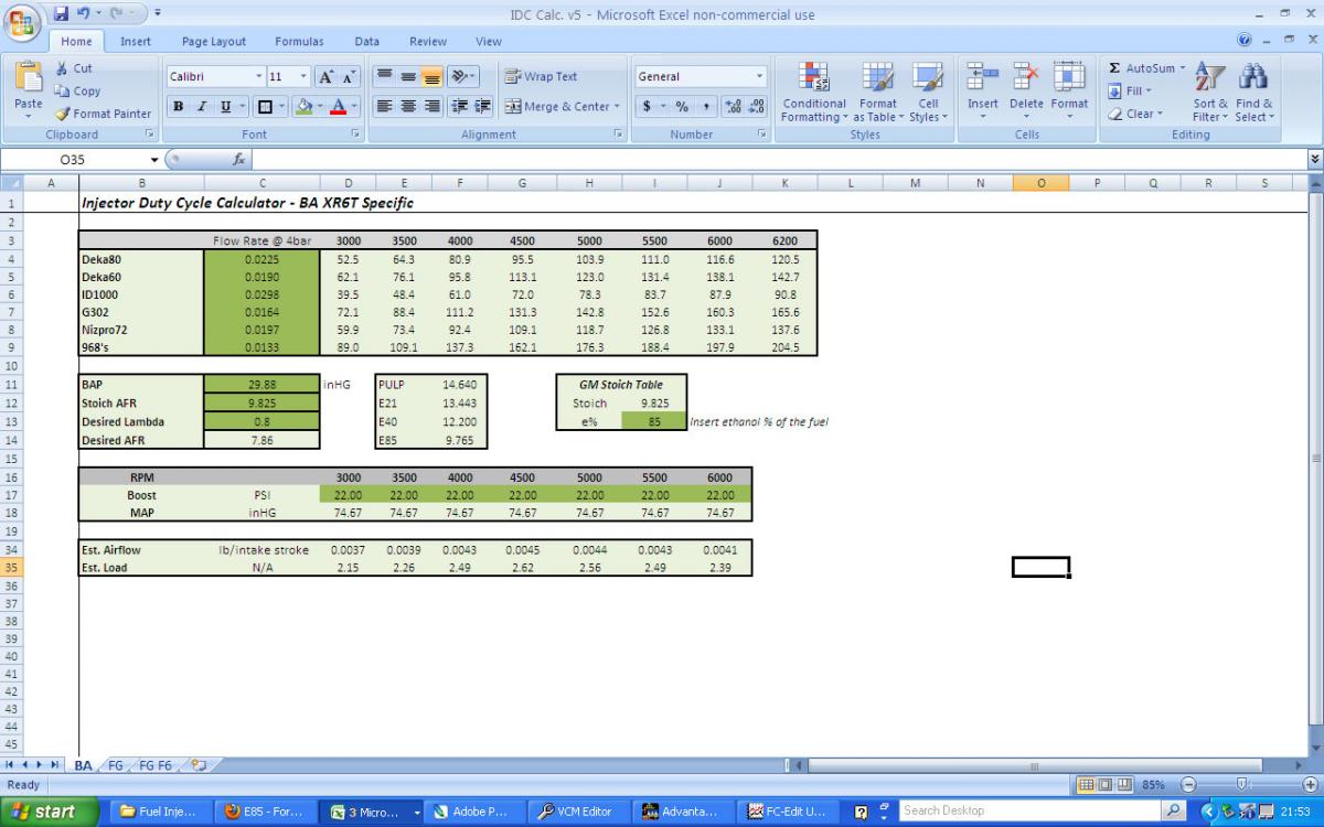

IH8TOADS Legacy Donating Member 3,618 Member For: 21y 1m 1d Gender: Male Location: OZ Posted 07/05/12 02:37 PM Posted 07/05/12 02:37 PM (edited) Interesting thread. IDC is often over looked and Dale makes some good points...obviously educated ones. When I first looked into ID1000's in mid 2010 I was interested to know what IDC they would run on e85 at high RPM and boost, so I knocked up a theoretical calculator in excel based on the ford speed density algorithm, ethanol content of the fuel, desired lambda, inj flow rates etc etc. If you keep the speed density values stock then you have to fudge the high slope which is why the flow rates are different to published data (indicative only). As you can see the difference between 5000rpm and 6200rpm is huge and I think Dale eluded to this. I rev my BA out to 6500 (not always intentionally)....and im sure many others do as well.I use this calculator to give me a rough idea of what I can and cant do in regards to boost and RPM on certain ethanol blends. Power is largely dictated by spark advance so I tend to not quote power outputs. With the deka 60's for example, you dont want to be exceeding 18psi in a BA on e40.You can data log FUEL_PW_CLKTIC via your xcal and this relates to the Injector Pulsewidth. If you log RPM you can also calculate IDC. Only problem is FUEL_PW_CLKTIC is measured in Clock Ticks and I am not confident in the conversion to ms. The American fords and the Aussies use this in very different ways. Dale it would be good if you could do some logs of FUEL_PW_CLKTIC and RPM and compare to you DD equipment so we can work out an equation! My own street testing shows that at 60.4 inHG MAP and 5000rpm my IDC using the FUEL_PW_CLKTIC = ms technique = 44.6% with ID1000's. My 'theoretical' according to my spreadsheet is 48.6% so its pretty close. This tells me its a reasonably good indicator of IDC. If I logged lambda and plugged that in accurately I may have gotten closer......?So if anyone is curious use get your xcal and go do some logs and use the following equation to 'indicate' IDC = ((FUEL_PW_CLKTIC*1000)*RPM)/1200Cheersedit the G302 flow values look like what I was using with a 4.5bar reg. Edited 07/05/12 02:44 PM by IH8TOADS 1
