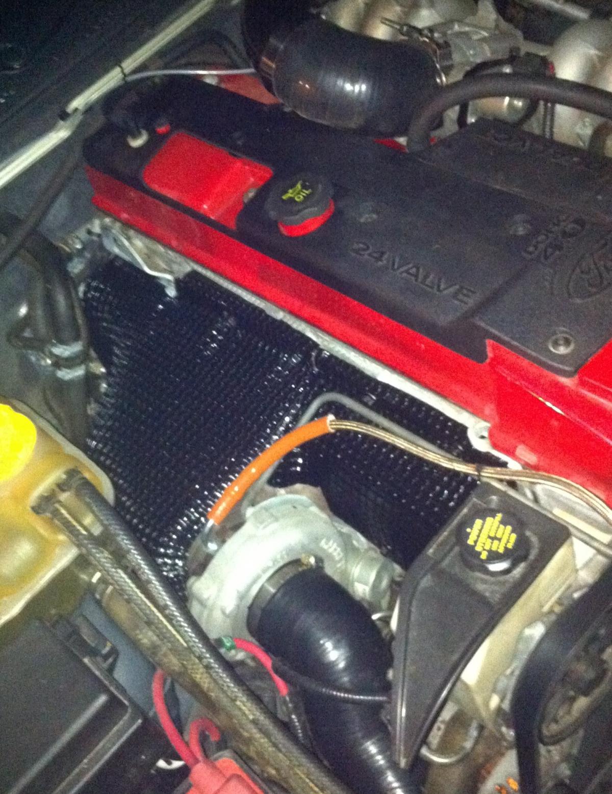

peeeches New Member 9 Member For: 14y 7m 20d Posted 21/05/12 02:23 PM Posted 21/05/12 02:23 PM hey guys been a long time reader first post!so anyway decided to paint my heat shield as I was torquing all the turbo and manifold bolts. anyway tell me what you think 1
daztbo FLY-FPV Legacy Donating Member 474 Member For: 17y 7d Gender: Male Location: Greensborough Vic Posted 21/05/12 08:52 PM Posted 21/05/12 08:52 PM Looks good just hope it lasts lol gets pretty got there
Henz Tampon inserted, Auto Acquired, next purchase a new handbag Legacy Donating Member 9,946 Member For: 18y 4m 15d Gender: Male Location: Vic Posted 21/05/12 08:54 PM Posted 21/05/12 08:54 PM I want to do this, let me know how well it's lasting in a few weeks.
MiKa Legacy Donating Member 4,243 Member For: 19y 11m 14d Gender: Male Location: Melbourne, VIC Posted 22/05/12 01:21 AM Posted 22/05/12 01:21 AM (edited) I wanna do it too...What paint did you use? How'd you do it?Hey maybe powder coated or something?? Edited 22/05/12 01:22 AM by MiKa
Impellor Member 835 Member For: 16y 15d Gender: Not Telling Posted 22/05/12 01:44 AM Posted 22/05/12 01:44 AM From a radiant/thermal heat perspective, the heat shield being reflective is doing its best work. If painted black it would increase its ability to draw more heat away from the turbo quicker. This heat would then translate to higher under bonnet temps( up to 8%). Buy being reflective it is actually reflecting the radiant heat back onto the turbo, and further,it is the least efficient surface colour for heat transfer. This basically means that a greater amount of heat is being restricted to the turbo area. Because as we know a turbo is spooled by heat, not exhaust flow as such. To paint it black would reduce performance marginally, especially in hot weather. Due to increased intake temps. That said, this condition would be greatly reduced on FG models (due to intake location) and earlier models not using crossover. Cheers

rbjet Skid Machine Legacy Donating Member 1,640 Member For: 15y 2m 11d Gender: Male Posted 22/05/12 01:56 AM Posted 22/05/12 01:56 AM I don't think anyone asking about the black paint still has a crossover in their car.What if the top of the shield was black and the underneath part was still silver. Then what happens? 1
