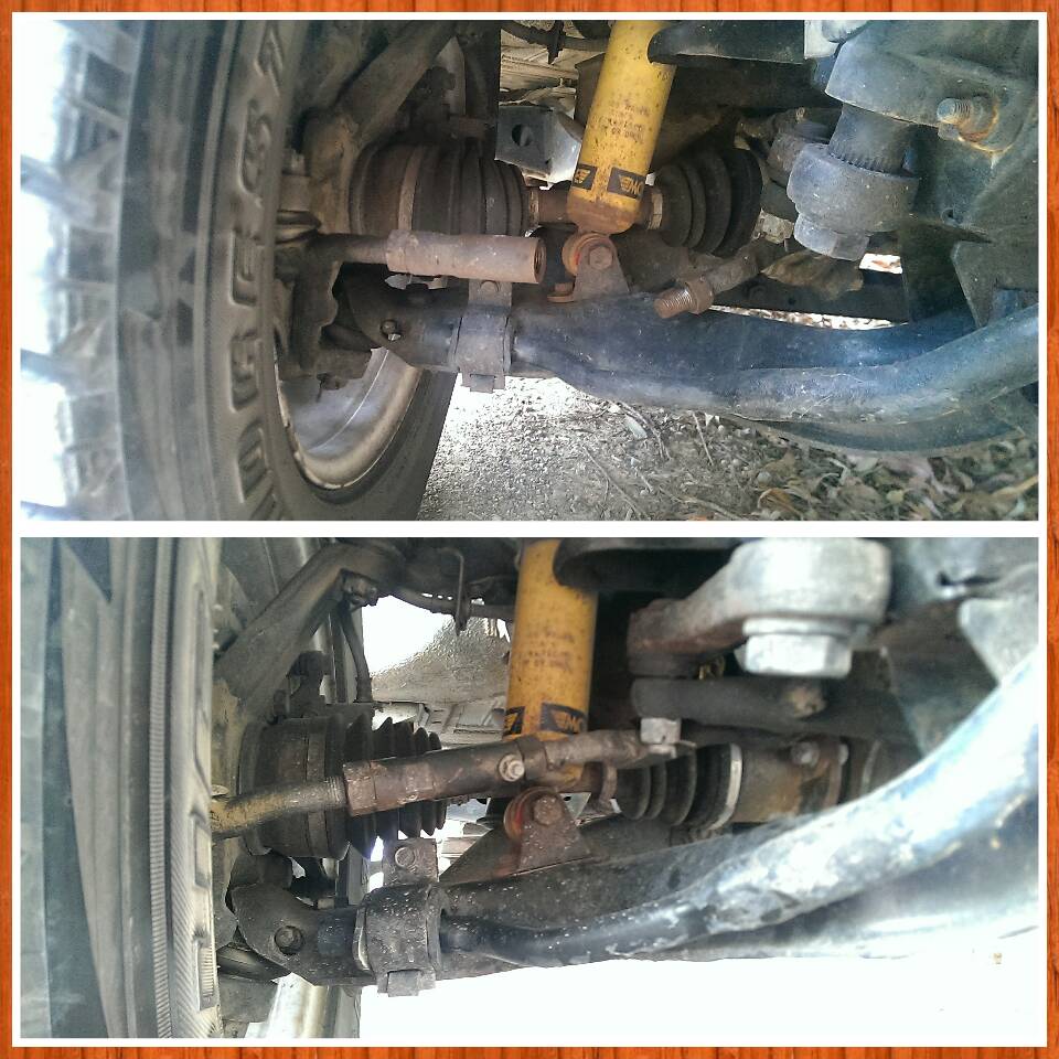

gaz097 Legacy Donating Member 1,752 Member For: 15y 22d Posted 05/10/14 10:59 PM Posted 05/10/14 10:59 PM Stripped a tie rod bolt 20 kay's into the Bush in the daily. Borrowed a drill and stole a bolt of the motorbike and came up with this temporary solution. Managed to make the 200 Kay trip home. 1
Spyathe Legacy Donating Member 872 Member For: 12y 9m 14d Gender: Male Posted 05/10/14 11:37 PM Posted 05/10/14 11:37 PM Bush mechanics!Did you roll the car onto the roof for easier access?
Wilko16 Legacy Donating Member 1,672 Member For: 18y 8m 22d Gender: Male Location: Melbourne Posted 05/10/14 11:43 PM Posted 05/10/14 11:43 PM That is a permanent fix! Jumper leads and an old spanner work as a welder to [emoji106]
