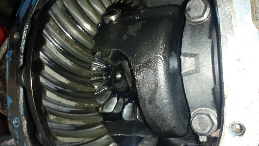

bamk2f6tornado Legacy Donating Member 777 Member For: 12y 8m 7d Gender: Male Location: Rockhampton Qld Posted 19/03/15 12:00 PM Posted 19/03/15 12:00 PM Opened up the Diff to look at a suspected failed pinion bearing to find this. Cracked in 3 spots the whole way round and a large amount of wear on some of the gears. Surprised I even made it to the workshop without it going bang. Harrop truetrac has been ordered along with new seals and bearings.

barnz Member 3,047 Member For: 12y 8m 21d Gender: Male Location: Brisbane Posted 19/03/15 08:42 PM Posted 19/03/15 08:42 PM Opened up the Diff to look at a suspected failed pinion bearing to find this. Cracked in 3 spots the whole way round and a large amount of wear on some of the gears. Surprised I even made it to the workshop without it going bang. Harrop truetrac has been ordered along with new seals and bearings.Nah that's within spec mate all good cheers 1
