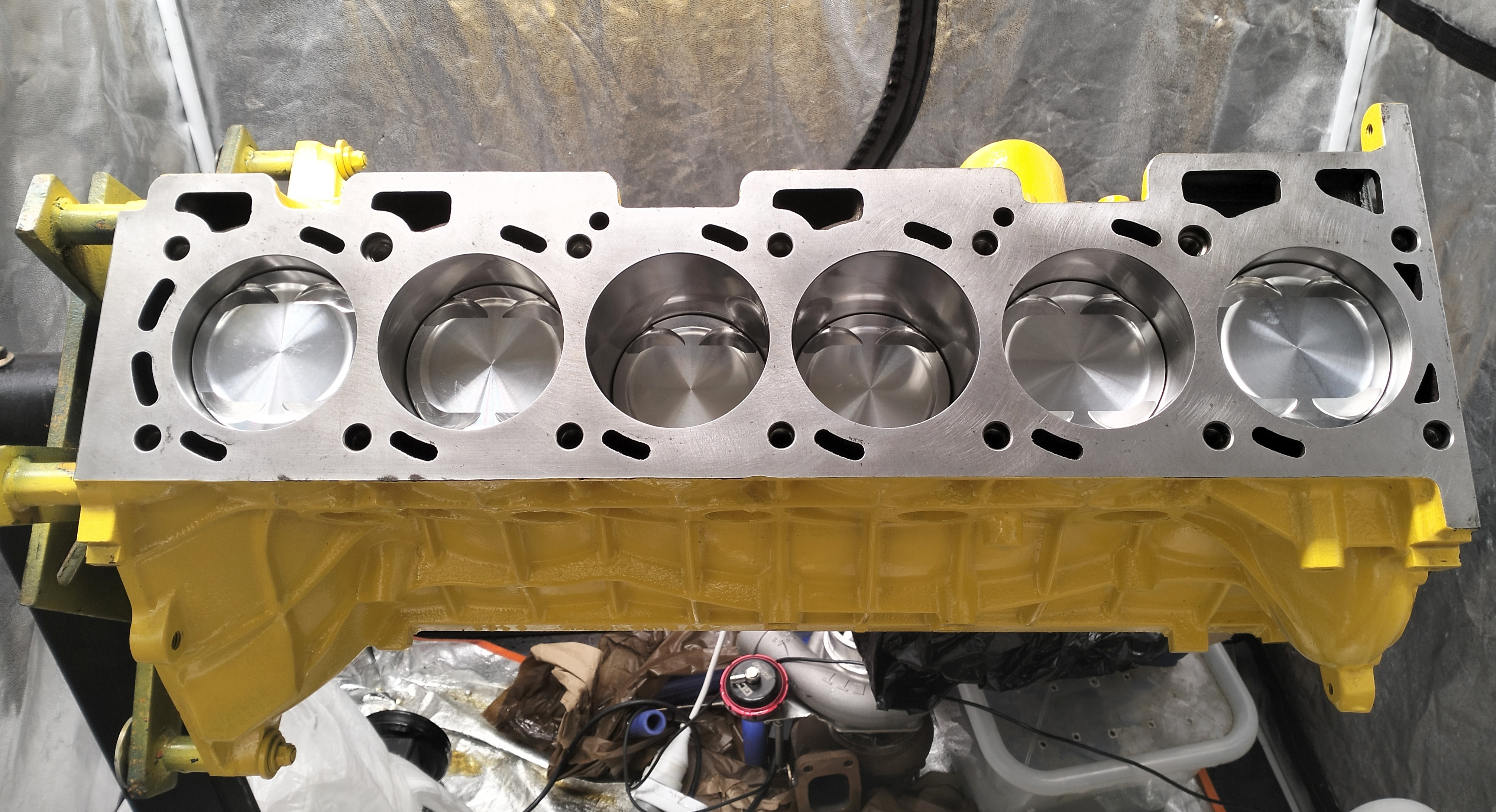

ken666 Legacy Donating Member 140 Member For: 7y 6m 25d Posted 10/09/22 11:10 AM Posted 10/09/22 11:10 AM The thing that made me feel very much happiness today was the moment when I checked my bearing clearances after already building the bottom end once, but when doing the final check of the clearances on the mains, I found that the machinist may have misunderstood what the motor is actually being built for... Street! He closed and line honed and undersized the crank to a clearance of .0032". Reckons that's how he builds super high boost strip cars like that to compensate for crank flex so they don't burn the oil onto the bearing shells! I asked him how do I go about oil pressure once it warms up, he said drag cars rarely get too warm! Then it clicked, ohh are you putting that in a street car? The thing that made me feel happy was learning that he can get undersize in one thou increments, so I only had to change the shells🧐
k31th less WHY; more WOT Site Developer 30,020 Member For: 18y 3m 16d Gender: Male Location: Melbourne Posted 10/09/22 11:13 AM Posted 10/09/22 11:13 AM Good pickup... that could have been a bad time otherwise.
ken666 Legacy Donating Member 140 Member For: 7y 6m 25d Posted 10/09/22 11:25 AM Posted 10/09/22 11:25 AM A lesson for you "do your own work" at home gurus out there... Always flexigauge every bearing for peace of mind when putting all those expensive goodies together. I was dumbfounded when I went to buy it for the build, repco didn't stock it anymore, super cheap staff didn't even know what it is and 2 of the 3 local engine reconditioning shops I visited don't use it anymore? I eventually found an old fella in a mechanical repairs shop that had literally a box of it! 1
Puffwagon Legacy Donating Member 16,348 Member For: 11y 5m 27d Gender: Not Telling Posted 10/09/22 10:57 PM Posted 10/09/22 10:57 PM Plastigauge shouldn't be used as a way to check bearing clearances. You should always use a micrometer. It does have its place but it isn't for initial assembly. Furthermore every clearance in the motor needs checking before assembly to ensure it's correct, it isn't done for peace of mind. You can't just slap sh*t together fresh out of the machine shop and hope for the best, that isn't how you build an engine.
JETURBO ...JD TUNING ADELAIDE... Legacy Donating Member 23,708 Member For: 18y 1m 25d Gender: Male Location: Adelaide Posted 11/09/22 06:38 AM Posted 11/09/22 06:38 AM 32 thousands…. Da fhuck
Puffwagon Legacy Donating Member 16,348 Member For: 11y 5m 27d Gender: Not Telling Posted 11/09/22 08:42 AM Posted 11/09/22 08:42 AM You didn't read that properly bro, you missed a decimal place. 3.2 thou would be fine if the oiling system was up to spec.
