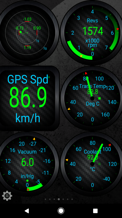

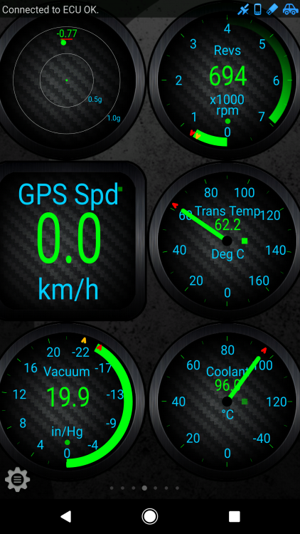

KeepLeft Member 240 Member For: 17y 1m 4d Gender: Male Posted 26/01/13 04:00 PM Posted 26/01/13 04:00 PM Using torque pro here. If you go in to the settings and add a "predefined PID set", you can select Ford. It makes a lot of extra PIDs available to you. There's a couple of different transmission temp ones. 2
