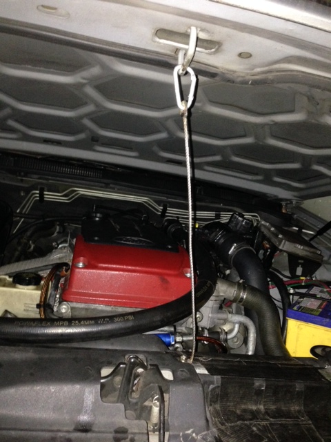

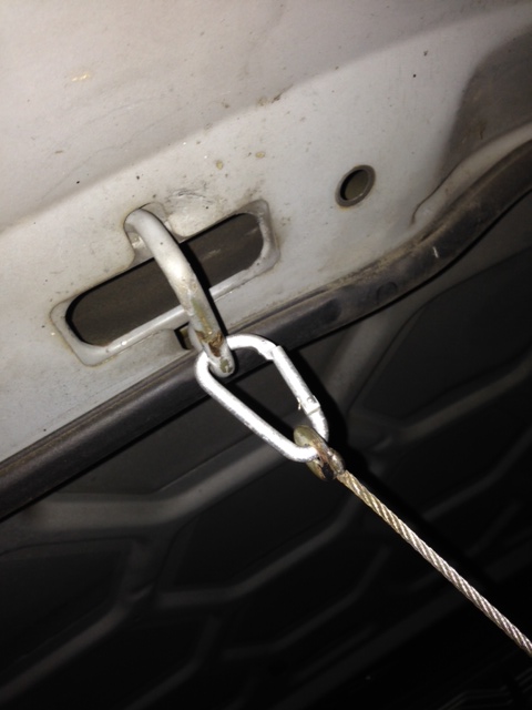

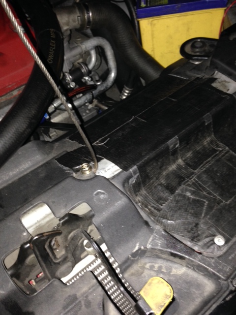

nelsonian101 Legacy Donating Member 961 Member For: 18y 20d Gender: Male Location: Sydney Posted 02/09/14 03:50 AM Posted 02/09/14 03:50 AM I have a short wire cable that attaches near top of the radiator with a bolt. Other end clips onto the existing U-latch on the bonnet.Only use it when the fibreglass bonnet goes on for track days. 1
nelsonian101 Legacy Donating Member 961 Member For: 18y 20d Gender: Male Location: Sydney Posted 05/09/14 07:46 AM Posted 05/09/14 07:46 AM Attached to my road bonnet for the crap pics..Only usually attach it to the vented fibreglass bonnet for track days.
