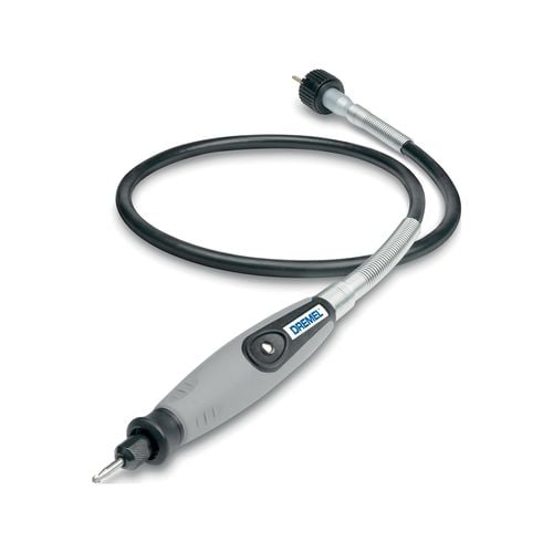

TurboBurbo Legacy Donating Member 53 Member For: 4y 4m Gender: Male Location: WA Wheatbelt Posted 22/08/23 01:39 PM Posted 22/08/23 01:39 PM How have you gone about splitting the lense from the housing? I was going to have some fun fiddling around with addressable led strips, but the generic diy advice to heat up the whole unit did NOT go well for me.
biddie_fiddler [IMPULSIV3] Legacy Donating Member 1,374 Member For: 7y 4m 1d Gender: Male Location: Perth, WA Posted 13/09/23 11:36 PM Author Posted 13/09/23 11:36 PM Wow got here late I do apologise hahaha Modern car tail lights, say 2000ish and above, are ultrasonic welded together. Its actually a pretty epic process! The housing and the lens are two separate pieces, a machine takes the two pieces, lines them up together and then vibrates the ever living fk out of the two pieces, the friction between the plastic causes so much heat that they are friction welded together, basically becoming one sealed unit. The only way to open tail lights like this is to cut them open. I use a dremel with a flex shaft, and a special cutting disk made for cutting wood I believe. The cutting blade has off centre holes cut out of its cutting surface as you can see above, is helps break up the plastic as you cut. Traditional disks just melt the plastic and makes a mess, with this blade it it really easy to clean. The most widely accepted method used by shops that do this kinda thing though is an ultrasonic cutter. Way easier to use and a way cleaner finish. They are quite expensive though, the best one to get that's not bank breaking is still $600 odd and will still overheat - https://www.micromark.com/Wondercutter You need to spend quite a bit to get a industrial type one that is built for long time use and will last. 1
