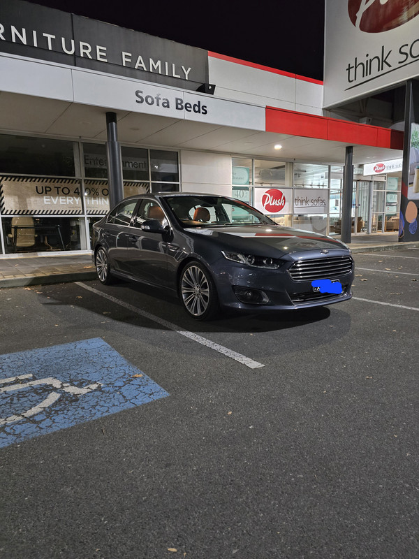

JET Performance New Member 7 Member For: 3y 6m 14d Posted 24/07/24 09:36 AM Posted 24/07/24 09:36 AM (edited) Hi Guys I have a FGX G6E Turbo looking for around the 410rwkw on 98 I'm starting to get quite a few parts together to do it reliably and easily all day everyday. My question is re turbos I know the baby OEM turbo 3576 is only good for 315 to 330rwk on 98 so that won't get me there. I want to stick with 98 pump. So will a GTX3576R do the job as I love the fast spool of the factory set (I don't drive the car a lot but it comes on around 2.5k and I love that). A seller on Ebay said this Option 2 GTX3576R core with a GTX3576R front housing. These still spool fast but make more overall power. The inlet is 4in instead of 3in though do you would need a wider inlet hose/pipe. So will option 2 achieve my 400+ rwkw on 98 looking for around 410rwkw a even 550rwhp Or will I have to go for example Pulsar 3582 and live with it being a decent about more laggy than the 3756? Pics for attn as this is a great forum with lots of great info but the forum hay days are long gone sadly! Edited 24/07/24 09:40 AM by JET Performance

Tom Tucker Legacy Donating Member 711 Member For: 7y 2m 7d Posted 24/07/24 11:13 PM Posted 24/07/24 11:13 PM Beautiful looking car mate. And well articulated post. I don't think either of those options will get you 400rwkw on 98. You probably need a GTX3584RS or the like. But you'll lose spool. The G35-900 flows very well at modest boost as well, and that spools very well, but more expensive.
