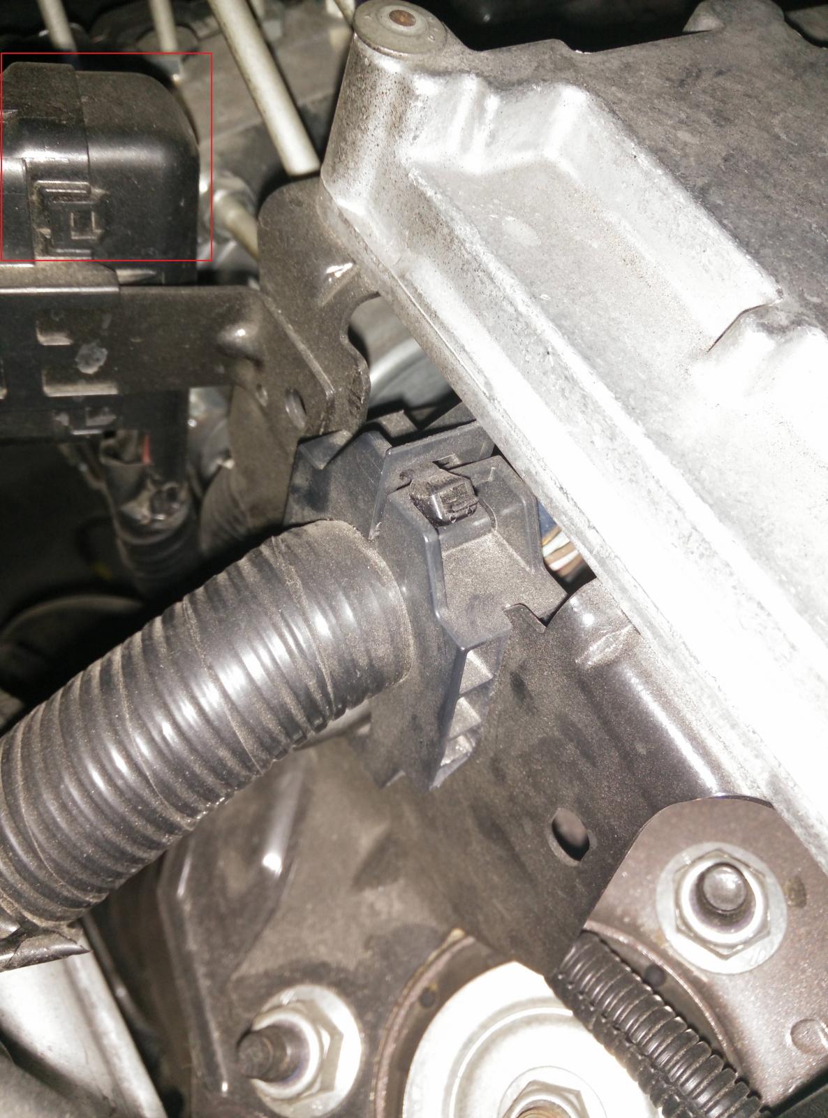

Ralph Wiggum Moar Powar Babeh Legacy Donating Member 19,334 Member For: 20y 9m 21d Gender: Male Location: Perth Posted 09/02/15 08:04 AM Posted 09/02/15 08:04 AM There is a lock lever on the plug with a secondary retaining lock.Released them and the lever pushes the plug apart.
GeGe6 Legacy Donating Member 1,980 Member For: 14y 7d Gender: Male Location: Perth, SOR Posted 09/02/15 09:06 AM Posted 09/02/15 09:06 AM (edited) Marco, my clip was broken, making it difficult to remove harness.So had to remove ECU to release harness.Did you get some conduit to protect the wire or did you just run relay wire?Reason I ask is you might pick up electrical interference.The unit has an adjustment for it but can effect shift RPM indicator if set to high. Edited 09/02/15 09:10 AM by GeGe6

masda74 To Loud Legacy Donating Member 4,114 Member For: 14y 7m 14d Gender: Male Location: WA, Perth Posted 09/02/15 10:01 AM Posted 09/02/15 10:01 AM So Mick, is that why you ran the conduit. To stop interference? I thought you ran conduit to keep the new wire with the rest of the wires running to the ecu(effectively keeping it neat).Looks like someone may have been at my ECU already?Cable ties?This is the back view. No clips.I am going to assume that the cable tie needs to come off. Then said clip will be accessible.If I get coilovers in future, will the ECU need to come off?
GeGe6 Legacy Donating Member 1,980 Member For: 14y 7d Gender: Male Location: Perth, SOR Posted 09/02/15 10:07 AM Posted 09/02/15 10:07 AM Mine had cable tie also on that support collar.Have you tried to release the harness from under the ECU?Yes that's the reason I ran that small conduit, and to make it neat.
Ralph Wiggum Moar Powar Babeh Legacy Donating Member 19,334 Member For: 20y 9m 21d Gender: Male Location: Perth Posted 09/02/15 10:20 AM Posted 09/02/15 10:20 AM Marco,all the connections you need to make for a shift light/tach driver are located in the plug marked red in the attached. You don't need to remove the ECU for coil overs. 1
masda74 To Loud Legacy Donating Member 4,114 Member For: 14y 7m 14d Gender: Male Location: WA, Perth Posted 09/02/15 10:24 AM Posted 09/02/15 10:24 AM Thanks for that Luke. I would have ripped the wrong plug out.
