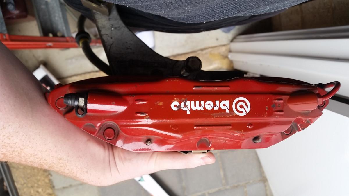

RB Snake Legacy Donating Member 327 Member For: 12y 6m 29d Gender: Male Location: Perth SOR Posted 06/04/15 06:27 AM Posted 06/04/15 06:27 AM Here's a better picture of the calipers. It has a few chips. Will have to think about re-painting them, my car is black on black, so the calipers will stand out.
masda74 To Loud Legacy Donating Member 4,114 Member For: 14y 7m 20d Gender: Male Location: WA, Perth Posted 06/04/15 06:31 AM Posted 06/04/15 06:31 AM But isn't that what you want? Have them stand out. I reckon it is best to keep them red.Get the clear coat sorted and you laughing.
PhilMeUp Member 1,045 Member For: 18y 4d Gender: Male Location: Perth, Western Australia Posted 06/04/15 07:31 AM Posted 06/04/15 07:31 AM (edited) The cheapest way to go is to get them powder coated. I had some done at Aeroplate in Welshpool - next to Perth Brake Parts. I pulled mine to pieces and paid $50 per caliper for powder coating. The bolts must have been acid dipped, because they came back looking like brand new. The price that I got for painting was $175 per caliper.If repainting/powder coating then the first step is to measure and order replacement Brembo decais. These are common on eBay and various web sites.Disassemble everything. Pretty sure that it's an 8mm allen key for the bolts.Take sh*tloads of photos so that you can remember what goes where.Seals: Should be ok. Be extra careful with removing the seals and dust boots. They are expensive to replace. Don't even bother with local pricing, it's straight to the US for that one. Removing seals: You need to push the pistons out - can get tricky without an air compressor. Maybe try and find a servo with one of the older style tyre inflators?Drop all four disks off at Marfleet in East Perth for Nick to check and machine if necessary.Brake pads: People will debate this forever. I'm a fan of the Hawk Performance ceramic pads. The part number for the 4 piston fronts is HB193Z.670 http://www.hawkperformance.com/performance-street/pads/hb193z670Rear pads: Dunno. Anyone got any suggestions?Braided brake lines: Talk to Matt at Race Brakes Sydney. He's also a fan of the Hawk ceramic pads, so he'll be able to explain why they're so good.Speed Bleeders: They make it easy to flush and bleed brakes on your own at home. The Brembo calipers use a SB1010S (also known as a SB1010S). The rear PBR calipers use a SB1010 (also known as a 639560). Order them on Amazon.com Edited 06/04/15 07:37 AM by PhilMeUp 1
