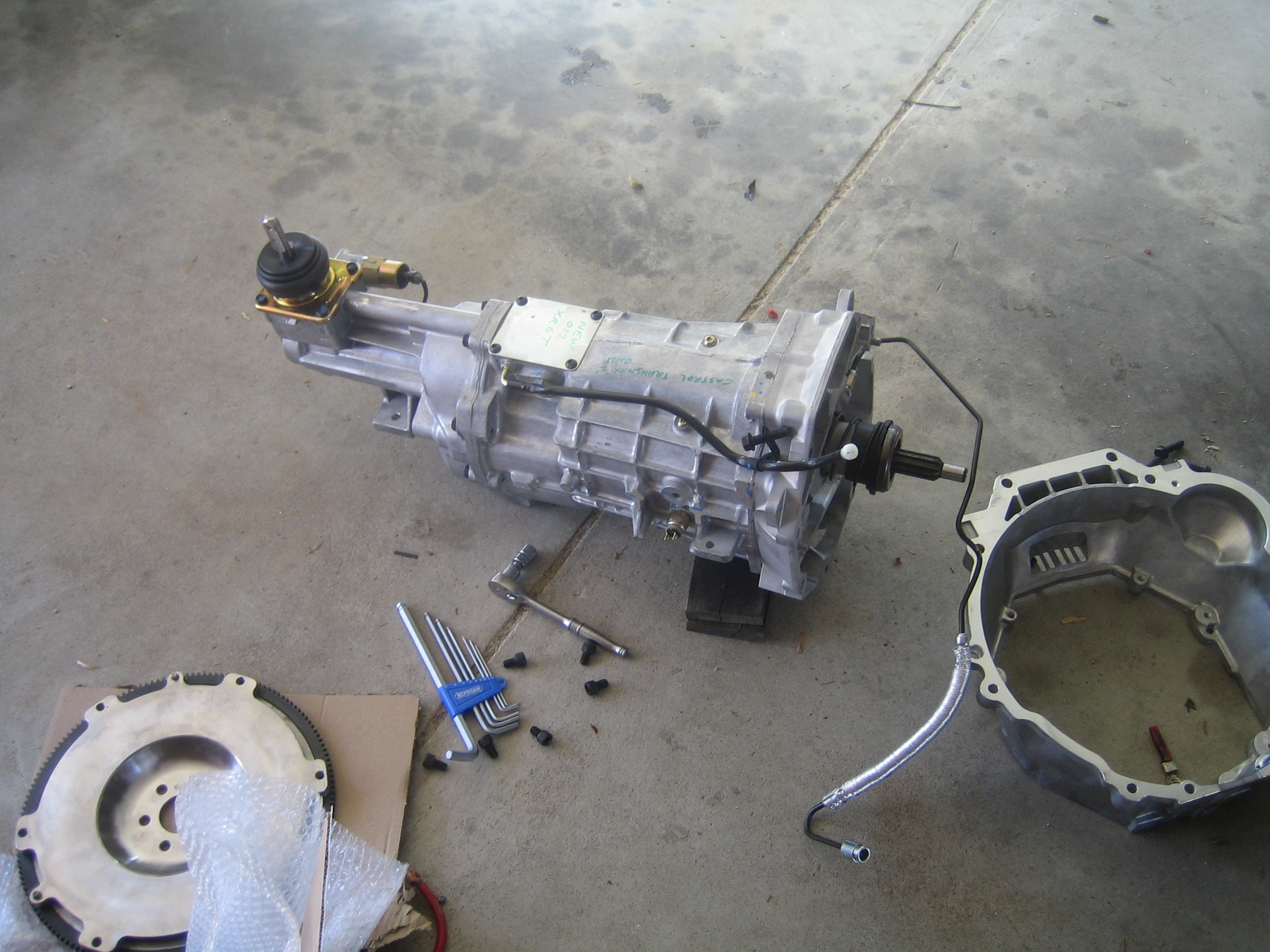

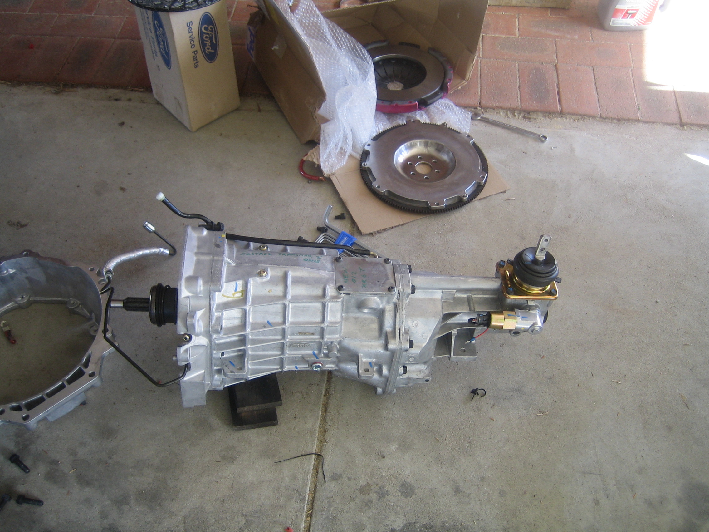

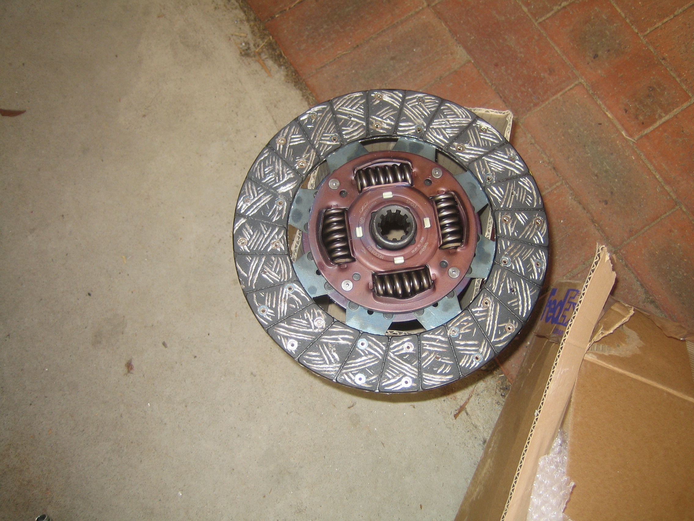

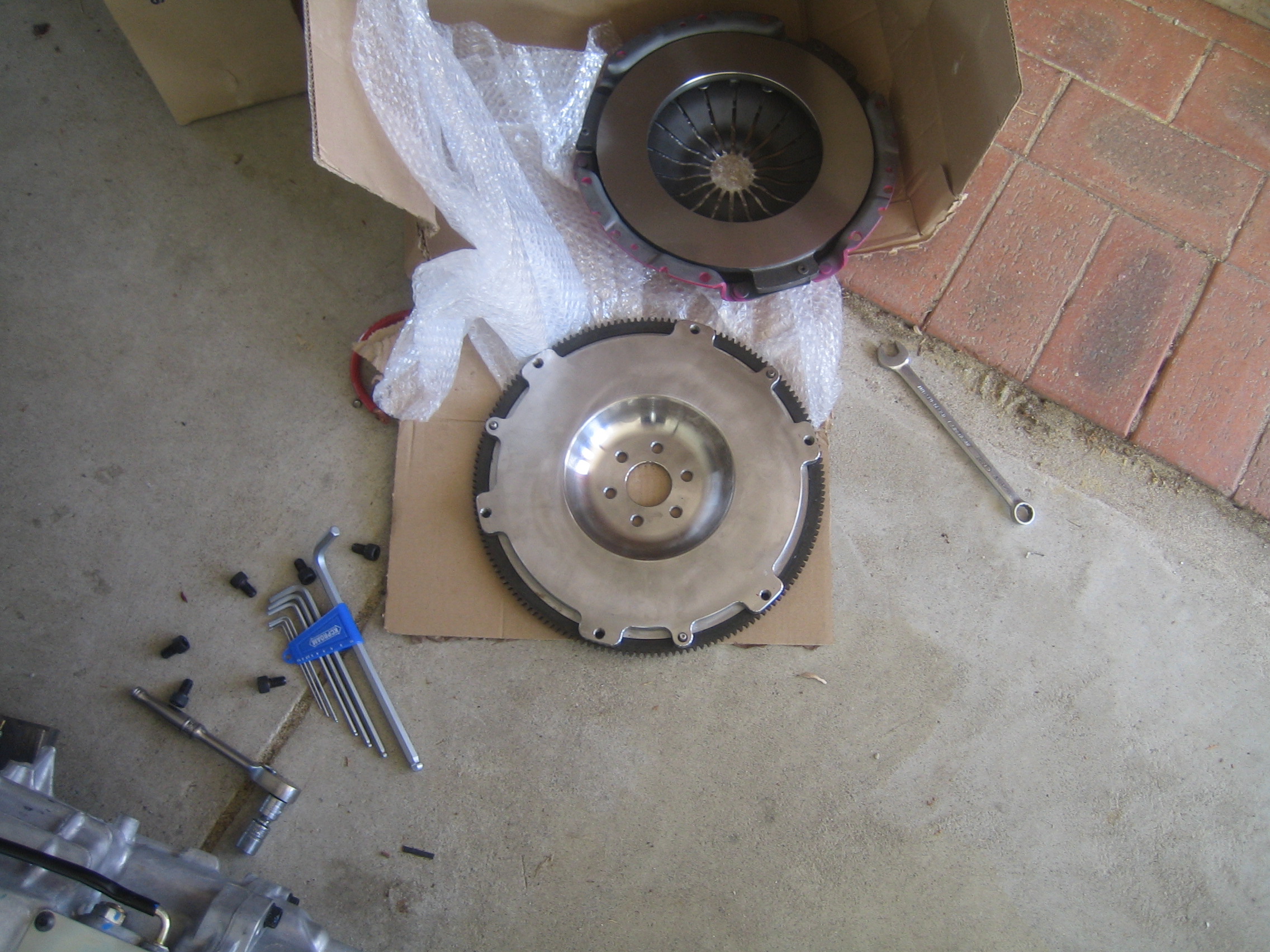

Ralph Wiggum Moar Powar Babeh Legacy Donating Member 19,334 Member For: 20y 9m 26d Gender: Male Location: Perth Posted 17/05/06 04:16 PM Author Posted 17/05/06 04:16 PM Some pics of the box,flywheel and clutch before they went in...
Ninka Legacy Donating Member 1,850 Member For: 23y 6m 25d Gender: Male Location: Perth, WA Posted 17/05/06 10:29 PM Posted 17/05/06 10:29 PM Some pics of the box,flywheel and clutch before they went in... ←Looks great I bet you are itching to get on the road to try her out
