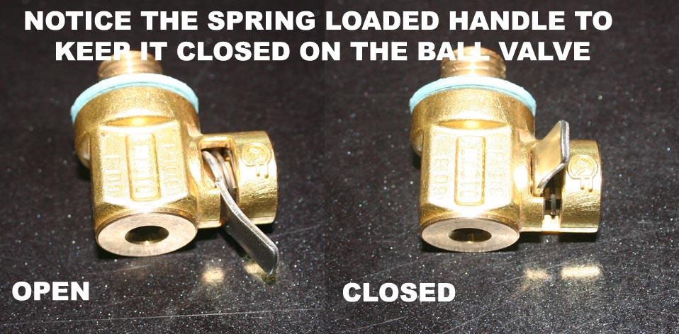

SILK RSPEC Legacy Donating Member 193 Member For: 18y 9m 5d Gender: Male Location: Brisbane Southside Posted 08/07/08 06:59 AM Posted 08/07/08 06:59 AM Hi guy's,I just went and bought a fumoto drain valve for the falcon and thought I would let everyone know about them.I have used them on my subi's they are great!!!You can buy these draina plugs with or without a nipple on them, the nipple is good when the sump is in a hard to reach place as you can add a hose. they are basically as ball valve which goes into your sump plug hole. they make it easy to drop the oil and you can do it when the oil is still warm which makes it real easy to do oil changes. the valve also is spring loaded so you can't accidently open the valve. makes oil changing real easy.They have 30% off at the moment so thay are only $33 each plus $7 for postage.there web site is www.fumoto.com.au

SILK RSPEC Legacy Donating Member 193 Member For: 18y 9m 5d Gender: Male Location: Brisbane Southside Posted 09/07/08 06:59 AM Author Posted 09/07/08 06:59 AM (edited) Some more photo's as they came in the mail today express post.It is basically a ballvalve with a spring loaded valve to hold it closed so it can't easily get bumped open. This is the one without the nipple the nipple one has a nipplr on the bottom of it. Apparently in europe some of the places fit nipple plugs so they can suck the oil out at the mechanics shop with a special air compressor tool to make oil changes really fast. All I know is once you fit one you never want to change oil the old way again. Edited 09/07/08 07:02 AM by SILK RSPEC
