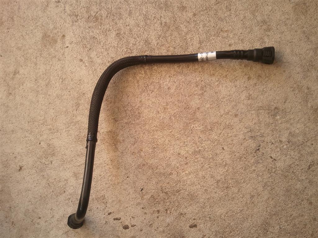

Kingers. Member 227 Member For: 16y 5m 3d Posted 18/03/11 09:56 AM Posted 18/03/11 09:56 AM Ok finally found away to get the suckers off haha I used 4 flatblade screwdrivers, small ones. I used them on the inside of the connector and gentally lifted all 4 of the locking tabs and it slid off very easily seems a lot easier this way. I recommend people who are having trouble toGive this a go. You should be able to see all the tabs that clip over that need to be lifted
locknut Member 26 Member For: 16y 10m 8d Gender: Male Location: Canberra, ACT Posted 18/04/11 01:30 PM Posted 18/04/11 01:30 PM Strongly advise against this, as you can damage the tabs. Admittedly I've had a couple of issues with the submersible line being too long, and pushin the cap up etc.. and have had to take the pump out a couple of times. I was using drivers, and being carefull, but the claw-lip on these tabs that hold on to the rib of the male fitting can be damaged easily, and the supply line can blow off; which is what happened to me last week. I had to replace the line with a new supply line:Just slide the fitting forward, then slide the tabs back, and the fitting will come off with ease.Mine is leaking, and people are saying there's a seal, but no pics. I fit the module into the tank, and put the black metal ring on top, 6 bolts. I don't have any rubber seal?
