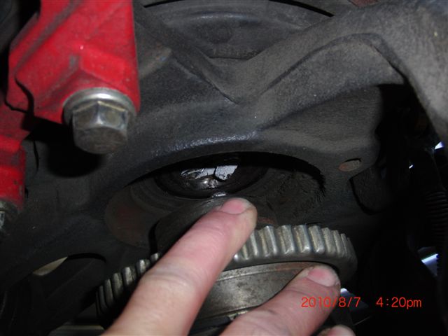

Forcedfed6 Legacy Donating Member 54 Member For: 20y 6m 26d Gender: Male Location: Toowoomba Posted 08/08/10 07:55 AM Posted 08/08/10 07:55 AM Evidence of carnage....

possum Legacy Donating Member 553 Member For: 17y 2m 30d Gender: Male Posted 08/08/10 10:26 AM Posted 08/08/10 10:26 AM so it broke at the snout in the hub? I havent seen a falcon break one yet, is that the common place they break?
SPIKO Legacy Donating Member 1,924 Member For: 21y 4m 15d Gender: Male Posted 08/08/10 10:35 AM Author Posted 08/08/10 10:35 AM Bad luck Spiro. As you strengthen each component in the drivetrain you find the next weakest link.What was once strong may no longer be strong enough.Your persistence is admirable.Good luck.BrianCheers Brian, thanks for the support Buddy, you know what It's all about mate first hand time for a 9 inch??Mmmmmmmmmmm Damned if I do Damned if I don't really Bad luck mate and good to meet you again.When your car came up to the line, we all stood up in the stands with cameras at the ready... We were all devastated about the end result..I'm sure you will get there!Best of luck and I will be there again to see your next run.CheersBenAs stated on the day Ben Humble apologies mate the last thing on my mind was letting anyone down LOL, what can say hopefully next time round so it broke at the snout in the hub? I havent seen a falcon break one yet, is that the common place they break?Cheers Possum, yes that's right I have been known to do things a little differently LOL
SPIKO Legacy Donating Member 1,924 Member For: 21y 4m 15d Gender: Male Posted 08/08/10 10:37 AM Author Posted 08/08/10 10:37 AM Evidence of carnage....I run 31-28 spline billet shafts Lad's, that's actually the 28inch end, was the last thing I was expecting to break FFS......
