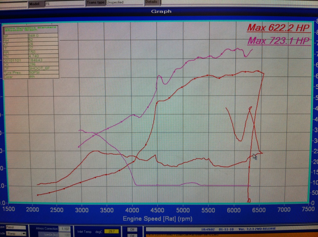

SPIKO Legacy Donating Member 1,924 Member For: 21y 3m 30d Gender: Male Posted 01/11/10 09:45 PM Author Posted 01/11/10 09:45 PM As you will all be able to ascertain with the graph below, initial pump fuel tuning has commenced yesterday, however it is far from optimal as yet... Jamie FPT & 6Boost also have business's to run so it is not possible to just drop everything else and spend countless hours just tuning the old girl Jamie spent a couple of hours yesterday just on the idle , new injector scaling etc. basically a complete tune from scratch is required. The two test pulls below are on Bp98 and far from optimum afr's, finalising the pump tune & the beginning of the race tune should happen by the end of today
DUS12 Member 471 Member For: 19y 1m 1d Posted 01/11/10 10:58 PM Posted 01/11/10 10:58 PM that's off the scale rich, must have bugger all boost in it more revvs
Buf-Phoon loitering with intent Legacy Donating Member 13,318 Member For: 22y 11m 18d Gender: Male Location: Zombie Birdhouse Posted 01/11/10 11:27 PM Posted 01/11/10 11:27 PM timing ?

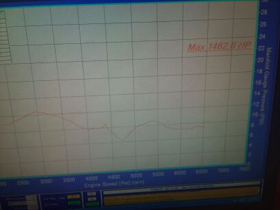

SPIKO Legacy Donating Member 1,924 Member For: 21y 3m 30d Gender: Male Posted 02/11/10 11:06 AM Author Posted 02/11/10 11:06 AM I have just returned from a marathon of tuning afternoon We had evil demons visit once again with some software issues becoming apparent on Jamie's dyno, it was a simple fix however every technician in Dyno dynamics who was capable of dialing in remotely was at the Melbourne cup FFS So off we went again to MTQ dyno too see if we could register a reading on race fuel this again was to prove non effective as we struggled to get a reading with the Pzero's frying and doing all sorts of funny stuff no result again The highlight of my day would have been the drive from Jamie's workshop to MTQ Words are ineffective to describe the shear animal instinct of the the new rear end and Detroit locker, pure raw power... The 285,s didn't stand a chance.We did however register one reading (Below) early that I was kind enough to send to Daniel (Bev) I will let him elaborate further..
