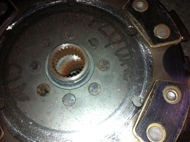

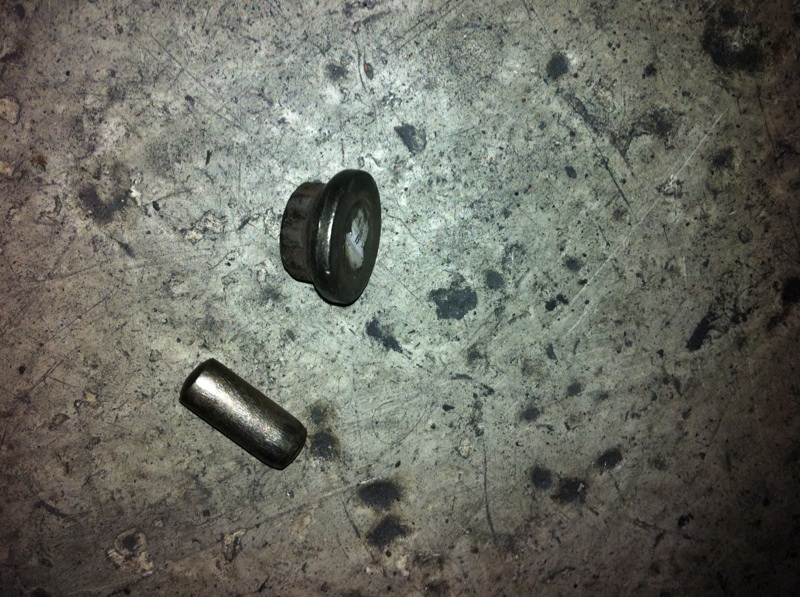

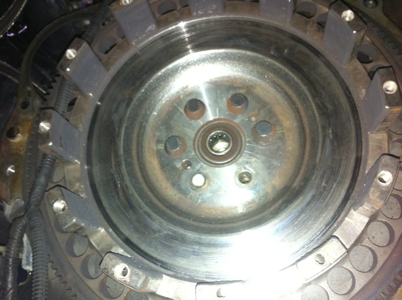

SPIKO Legacy Donating Member 1,924 Member For: 21y 3m 26d Gender: Male Posted 11/01/11 01:50 AM Author Posted 11/01/11 01:50 AM (edited) Well after an interesting drive from Brisbane to Sydney before Christmas in street trim and a measly 750+++rwhp, rain traffic etc, I experienced some issues just after half way it was becoming more & more difficult to engage the gears as I progressed. I managed to reach my destination without major drama's however after further investigation the next morning at my old hang out C & V performance it was made apparent that I had snapped an arp bolt head of the flywheel that jammed itself between the clutch plates, keep in mind that my flywheel is also dowled to the crank An action plan is in place and further resolve from Mal Woods, C&V & pics will be forthcoming shortly, I had to leave the old girl in their care and return to Brissy awaiting a resolution... Edited 11/01/11 01:55 AM by SPIKO

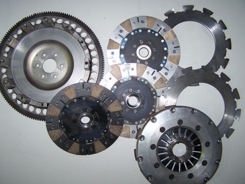

SPIKO Legacy Donating Member 1,924 Member For: 21y 3m 26d Gender: Male Posted 14/01/11 12:51 AM Author Posted 14/01/11 12:51 AM (edited) The damage The resolution (Prototype Mal Wood Tripple Currently In Testing) Edited 14/01/11 12:53 AM by SPIKO
