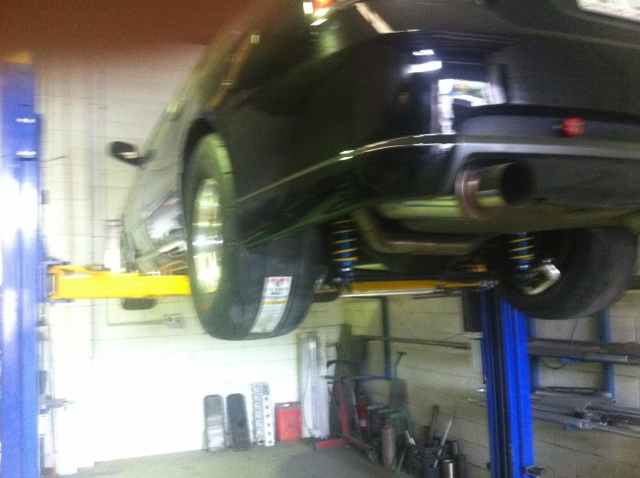

SPIKO Legacy Donating Member 1,924 Member For: 21y 4m 30d Gender: Male Posted 24/06/12 08:39 AM Author Posted 24/06/12 08:39 AM (edited) Hey Jet, as of today Motec is the only ecu that you can buy the feature for running the ford fly by wire throttle body correctly through the motec alone no piggy back option. Haltech I am aware are working on something similar right now but it isn't available as yet to the masses currently testing, that is why DLM haltech plug in looms are only on offer for cable TBA as yet.My vehicle would be the most exstensively modified Motec systems thus far but there are others that we're done more simply before mine like Brian BCL and Menace Jay that are members here. My instal is being done by Phil Laird Graphic Skills Racing and he is the guy in the photo above.. Edited 24/06/12 08:50 AM by SPIKO
