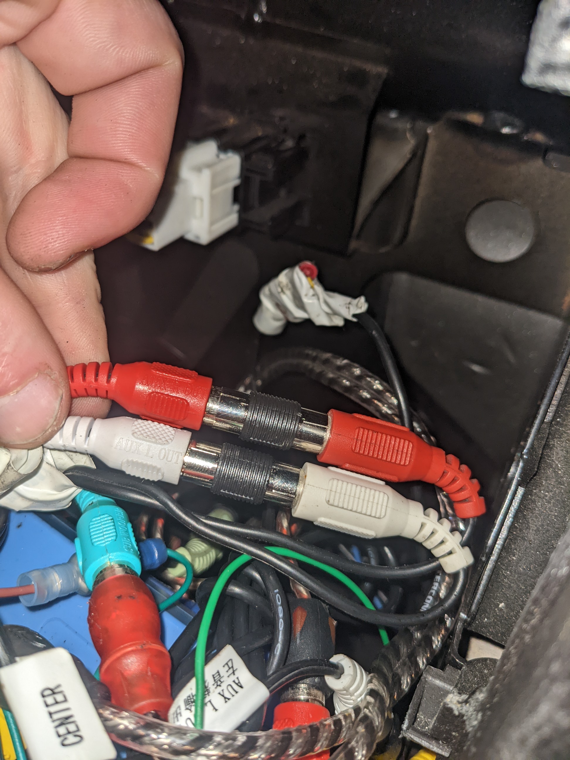

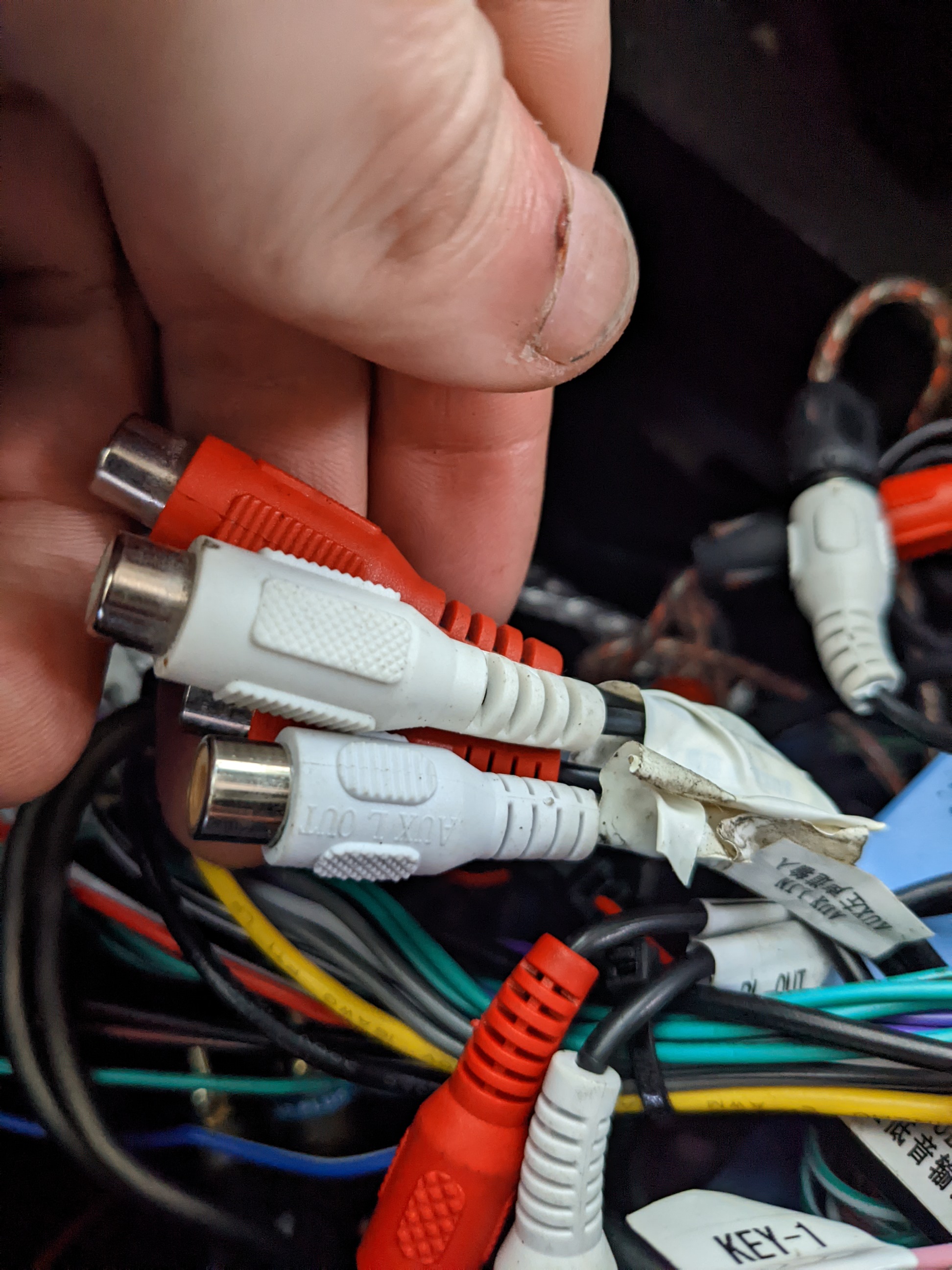

k31th less WHY; more WOT Site Developer 30,020 Member For: 18y 3m 18d Gender: Male Location: Melbourne Posted 12/09/22 02:21 AM Posted 12/09/22 02:21 AM Fixed up this problem... With these -> https://www.fordxr6turbo.com/forum/topic/81090-cool-stuff-you-just-bought/?do=findComment&comment=1714414 The problem was that the aftermarket ICC has a female RCA cable and my 3.5mm audio "aux" cable is male on both ends and the only adapter I had at the time of install was a female 3.5mm audio to female RCA, so I only had a full-length (5m) male-to-male spare RCA cable to put there which caused a shocking "whine" interference in the audio output, so I took it out and purchased the above to repair it. Much better now campaigners can plug their phones etc into my ICC to play music again, woo... also no sign of the audio interference 1

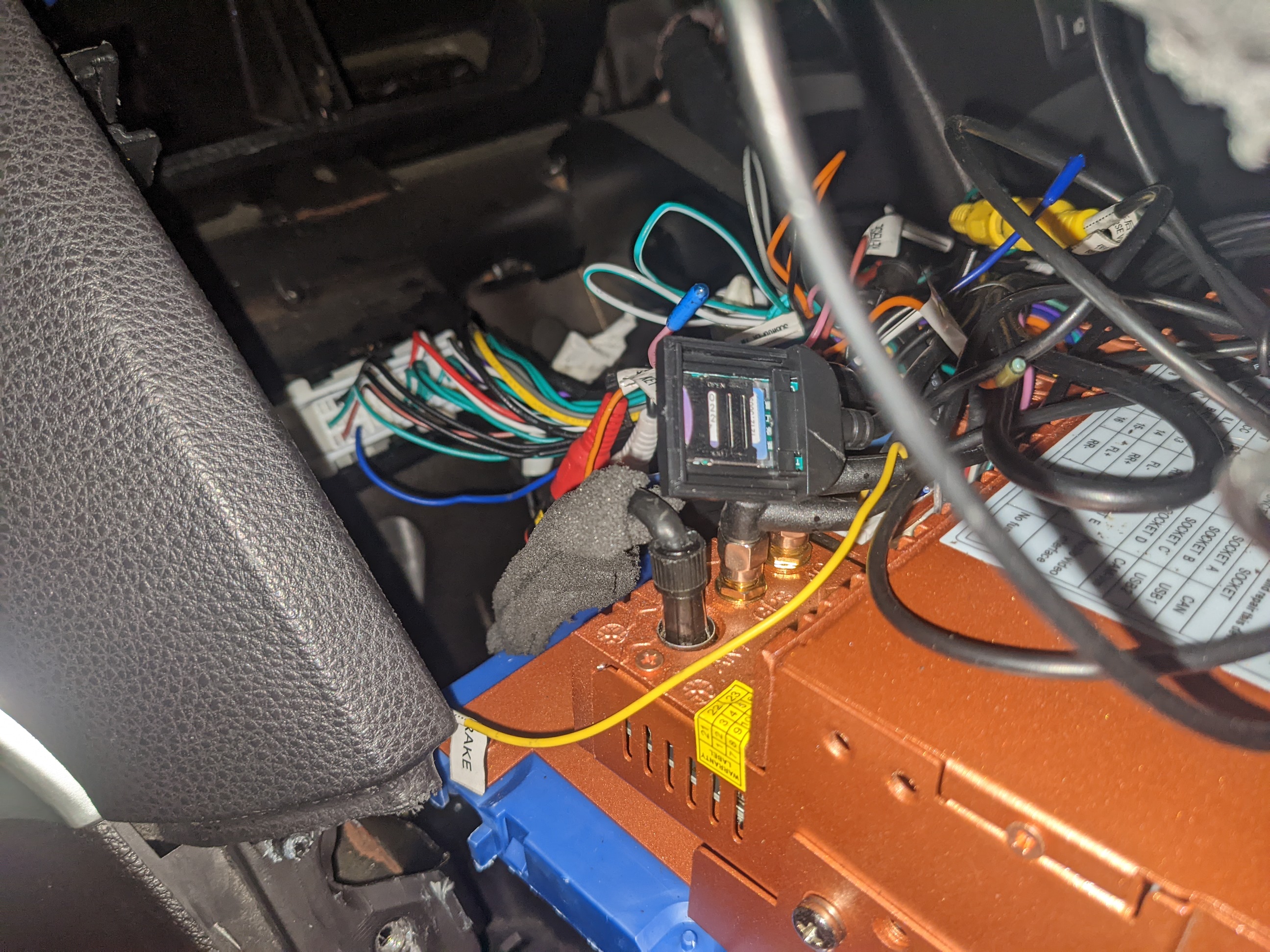

k31th less WHY; more WOT Site Developer 30,020 Member For: 18y 3m 18d Gender: Male Location: Melbourne Posted 13/09/22 10:38 PM Posted 13/09/22 10:38 PM while I was doing the above, I put a data-share-SIM card in, too So nice to have mobile data in the car and not have to use my mobile phone hotspot to use the exact same data plan
biddie_fiddler [IMPULSIV3] Legacy Donating Member 1,374 Member For: 7y 3m 29d Gender: Male Location: Perth, WA Posted 14/09/22 12:16 AM Posted 14/09/22 12:16 AM that's awesome @k31th!! How is the GPS holding up? My only annoyance with the kayhan head unit I have is that the GPS can take a long time to find satellites. I.e. it takes a while to find my location. Has this been an issue for you at all? On that topic, where did you mount the GPS antenna? That could play a role with my issue as mine is just under the ICC top hat
k31th less WHY; more WOT Site Developer 30,020 Member For: 18y 3m 18d Gender: Male Location: Melbourne Posted 14/09/22 12:22 AM Posted 14/09/22 12:22 AM GPS is perfect. I took their advice of mounting the antenna right at the top of the unit so it's underneath that "triangular" top piece. Even the mobile data antenna is underneath the same top piece and they both work great 1
