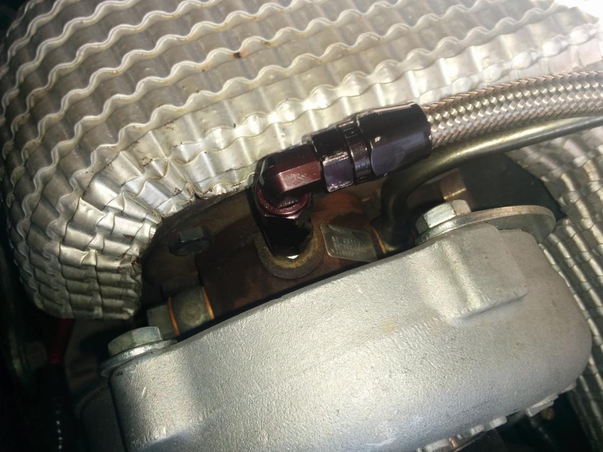

Ralph Wiggum Moar Powar Babeh Legacy Donating Member 19,334 Member For: 20y 10m 8d Gender: Male Location: Perth Posted 03/12/14 11:15 AM Posted 03/12/14 11:15 AM Removed the newly installed turbo feed line from the turbo, fitted a 25mm - 4an male/female extender and refitted the turbo feed line. A slightly larger air gap between the exhaust housing and feed line can only be a good thing. Plus it makes it much easier to remove the feed line if need be.

Ralph Wiggum Moar Powar Babeh Legacy Donating Member 19,334 Member For: 20y 10m 8d Gender: Male Location: Perth Posted 03/12/14 11:44 AM Posted 03/12/14 11:44 AM Not the easiest item to photograph but you get the idea. 1
