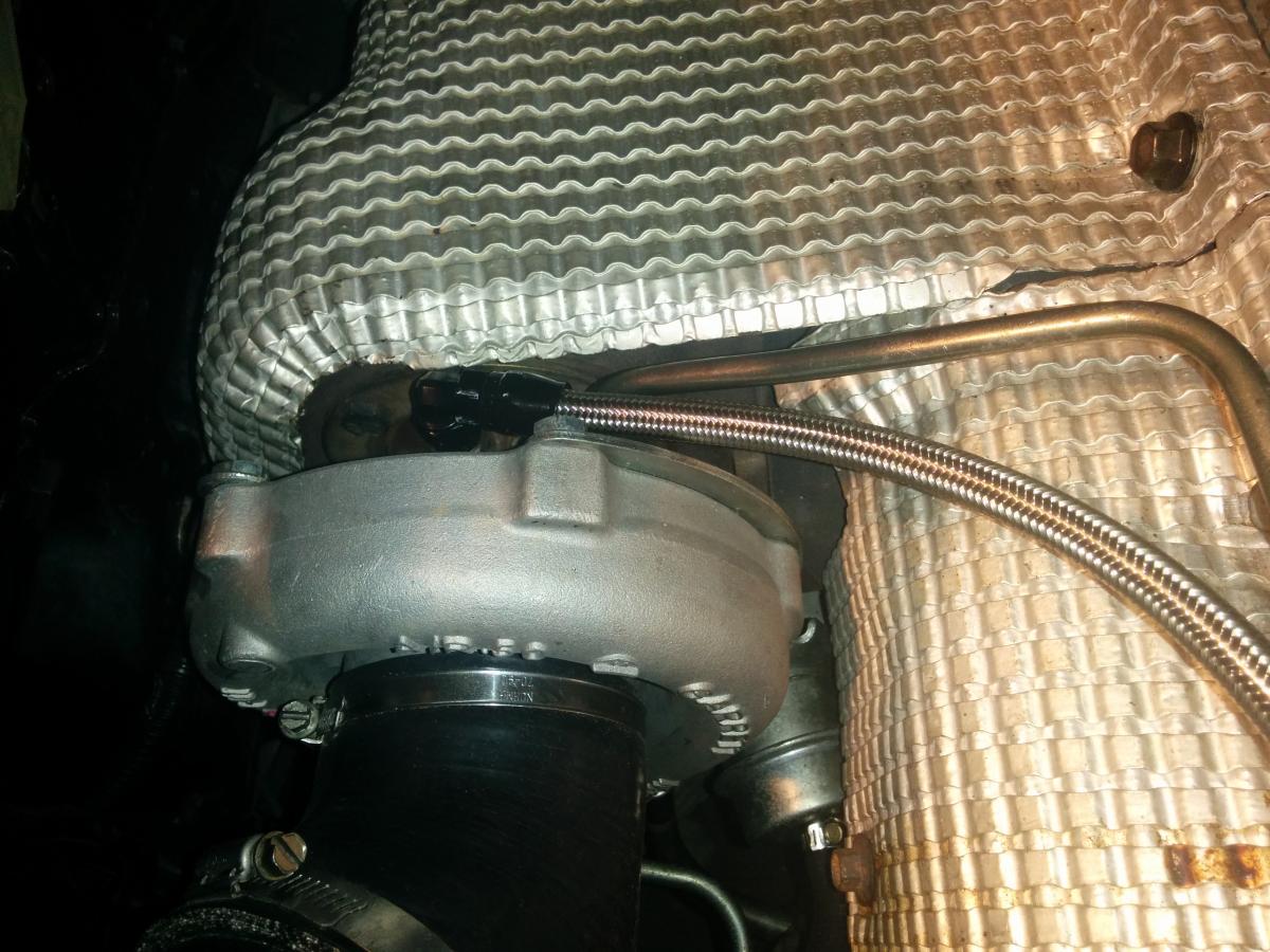

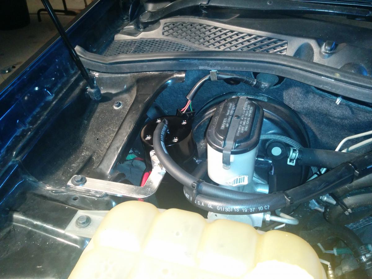

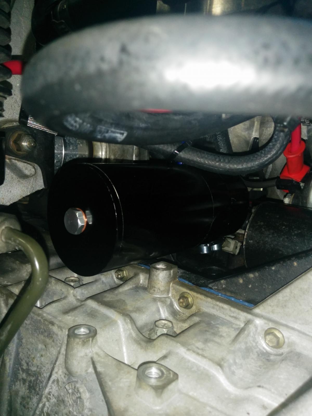

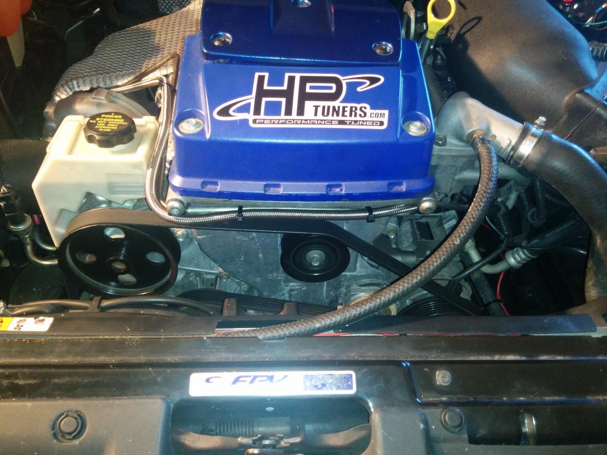

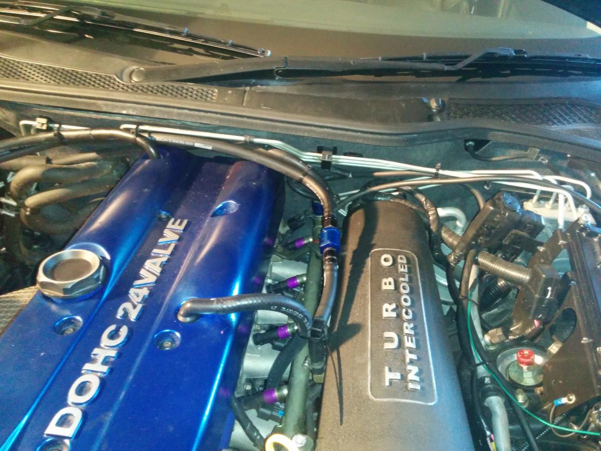

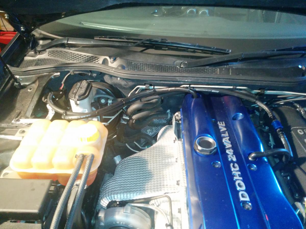

Ralph Wiggum Moar Powar Babeh Legacy Donating Member 19,334 Member For: 20y 10m 7d Gender: Male Location: Perth Posted 22/11/14 09:22 AM Posted 22/11/14 09:22 AM Gave the old girl a service, new engine oil and filter. Have gone back to 5w30 and it has calmed the song of the mahle's down considerably so that's a win. Also made up and installed a new turbo oil feed line to replace the leaky pos that was on there. #nofilter.Just need to sort out some billet clamps next week. Also installed the new pcv and crankcase vent catch cans. Just waiting for the spare bracket to mounting bracket to finish drying so it's black for extra stealth. The crankcase vent is vented to atmosphere at the moment, just need to weld a -6 an bung to the turbo intake pipe. I'll see how much oil collects in it and then decide if I want to leave it atmo or plumb it back. I really should have done sfa as I was feeling crook yesterday and after spending a couple of hours in the workshop I now feel like death. 2

RB Snake Legacy Donating Member 327 Member For: 12y 7m 9d Gender: Male Location: Perth SOR Posted 22/11/14 01:11 PM Posted 22/11/14 01:11 PM Ralph, did the catch cans come with everything needed? I haven't installed mine yet because I'm waiting till I do a turbo side intake, I just need to get some black hose.

Ralph Wiggum Moar Powar Babeh Legacy Donating Member 19,334 Member For: 20y 10m 7d Gender: Male Location: Perth Posted 22/11/14 01:34 PM Posted 22/11/14 01:34 PM Ralph, did the catch cans come with everything needed? I haven't installed mine yet because I'm waiting till I do a turbo side intake, I just need to get some black hose.Yeah mate, everything bar some decent hose. The only issue I have with them is the 1/8npt ports. The stock lines are all essentially 10mm or 3/8 in the old money so I may drill and tap mine out to 3/8npt in the future. If when you got to install them and the port orientation is not correct you can remove the four hex head screws and rotate the port on the body in relation to the mount points. Just remember to move the deflector plate so the port is aimed at it.
