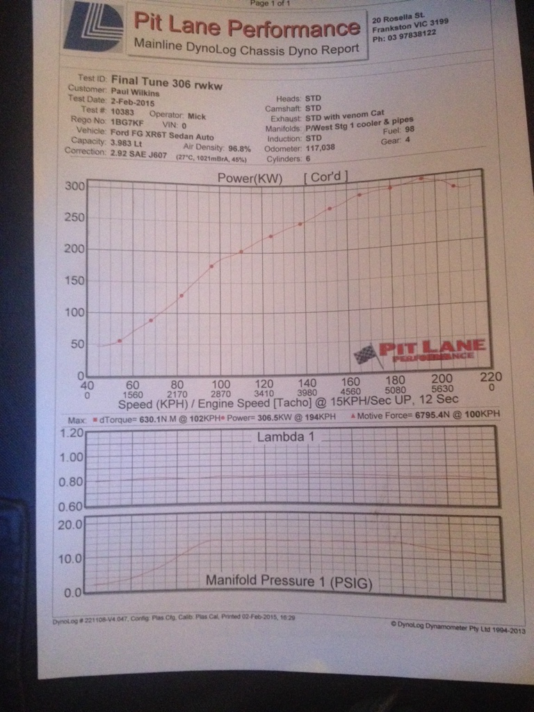

Wilko16 Legacy Donating Member 1,672 Member For: 18y 8m 14d Gender: Male Location: Melbourne Posted 23/02/15 03:41 AM Posted 23/02/15 03:41 AM (edited) Wilko, did you change your cat?From what I know of the FG exhaust, the cat is really the only restriction in the turbo models, until of course you change the turbocharger Yeah mine has a venom cat, running 14psi till the end Ratter explained to me that the stock exhaust is good, but it still causes back pressure and can then start to effect the valves (as I still have stock springs) He said valve spring upgrade would be able to get more power or put a more free flowing exhaust onEvery car is different, mine also has 120,000k's on it Here's a dyno sheet if anyone curious Edited 23/02/15 03:42 AM by Wilko16 2
k31th less WHY; more WOT Site Developer 30,020 Member For: 18y 3m 25d Gender: Male Location: Melbourne Posted 23/02/15 03:55 AM Posted 23/02/15 03:55 AM As usual for Mick, an almost perfect power curve hahaI see that yours didn't even hold 14PSI to the red-line... that's surprising. You're probably right, though, exhaust or valve springs could be holding you back The graph was definitely on it's way to 320+ until about 4600 rpm 1
Mark_Googs Member 95 Member For: 13y 1m 29d Gender: Male Location: Western Suburbs Posted 23/02/15 04:01 AM Posted 23/02/15 04:01 AM nice looking dyno sheet! My dyno sheet seems to have the peak power come on alot earlier than yours does. My torque is around 821nm which is a lot higher as well. Not sure what that has to do with, the tune and other factors to do with the FG I assume.I will try to upload it tonight when I get home

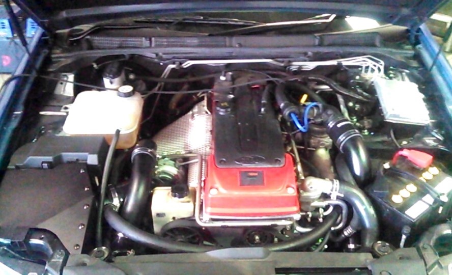

bandblightfoot Member 183 Member For: 13y 7m 2d Gender: Male Location: Gold Coast Posted 23/02/15 05:46 AM Posted 23/02/15 05:46 AM This is mine my turbo looks like it jumps all over the place cant wait for the gtx3582r only couple of weeks now. 1
