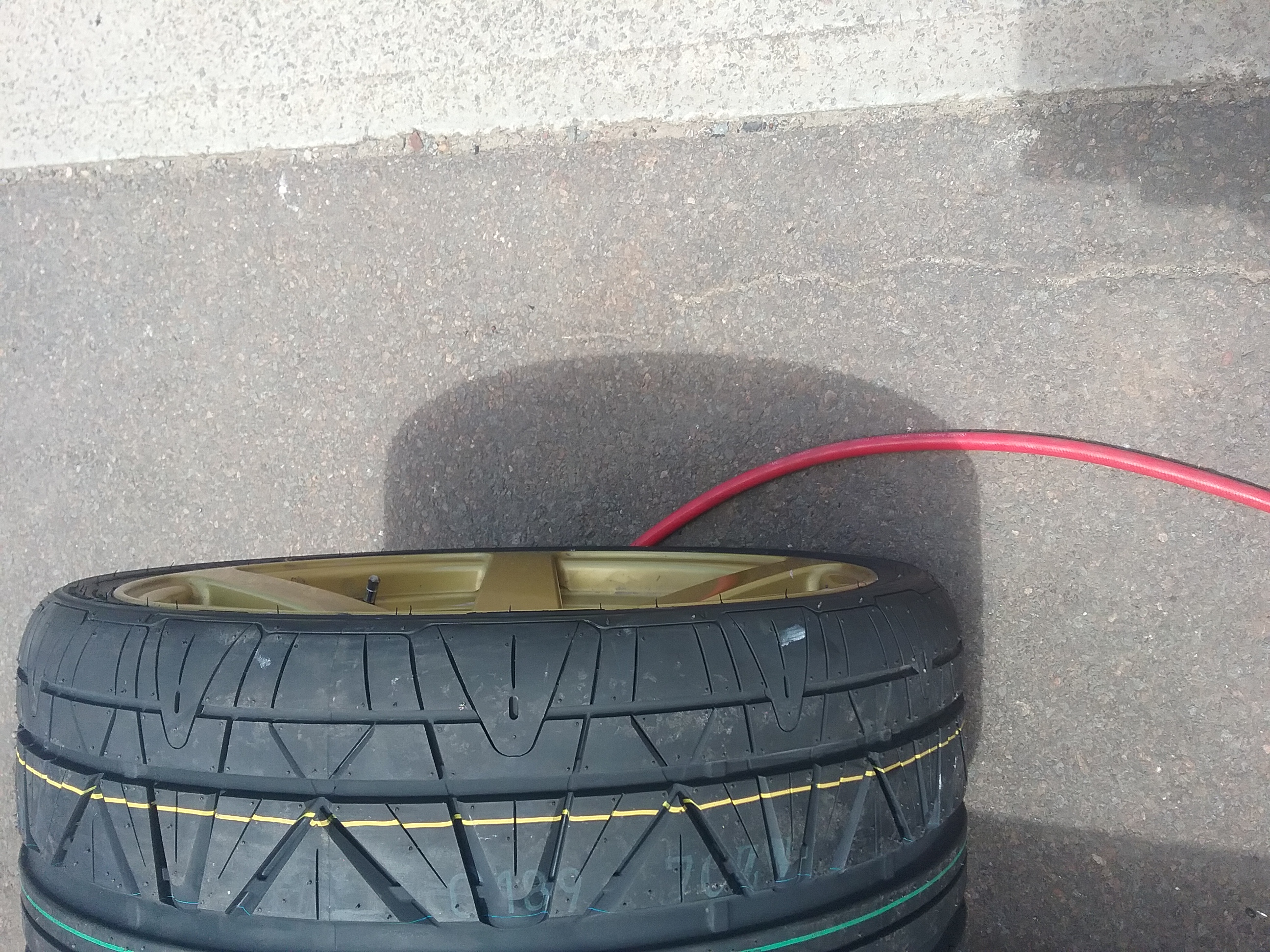

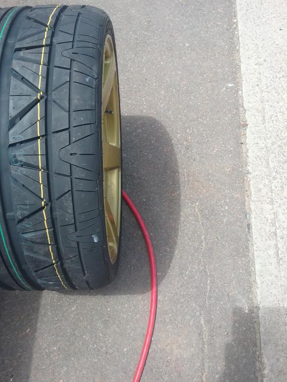

arronm Dropping a turd Legacy Donating Member 9,520 Member For: 18y 9m 13d Gender: Male Location: Perth Posted 16/02/18 02:34 AM Posted 16/02/18 02:34 AM (edited) 14 hours ago, BAXRTUTE said: I dont like streched look at all, my kumho ku31 285s were pretty streched, the invo 305s are flush on my rim atm. Got them for $290 each at St George tyres. U got plenty of room up the back mate. That tyre is way too big for the rim. Outside and inside inch of tread doesn't even touch the road. My 285 invo on a 10 is flat at the edge . More rubber on the road with the smaller tyre FAIL. Edited 16/02/18 02:36 AM by arronm
Puffwagon Legacy Donating Member 16,348 Member For: 11y 6m 11d Gender: Not Telling Posted 16/02/18 03:40 AM Posted 16/02/18 03:40 AM 1 hour ago, arronm said: Outside and inside inch of tread doesn't even touch the road. The same thing happened when I put 255's on the stock mags. Dropping the pressures to about 20 psi helped though but that's only good for going straight.
BAXRTUTE Legacy Donating Member 2,639 Member For: 10y 3m 22d Posted 16/02/18 04:15 AM Posted 16/02/18 04:15 AM 1 hour ago, arronm said: That tyre is way too big for the rim. Outside and inside inch of tread doesn't even touch the road. My 285 invo on a 10 is flat at the edge . More rubber on the road with the smaller tyre FAIL. Yeah right, Well considering its literally 2mm max past the rim edge and the contact patch of the tyre is pretty much all the way across id say your wrong. Ohh and tyre not mounted has the exact rounding on the edges.
Puffwagon Legacy Donating Member 16,348 Member For: 11y 6m 11d Gender: Not Telling Posted 16/02/18 04:22 AM Posted 16/02/18 04:22 AM One way to check is to roll it through water when it is at correct pressure and mounted on the vehicle.
BAXRTUTE Legacy Donating Member 2,639 Member For: 10y 3m 22d Posted 16/02/18 04:24 AM Posted 16/02/18 04:24 AM Pressure at 38 atm, 25 sidewall is chit

arronm Dropping a turd Legacy Donating Member 9,520 Member For: 18y 9m 13d Gender: Male Location: Perth Posted 16/02/18 04:37 AM Posted 16/02/18 04:37 AM Min manufacturer rim size for that tyre is 10.5. Recommended 11 FAIL and possibly illegal.
