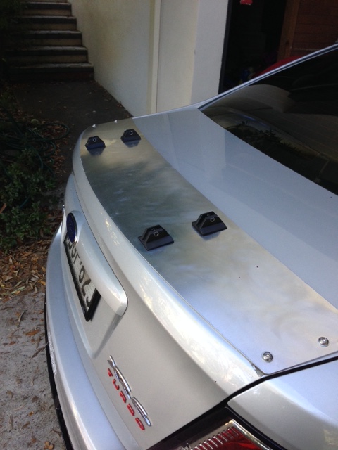

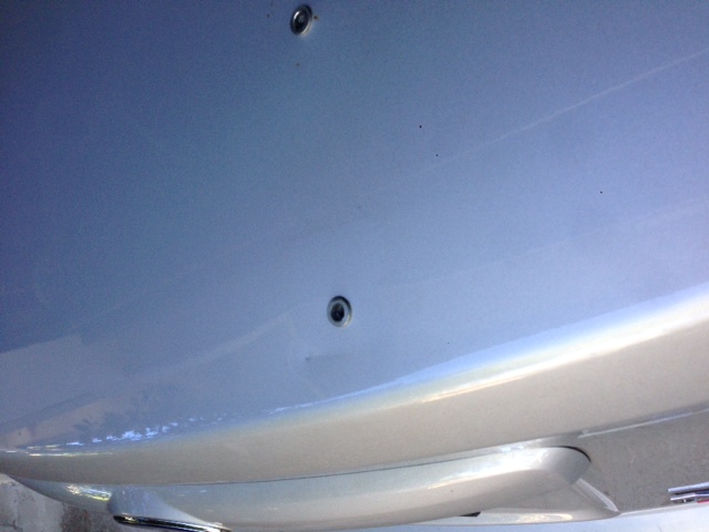

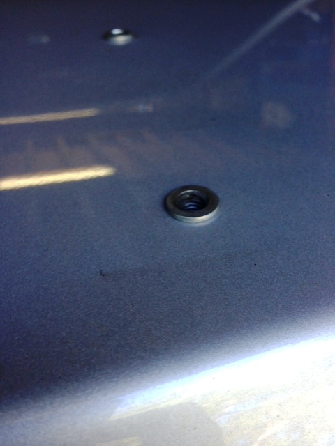

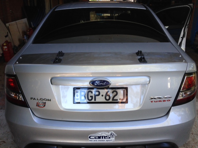

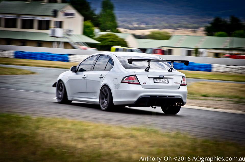

nelsonian101 Legacy Donating Member 961 Member For: 18y 24d Gender: Male Location: Sydney Posted 13/05/16 07:36 AM Author Posted 13/05/16 07:36 AM On Thursday, May 05, 2016 at 8:52 PM, k31th said: gotta say, I thought the big rear wing would look average... but it looks frickin' sweet on your car seriously, though... dents in the boot? pics? Putting the wing on tomorrow before the drive down to Wakefield (trackday Sunday) Can see the downforce dents from last time. Have added a base plate to even the load. Inside of boot has aluminium plates added too. For the record, I don't drive the car around like this every day. Try and avoid looking like an idiot. 99% of the time it looks like every other FGXR6T, unless you look very closely. 3
