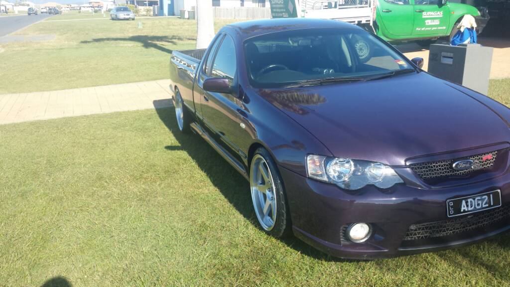

Regular readers will be familiar with my previous Tornado build thread. I bought a very untidy 2006 BF FPV Tornado at auction and went to work on cleaning it up.
http://www.fordxr6turbo.com/forum/topic/89684-2006-fpv-tornado-f6-ute-cleanup-resurrection/
Some history - the timeline:
July 2014: Bought a crash-damaged 2005 BA XR6 Turbo ute and got it licenced in September. Figured I’d try it out and resell it if I didn’t like it, but got hooked on the turbo 6 power and wanted more within weeks.
November 2014: Found a 2006 BF Tornado at auction. Saw it, obsessed about it for a week and bought it. Endless hours and huge amounts of effort went into getting it into the condition that I wanted.
April 2015: Endless amounts of fun with the Tornado, but saw a modified BFII at Pickles Auctions on the other side of the country. Watched the auction via internet but didn’t buy the car.
May 2015: Saw the BFII Tornado listed on Pickles again. The previous buyer didn’t have the money, so the car was listed for sale again. Just like the previous Tornado, I obsessed and bought it.
I’m always looking through different web sites to see what’s out there and saw another FPV Tornado on the Pickles Auctions web site a few weeks ago.
I thought about it, but I hadn’t finished the current one yet. I wasn’t really in a position to buy another car, but registered to bid via web site and watched the auction anyway. I figured if it went stupidly cheap then I’d grab it.
On the day it sold for $15,000. I didn’t bid, and that was that.
A few days later it was back on the Pickles site again. This time I thought about it some more and started looking into it.
This one has almost $9,000 of engine modifications and produces 353kW at the rear wheels.
There’s an aftermarket stereo console in there, although I don’t yet know if there is anything else added to it (ie amplifier and speakers).
Within a day of it being relisted I had decided that I wanted it. Oh dear. Here we go again.
I got the auctioneer to email the original full-size photos to me, and I kept staring at them several times each day. I went to performance workshops and got advice about the engine modifications.
The obvious conclusion was that this had to be the next step for me. I was hooked.
Software problems on the day were franticly sorted out and I bought the car.
Unlike my past two cars, this one won’t require a huge amount of immediate repairs before I can drive it.
This car had a bunch of modifications done in 2012:
- Plazmaman Pro Series 1000hp intercooler, inlet plenum, revised piping and custom under headlight cold air intake
- Plazmaman 4" stainless dump pipe
- High flow cat converter
- Plazmaman Billet surge tank with Bosch 044 fuel pump and wiring harness
- Bosch Xspurt 1000cc fuel injectors
- Custom dyno tune to suit new setup, tuned to 353kW at the rear wheels
So why a build thread? I’m going to get it maintained and ready for long-term use - I intend to have this one for a while. Actually, I said that about the last two cars, so I’ll see if I actually mean it this time.
Things that I’ll be doing - the usual initial maintenance and setup stuff:
- Replace engine oil & filter (Gulf Western 3000X and Mobil 1 filter).
- Replace diff oil - Penrite Pro Gear 80-140 (heavy duty synthetic).
- Coolant flush & new coolant tank.
- Wheel alignment.
- Replace indicator globes with new ones (the orange coating peels off).
- Flush windscreen washer tank.
- Clean the seat belts.
- Replace rear axle bearings.
- Replace the shackle bushes in the leaf springs.
- Flush the brake fluid.
- Replace the upper and lower radiator hoses.
- Replace the engine drive belt.
- Replace the fuel filter.
- Check/replace centre bearing.
- Clean the air filter (pod filter behind the front bumper).
- Flush power steering fluid.
- Flush transmission fluid.
Other things that I’ll be doing:
- Check/repair the spare wheel winch.
- Heat-proof o-rings on coil cover bolts.
- Fit a Parrot MKi9200 phone kit.
- Remove the hard lid & hinging - I’ll be keeping the back open but using a soft tonneau cover if required. I’ll keep the hard lid for future possible use.
- Fit turbo oil filter return kit (ie Earl’s kit). The same one that I didn’t get around to fitting to the previous two cars. One of these days...
- Replace the front 4 piston Brembo and rear PBR brakes with Brembo 6 piston front and 4 piston rear calipers.
- Fit a PWR heat exchanger.
I’m guessing that it’s going to be at least a few weeks before the car makes the trip from Dubbo to Perth. Good, I’m going to need to work non-stop to pay for what I’m going to get up to!

Looks nice and tidy Phildo!
Do you mind telling me what you paid for it and how many kms? (feel free to PM)
Also...looks like it needs an earls turbo oil feed line thing pronto! Also follow Luke/Arron and get one of those Nizpro coil covers one day ;)
I actually love that colour....looks like Breeze? Even though you don't like the pastel types :P
Be prepared for heaps of people checking it out....my mrs keeps having a whinge cause apparently "heaps of people just constantly stare at your (my) car....like they've never seen a nitro blue before"...the bright colours stand out amongst the sea of boring white, black and greys :spoton:
  • Member
  • Member For: 18y 20d
  • Gender: Male
  • Location: Perth, Western Australia
It’s got 131,577km on it now, and had 95,282km on it when the engine modifications were done in August/September 2012 (ie difference of 36,295km, or 13,546km per year).
Knock-down price was $15,250. Plus auction fees of $659 for a total of $15,909.
That's an ok price for a standard 2007 Tornado in that condition. With $9,000 of engine modifications and likely a bunch of money in the stereo then there's not much more to spend on it - it’s just the right move for me. There's an extra power cable coming off the battery, so I'm assuming that’s for a good amplifier and speakers in there somewhere.
When it was sold two weeks ago it went for $15,000, so the pricing was consistent.
Being in Dubbo (400km from Sydney), it might have gone cheaper than it would have sold for in a large city such as Sydney or Melbourne.
I've had an Earl's oil line kit here for about six months. This will be the third car that I've intended to fit it on. I'll get around to it one of these days.
