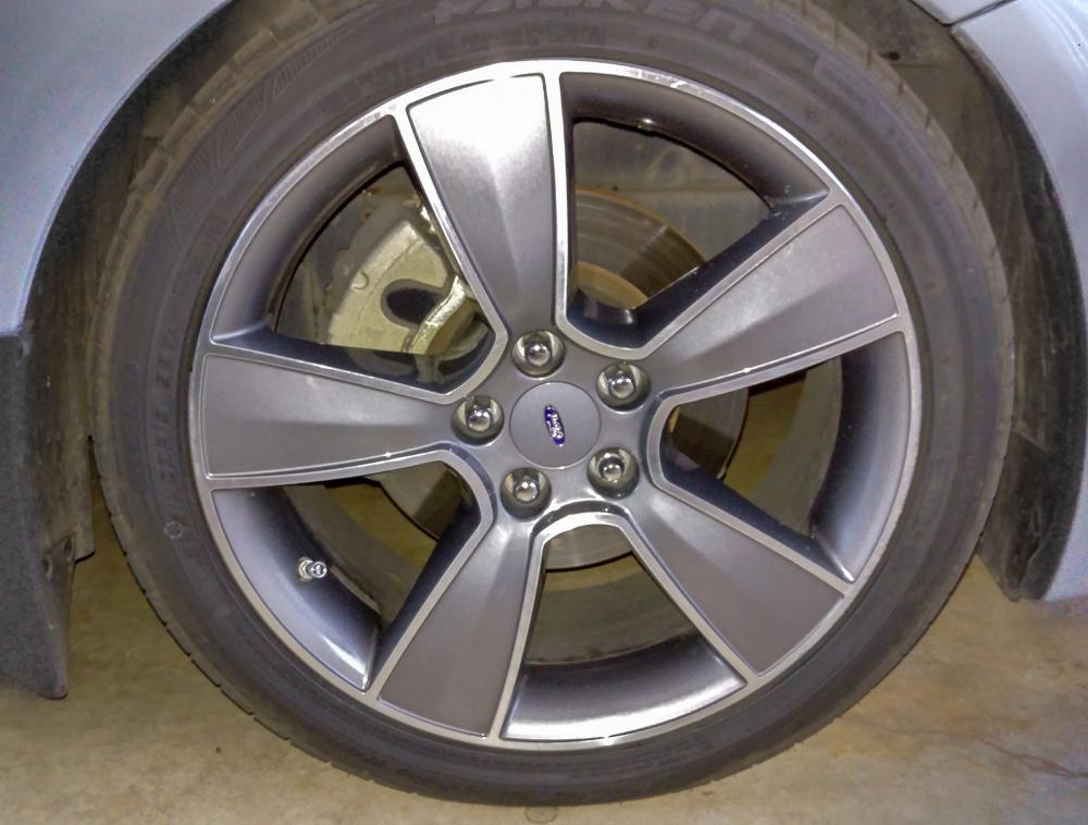

Last year I had a standard 2005 BA XR6 Turbo ute, which meant having the standard boring PBR brakes. I’m a brake geek, which meant when I saw a vague advert for some Brembo calipers on Gumtree I rang the number. I kept getting the seller’s voicemail, but kept trying each day (as did numerous other people). It turned out that that he’d been away for several days, and when I did get him on the phone I had literally just driven past the road that his workshop is on.
I ended up buying a whole pile of stuff from a wrecked FPV BA Super Pursuit, including front and rear four piston Brembo calipers.
They sat around while I looked for wheels that would fit over the calipers. I was also indecisive about just how much money I wanted to tie up in the XR6 Turbo ute.
