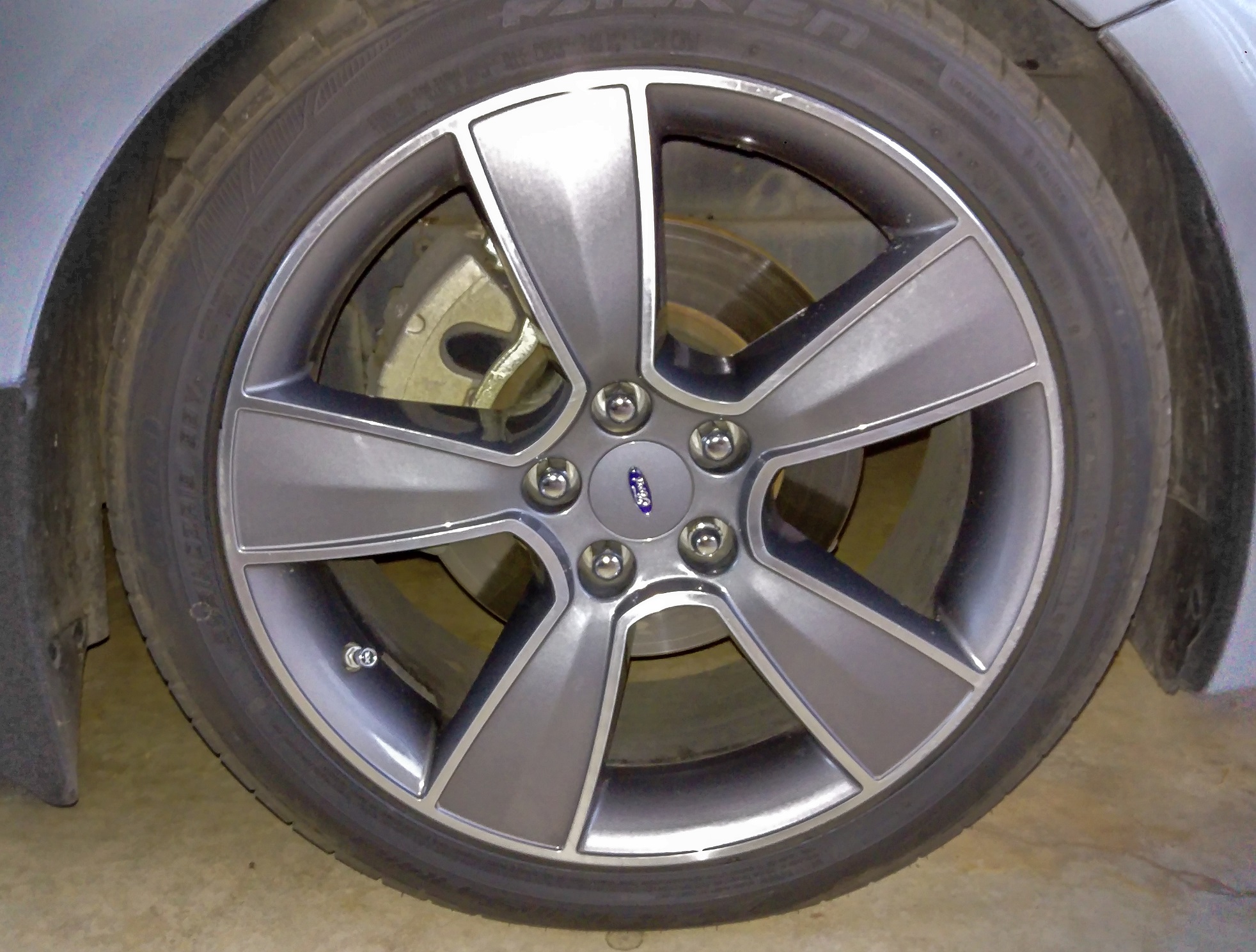

PhilMeUp Member 1,045 Member For: 18y 20d Gender: Male Location: Perth, Western Australia Posted 25/04/16 06:12 AM Author Posted 25/04/16 06:12 AM 11 minutes ago, bupalooga said: Well it looks like 6pot wont fit so 4's it is. The 4-piston and 6-piston calipers both require the same space behind the wheels. If a wheel clears the 4-piston caliper then it will also clear the 6-piston caliper. Post a photo of your wheels here and we'll be able to confirm whether or not they'll clear Brembo calipers.
bupalooga Legacy Donating Member 262 Member For: 13y 9m 30d Gender: Male Location: Griffith NSW Posted 25/04/16 07:49 AM Posted 25/04/16 07:49 AM 1 hour ago, PhilMeUp said: The 4-piston and 6-piston calipers both require the same space behind the wheels. Bugger. well that stuffs up my plans doesn't it. 19" FG turbo 50th Anniversary rims
