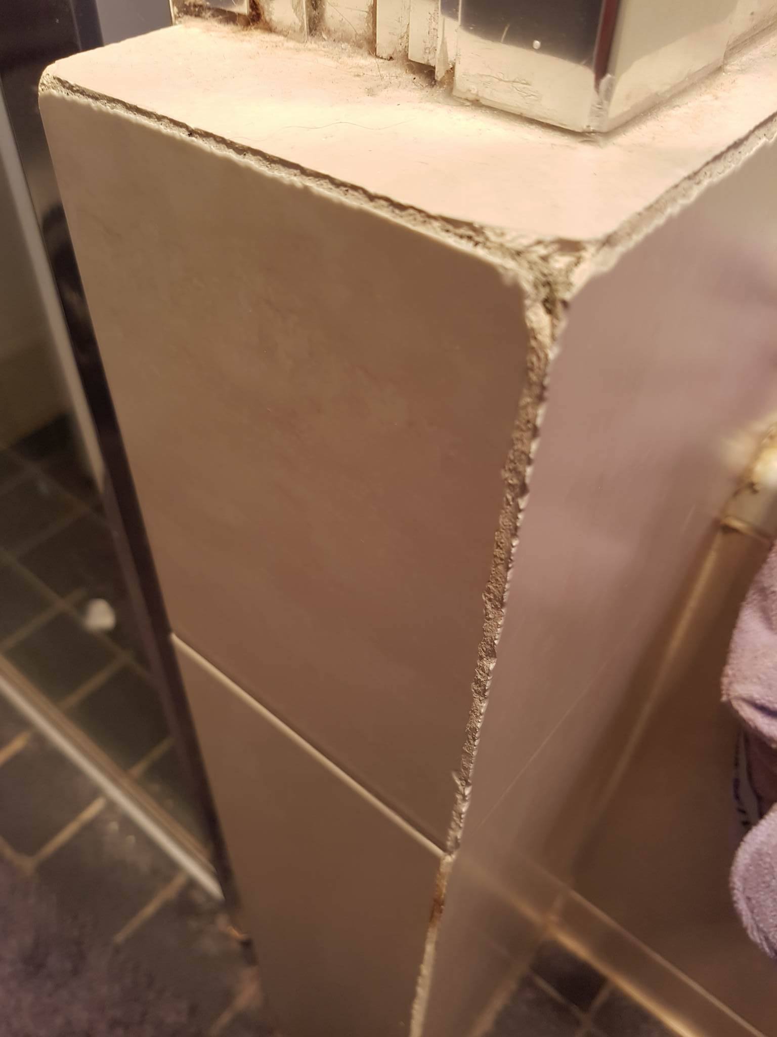

lookin good pixy, be polite but firm towards the builder. works best I think.
speaking of tiling. have a look at my main bathroom hack job some previous owner left me and tell me you got it bad!!!!!!!!!!!

Holly crap freaky what were they thinking that would drive me nuts every time I go in.

what the fark is that......

bahahahah
supposed to be a nib wall bath to the right. shower screen on top.
the other side off the nib wall (shower) the tiling is not even mitred just butt joined. hahah

I dont even know what to do with it. cbf renovating the bathroom. its had a terrible DIYer have a go at the whole thing
putting money going towards the kitchen next year instead.

Cheap easy fix for now would be 10mm×10mm L shape angle and spray it the closest color u can find then sikaflex it to the tile. Anything is better then that!!
If your any good with a grinder? put the angle on the tile mark where it sits with a pencil then gride a straight line into the tile along the lines then with the thickness of the grinder blade shave from the edge of the tile to the line u cut along the line.... this will make the angle sit flush with the tile and look half alright.
Ill do it with a tile at work tomorrow and load a vid up for ya!!
