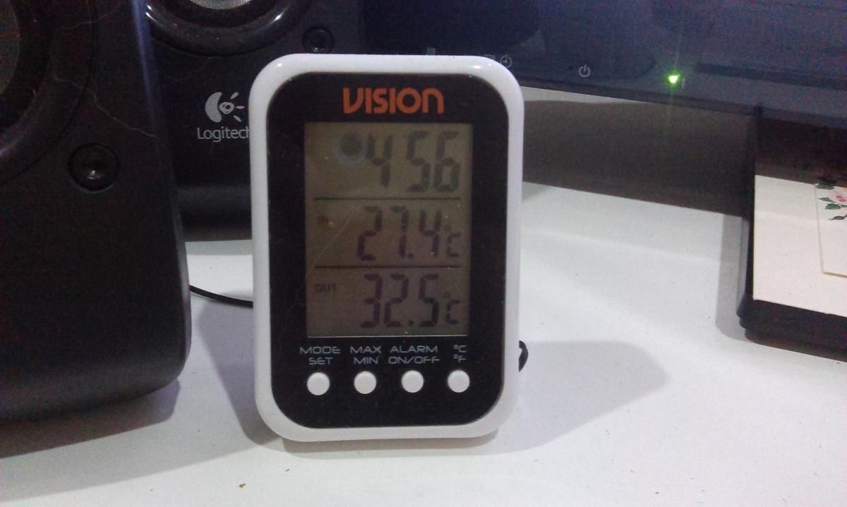

pic of computer currently pumping out the heat
room temp 27, computer temp (at idle) 32
