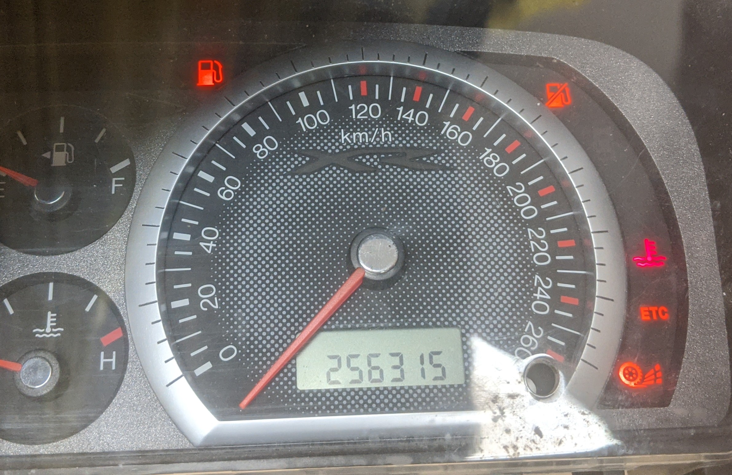

BeerTurbo Legacy Donating Member 241 Member For: 8y 2m 28d Posted 29/01/21 12:20 AM Posted 29/01/21 12:20 AM while I was wiring up my ford dash into my Nissan conversion I found it has a light for absolute low fuel level, ive never seen one as the 0 distance to empty busser is annoying enough. has anyone been game to runt here low enough to see the actual fuel low light come on?
bjc Legacy Donating Member 2,823 Member For: 22y 11m 2d Gender: Male Location: Townsville Posted 29/01/21 12:36 AM Posted 29/01/21 12:36 AM PW would have been the closest to seeing that light if he hadn't have nerfed the sensor. I don't remember ever seeing one but I could put a 10lt Jerrycan in the back when the fuel gets stupidly low next time to see if there's a light.
BeerTurbo Legacy Donating Member 241 Member For: 8y 2m 28d Posted 29/01/21 12:41 AM Posted 29/01/21 12:41 AM I think the middle top ones the one that triggers the 80km to empty.... then you see the one on the right? has a line through it....that's living dangerously.... 1

k31th less WHY; more WOT Site Developer 30,020 Member For: 18y 3m 27d Gender: Male Location: Melbourne Posted 29/01/21 03:20 AM Posted 29/01/21 03:20 AM I've run mine completely dry (BA N/A, BA2 F6, BA2 XR6T and BA XR6T) at going ~40-50km past 0 on the DTE (what can I say, I like to know the actual capacity of my cars; take a jerry can with 5L and run out deliberately) ... on the F6 after I changed the fuel pump I ran out at about ~20-30km past 0 on the DTE accidentally haha, which was a surprise as the engine was still idling but couldn't accelerate or put any load on it or it'd stall haha. On my first car (an AU XR6) it ran out about ~10km past 0 on the DTE, which was far more accurate than any B-series I've subsequently tried it in. Never saw a fuel-related light other than the normal fuel light (the top-left on in BeerTurbo's photo) in any of these adventures of deliberately running out of fuel (or the one accidental time haha) The standard "80km/40km/20km/etc" beeping is painfully early in the actual capacity of these cars, based on my testing of the above vehicles... No idea if Ute/Territory are different experiences, though, as the 68L tank in the sedan is obviously different to the 80L tank in the Ute or whatever is in the Territory.
