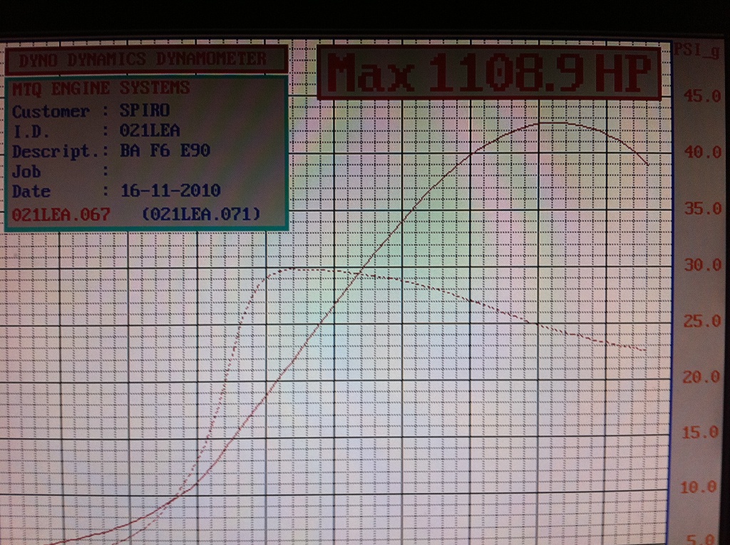

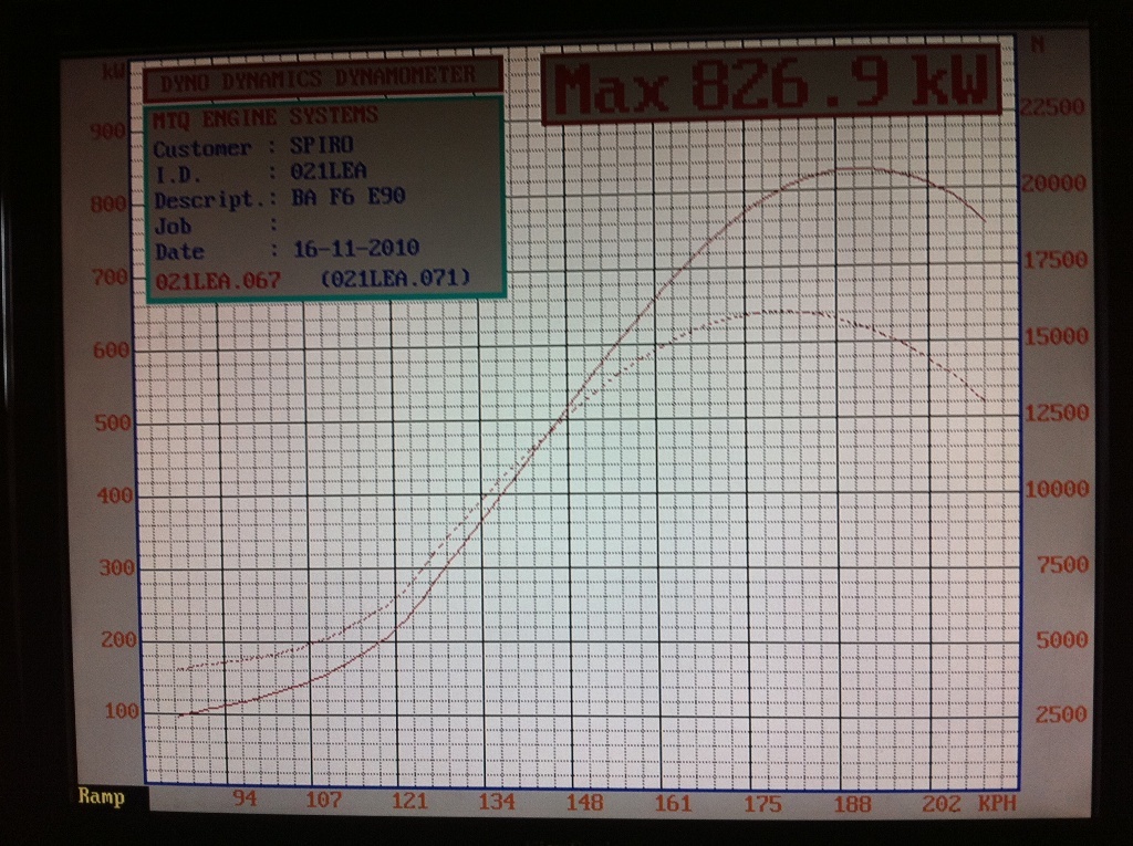

SPIKO Legacy Donating Member 1,924 Member For: 21y 3m 22d Gender: Male Posted 16/11/10 09:51 AM Author Posted 16/11/10 09:51 AM (edited) Ok I would say that we are 70% ready and that should be enough for tomorrow's testing.I cannot thank Jamie@FPT & 6Boost & Headsex for his help enough for the time and effort they have put in the old girl, overcoming the Stage 5+ Atomic cams has proven to be easier said than done when coupled with the headwork and massive increase in airspeed and flow especially on the exhaust side of things. Faced with the dramas of very high boost and the factory CPU not wanting to play that game under load in high gears we decided to take a different approach for the second set of testing so that we may overcome this problem. Basically we dropped the Roo and decided to give the E90 (thanks Bev) a crack so that we can compare apples with apples. Prelimanery testing has proven that it fairs very well thus far, I say thus far because we haven't been able to lean on the old girl because we ran out of injector & fuel flow early in the piece, so timing and boost is very moderate indeed. In a nutshell the new revised 7 angle valve job coupled with the extra clever headwork & Stage 5+ is proving to be a new beast all together. Now listen carefully 0% duty cycle in the wastegate otherwise known as wide open spring pressure the old girl spat out a peak 1108Hp @ a peak 25 to 26psi before we ran out of fuel even that was at 12.5 afr's & 80psi through the reg Atomic My initial calculations state a minimum of 30% gain over the old configueration utilising a stable test platform with the only changes being the fuel......... Same Turbo Albeit top secret as before and same dyno for testing...We will wind it back a little and continue testing at the track tomorrow before we change the fuel system and injectors yet again and really wind the old girl up as we progress Edited 16/11/10 10:01 AM by SPIKO
GOLDIE My new toy Legacy Donating Member 5,344 Member For: 23y 3m 7d Gender: Male Location: stanthorpe wine capital of qld. Posted 16/11/10 10:27 AM Posted 16/11/10 10:27 AM that is just mind blowing mate cant wait for tomorrow night Ian

The_Bogan Legacy Donating Member 881 Member For: 19y 3m 26d Gender: Male Location: Brisbane, Queensland Posted 17/11/10 12:36 AM Posted 17/11/10 12:36 AM congratulations sir spiro!!!!!!going to be awesome to see this do a full pass!!!
