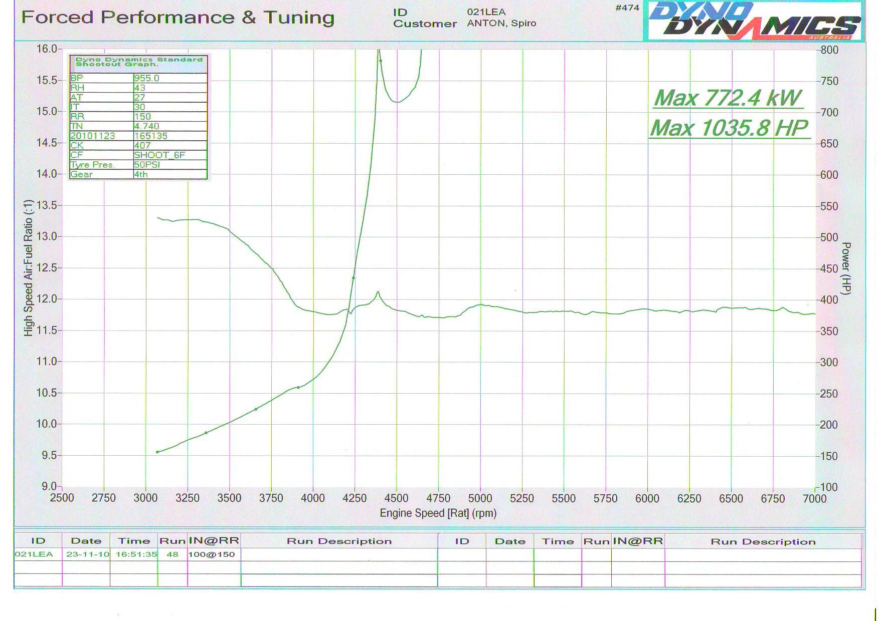

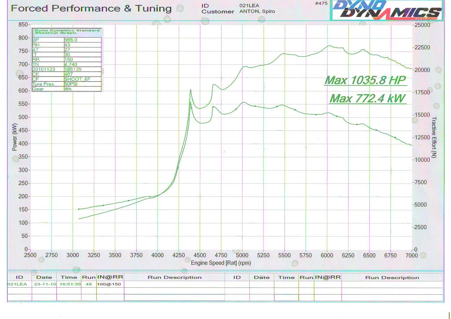

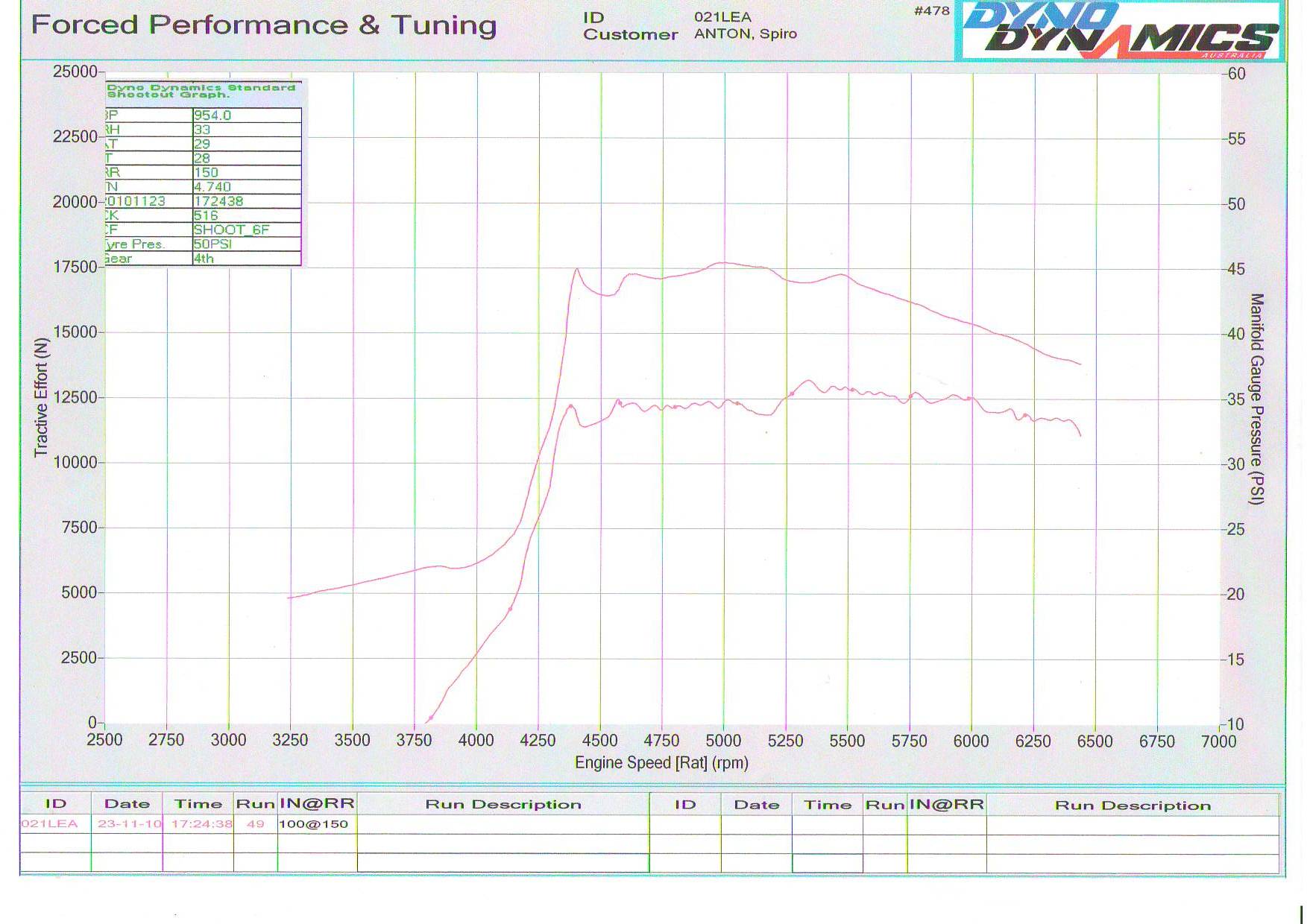

SPIKO Legacy Donating Member 1,924 Member For: 21y 3m 19d Gender: Male Posted 23/11/10 10:44 AM Author Posted 23/11/10 10:44 AM Well I can truly say that we are as ready as we can be to start initial testing tomorrow After a mammoth effort by Jamie (FPT) & Kyle (6Boost) it has been proven that when they are given the time they can overcome major hurdles Let us not be fooled gentleman the cams and head-work on the old girl are massive & un-chartered territory on the factory CPU I can honestly say that after spending a day with the boys today that we are confident that all voodoo issues at level 1 from 3 in total testing parameters have been achieved A little vid dedicated to Dario regarding Id 2000's massive cams and Idle AFR We are happy with this starting point for testing Now lets look at some really serious boost and torque (Traction?)Now we are happy with these AFR's On an ending note I figure you fella's have seen enough dyno pull vid's, hopefully tomorrow I can provide you with a track vid, we will let the mph do the talking from here on end

6BOOST Legacy Donating Member 139 Member For: 18y 6m 3d Gender: Male Posted 24/11/10 11:44 AM Posted 24/11/10 11:44 AM Unfortunately today got the better of us with the weather, but it wasn't all bad as we got to do some final checks on the car to ensure that it will perform as flawlessly as we are hoping it will. For those that didn't pick it up, the first dyno sheet doesn't match the second with the 35psi boost pressure, look at the torque figures from each pull and it may give you an idea of "stage 3" What was the previous pb torque Spiro? 16500?? :roflmbo: 6boost
6BOOST Legacy Donating Member 139 Member For: 18y 6m 3d Gender: Male Posted 24/11/10 11:46 AM Posted 24/11/10 11:46 AM Oh, and for those wondering, without asking, the dip at the start of the curve is wheelspin
