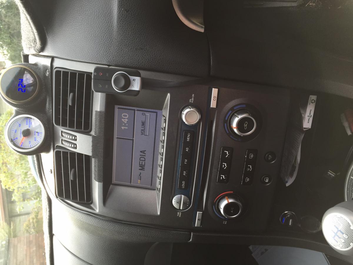

Serangan Member 103 Member For: 12y 10m 14d Gender: Male Location: Hobart, Tasmania Posted 11/07/15 04:14 AM Posted 11/07/15 04:14 AM Bluetooth kit installed - was a clearance item from Repco that looked usable.Takes the output from the factory speakers, passes it through a set of relays - default is pass through and chances this if it detects an audio signal on the Bluetooth side. Seems to be working well also hooked up the factory mute option with it.The way its wired up I could probably hook up a 4 channel amp quite easily if I wanted - 'The Trusty One' does have much in the way of amplification.
