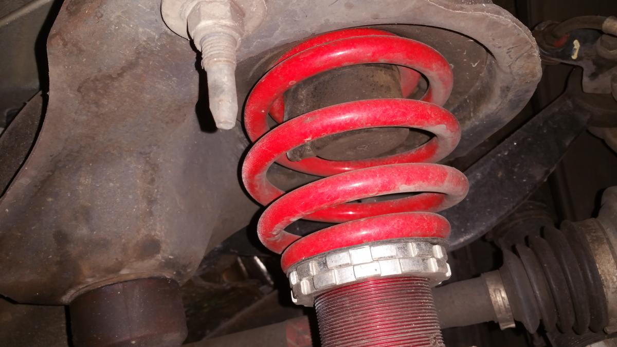

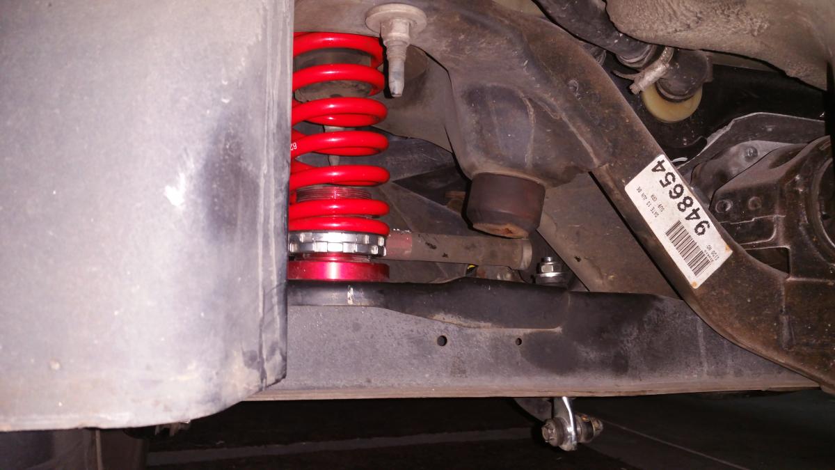

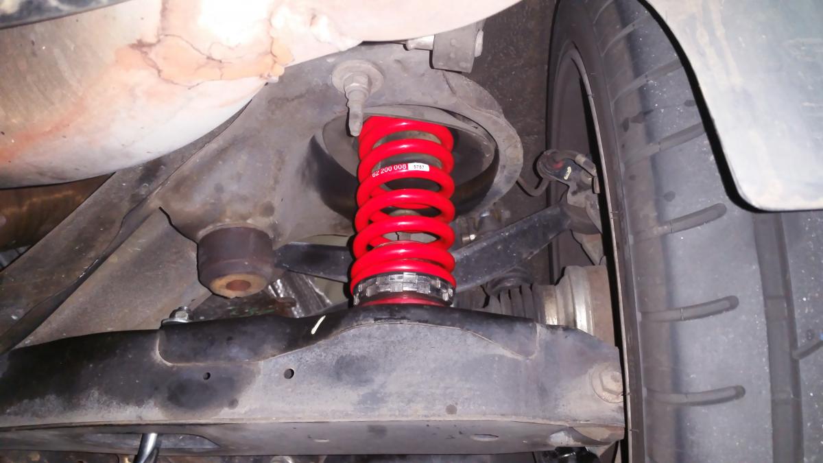

Ralph Wiggum Moar Powar Babeh Legacy Donating Member 19,334 Member For: 20y 10m 11d Gender: Male Location: Perth Posted 24/07/15 03:45 PM Posted 24/07/15 03:45 PM Retired the 4.5yr old rear springs and went with a set of Pedders Motorsport rears. Same spring rate as before (8KG) but slightly longer length (200mm vs 180) so it will be interesting to see the net effect on stiffness.The rears had sagged over the years and adding the optima battery in the spare wheel tub and sub/box hadn't helped the cause. My main goal was to regain some height adjustment and and so far in static height i've pick up aprox 15mm (have gone from 70mm hub to lip to 85mm, with an 18") which puts the rear control arm aprox 5mm above level, which is just how I like it.BeforeAfterkthnxby 4
Tocchi Sandtrap Motorsport Legacy Donating Member 2,055 Member For: 17y 8m 10d Gender: Male Location: Perth Posted 24/07/15 04:30 PM Posted 24/07/15 04:30 PM They look good !!! So new.Talking about newish, how cleans that part number sticker

Ralph Wiggum Moar Powar Babeh Legacy Donating Member 19,334 Member For: 20y 10m 11d Gender: Male Location: Perth Posted 25/07/15 03:58 AM Posted 25/07/15 03:58 AM No need,bump stops are in the shocks.
HI PSI Member 1,589 Member For: 20y 2m 9d Gender: Male Location: Central Queensland Posted 25/07/15 08:39 AM Posted 25/07/15 08:39 AM Retired the 4.5yr old rear springs and went with a set of Pedders Motorsport rears. Same spring rate as before (8KG) but slightly longer length (200mm vs 180) so it will be interesting to see the net effect on stiffness.The rears had sagged over the years and adding the optima battery in the spare wheel tub and sub/box hadn't helped the cause. My main goal was to regain some height adjustment and and so far in static height I've pick up aprox 15mm (have gone from 70mm hub to lip to 85mm, with an 18") which puts the rear control arm aprox 5mm above level, which is just how I like it.Really keen to hear your thoughts on these, as my springs have sagged and need replacing.....
