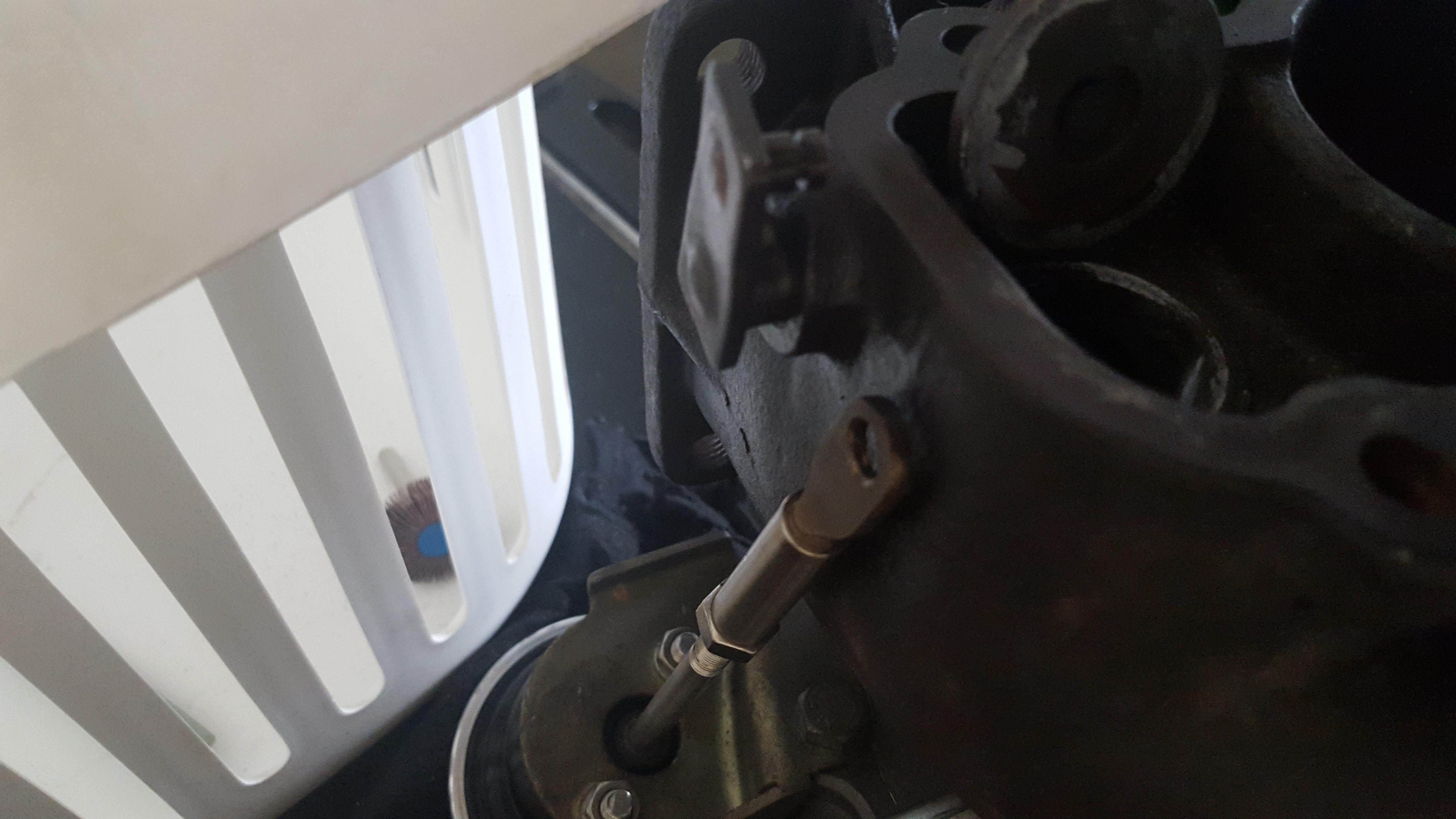

bamk2f6tornado Legacy Donating Member 777 Member For: 12y 8m 13d Gender: Male Location: Rockhampton Qld Posted 03/11/15 10:27 AM Posted 03/11/15 10:27 AM Over the last couple days after feeling really motivated iv been completing all the real crap jobs that have accumulated over the past year. So far done-Permanently fixed the battery cable to the chassis rather than cable ties to fuel lines lolWired in sub/ampRe bushed the front eye in the leafsAdjusted handbrake Hardened rear koni'sFuel filter 2 blown indicatorsRemoved standard FPV boost gauge coz eboostAnd lastly removed turbo to Port out waste gate. I told myself I would never remove it again after fitting my actuator a year ago. Forgot just how sh*t the job was. But definitely worth it after finding this. The tuner was the last one to adjust the waste gate and they appears the c clip has fallen off or wasn't installed. Even if it was c clipped properly the preloaded was set in the wrong direction so it would hold the gate open a little at idle. I have always thought the car was quite laggy but have never driven another turbo falcon or any other fast turbo car so nothing to compare it to. It's been like this the day I got it back from the tuner (insane performance) Adjusted the wastegate and fitted a new clip. Can instantly tell it's a completely different car. Spools instantly and when reving at idle it will get a few lbs and flutter. So only babying it at the moment till I can get it up to Dave at cpv after Xmas for a PROPER tune. 7

k31th less WHY; more WOT Site Developer 30,020 Member For: 18y 4m 6d Gender: Male Location: Melbourne Posted 03/11/15 10:42 AM Posted 03/11/15 10:42 AM wtf... how does a mechanic stuff something like that up...
