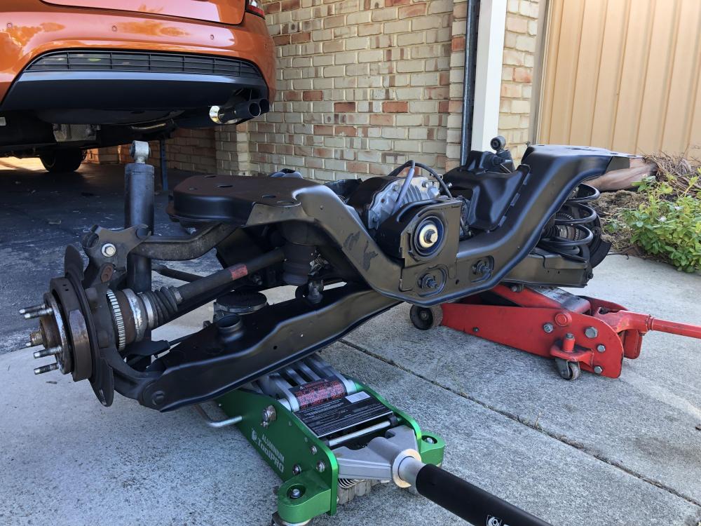

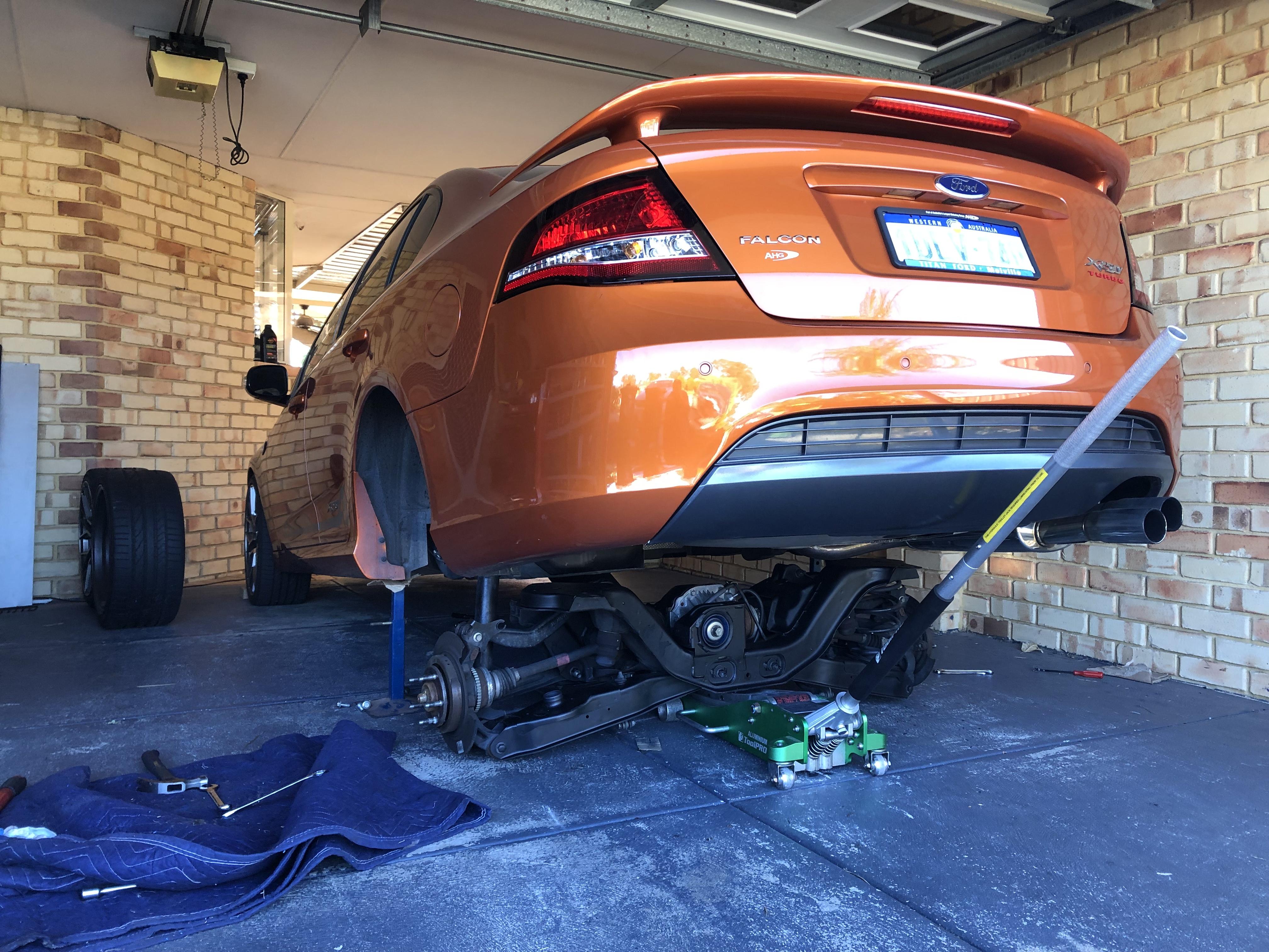

Finally got around to replacing these. Highly recommend paying someone to do it 😂.  And no I don’t have a hoist. And yes it’s a massive PITA lol.3CE763E6-DE76-4FAB-9F8D-F4FB62F103C9.thumb.jpeg.e70d774d87ee713ee6f28ab1920480da.jpeg532597CA-B7A2-4390-AD64-12C13C066E64.thumb.jpeg.60fe728cd85553d175f66f89aac85d01.jpegC0D7D985-B441-43F3-8A96-FA3451D588E7.thumb.jpeg.e612d87f1e0267f08298381882c8ca1f.jpeg

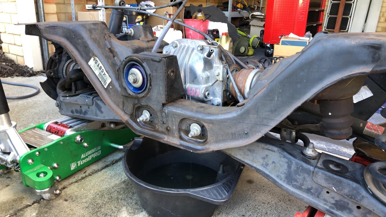

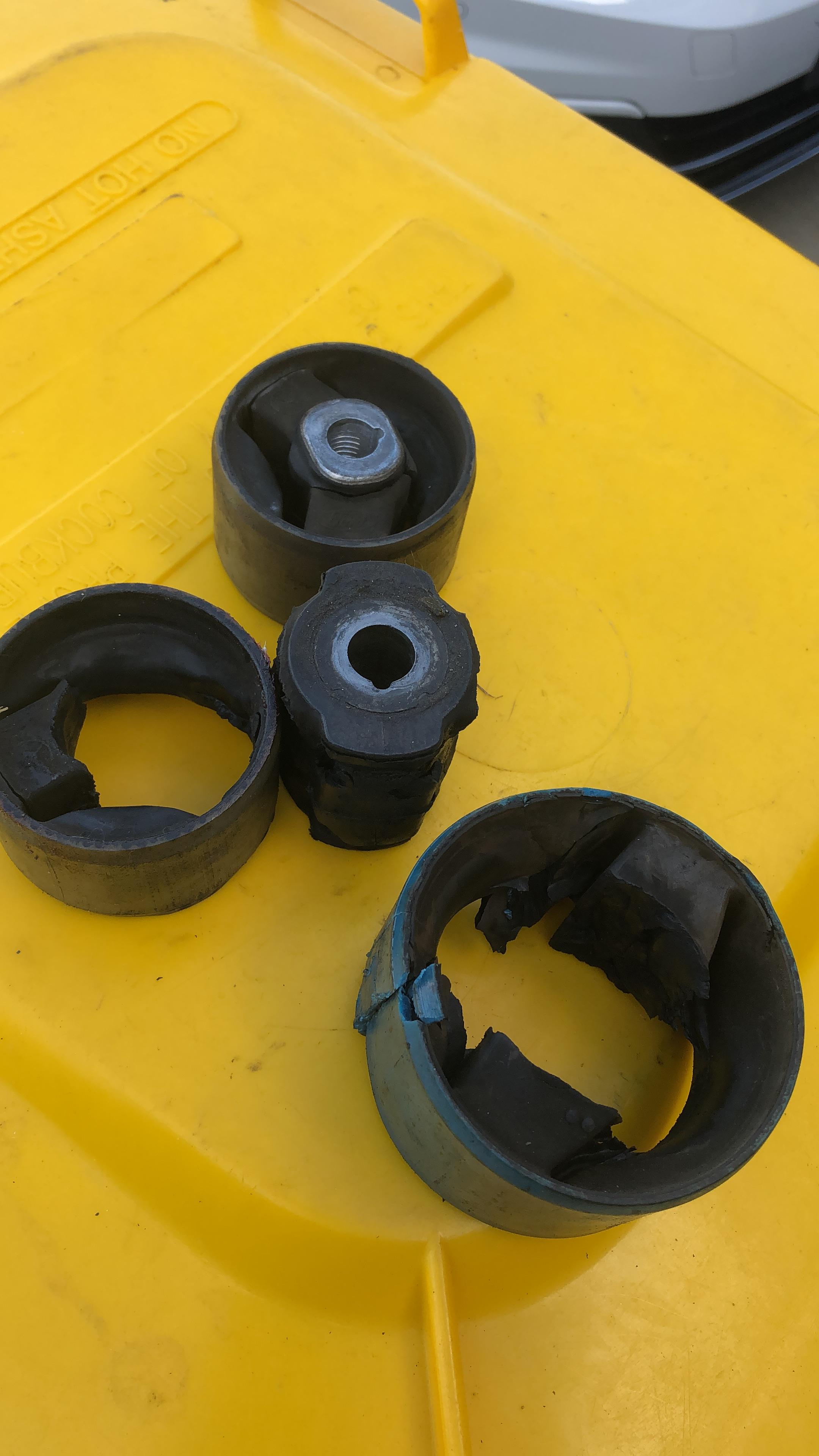

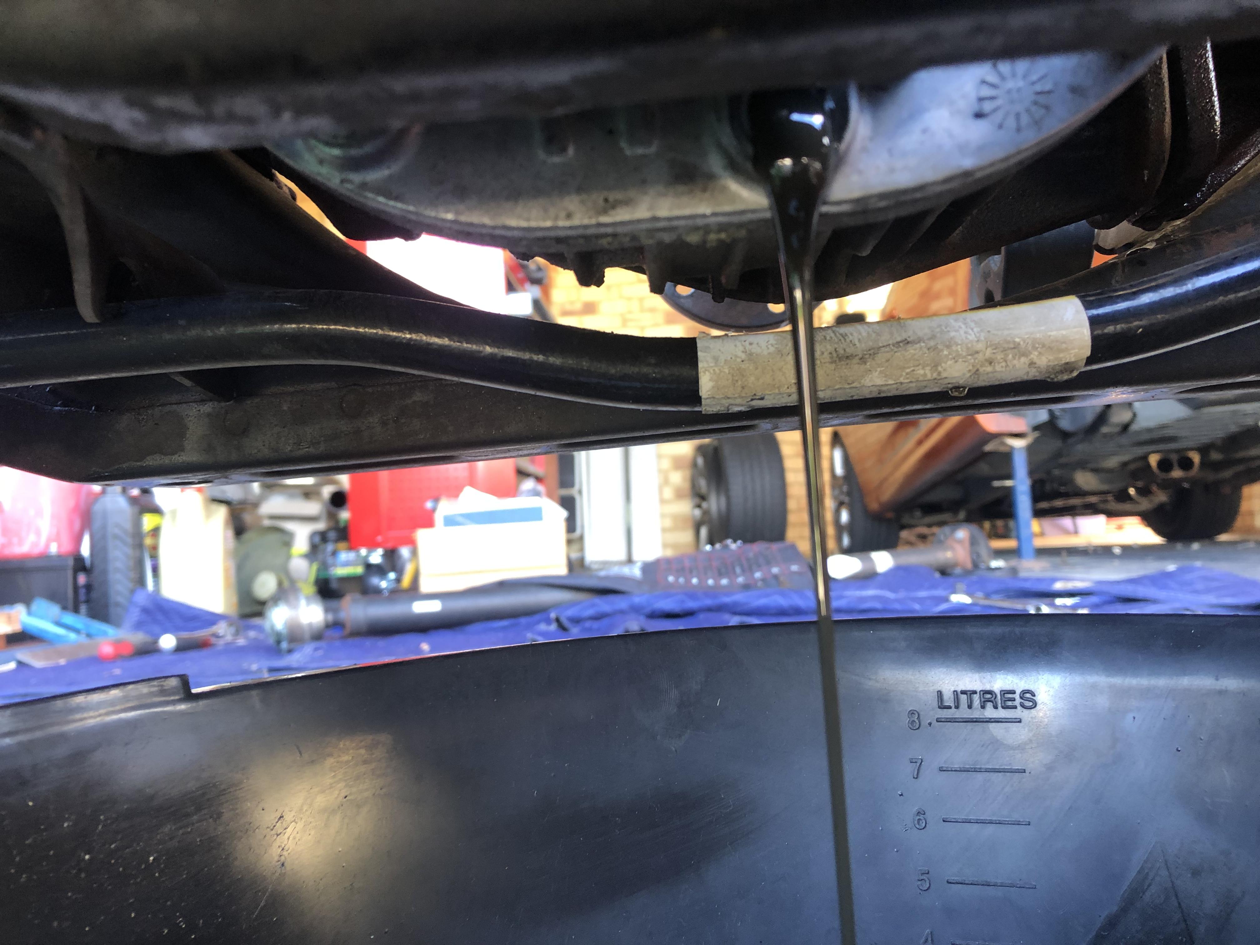

Day 2 of diff bushes. Thought I’d post up a couple more for those who might attempt this abortion.  Replace tranny donut and diff bushes with Superpro comfort bush kit. Wanted to do uni and center bearing but can’t do it without a press and there are no circlips like on ba-bfs. Anyways, have had terrible vibration getting worse with the centre console feeling like it’s going to explode 1500-2500rpm 😩.  So happy now it’s all gone and the diff clunk gone too obviously 😋4FBAA2D3-3B81-4EE1-8019-B07B8491D047.thumb.jpeg.a09623699893fdab00dde385f69a6c71.jpeg1EB6C08F-9378-4268-916F-E7F20E955F22.thumb.jpeg.6fdc9177e6311be43850c9bd29c1a025.jpeg

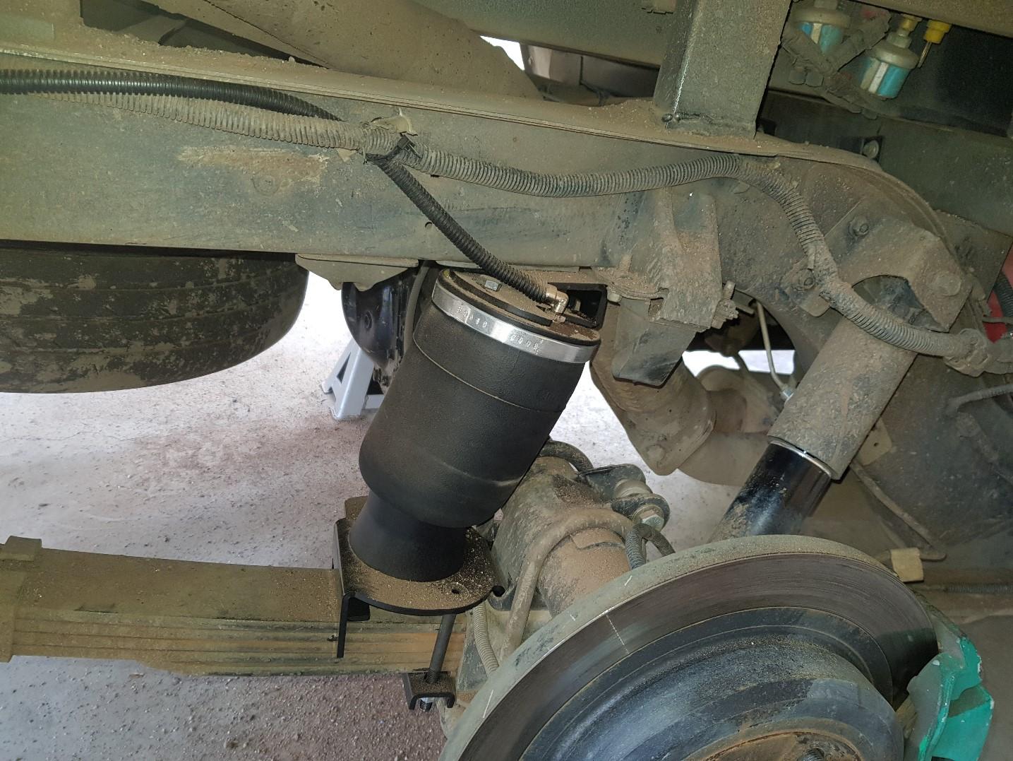

Last weekend installed Airbag man RR4660 airbag kit in the turbo ute. Was getting sick of laying frame getting in and out of job sites while loaded up.

Haha, only got 1 video so far, flat out with work atm.
Ill chuck pallet of bricks on the back, that always lays her flat! Front coilovers are always on a 'construction site compatible' setting 😂
