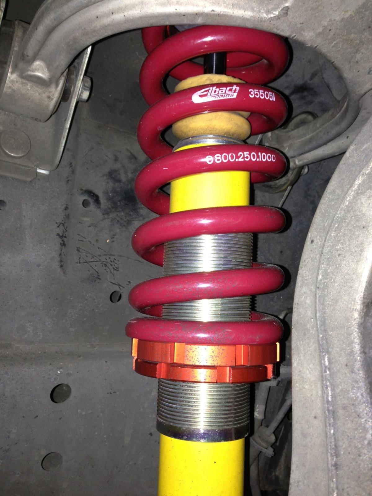

nelsonian101 Legacy Donating Member 961 Member For: 18y 1m Gender: Male Location: Sydney Posted 28/07/13 11:22 PM Author Posted 28/07/13 11:22 PM I almost won your old front shocks on ebay, but was concerned it would be too harsh for my daily. Keen to get to handle thoughThe previous front koni coilover set up was a bit harsher than my current bilstein set up even when the spring rate was much lower, but still fine for street.I've had a lot of front spring shock combos (7 actually!) and the current one is perfect both for street and circuit.It is a custom made Bilstein Coilover from Heasemans with a 1000lb main Eibach spring with a 2nd soft spring on top for small road bumps.The Bilstein is heavily revalved internally to cope with the spring rate (done in house at Heasemans/Bilstein in Sydney). I cannot recommend this front enough!Definitely not too harsh for the street. Big solid, front sway bar is also essential. Superpro bushes in there too and simply holes drilled (and bolt shift) in the upper control arm bracket for camber adjustment.
vxr50t Member 134 Member For: 13y 3m 14d Posted 28/07/13 11:57 PM Posted 28/07/13 11:57 PM Hey mate how much did your current suspension setup set you back? Sent from my GT-I9300 using Motorculture mobile app
nelsonian101 Legacy Donating Member 961 Member For: 18y 1m Gender: Male Location: Sydney Posted 29/07/13 12:04 AM Author Posted 29/07/13 12:04 AM Hey mate how much did your current suspension setup set you back?Sent from my GT-I9300 using Motorculture mobile appAll up, maybe $4-5k? 1
