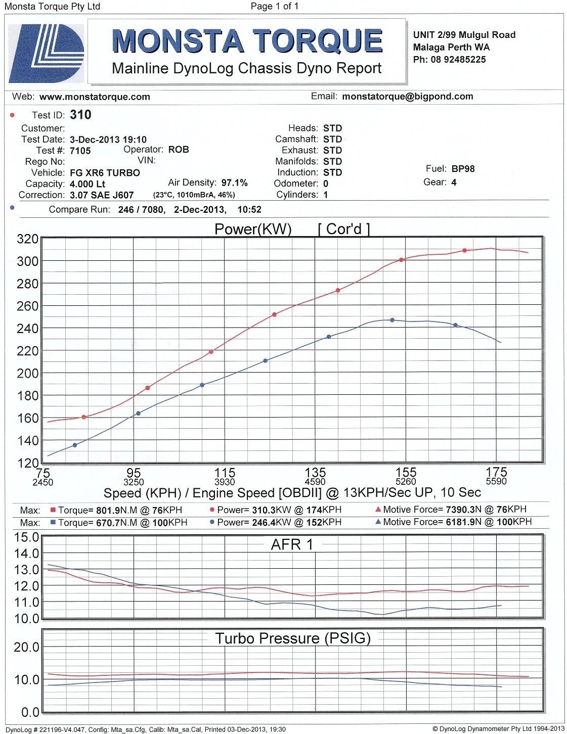

GeGe6 Legacy Donating Member 1,980 Member For: 14y 27d Gender: Male Location: Perth, SOR Posted 08/12/13 07:21 AM Author Posted 08/12/13 07:21 AM Update. Well got the car prepped for tune by doing the following. Cleaned throttle body, Herrod CAI and boost solenoid. Had new Nitto Invos fitted (found out had a buckled rim). Brought new plugs ready for gaping and dumped engine oil and replaced. Delivered car Tuesday morning early after bolting in venom high flow cat and filling with fresh BP98. By Tuesday afternoon all the bolt in stuff was done. Process West Stepped Intercooler ID1000's Herrod CAI Venom Cat Xcal I hang around most of Wednesday waiting for it to hit dyno, but it was not to be.:( On retuning Thrusday, I spoke to Simon when I went to pick the car up keen to find out how it went, not to mention getting it back to see how it goes. Simon had told me the car was pinging through the top end when he was running it up. He said that through the top where the little turbo starts to run out of puff, he would normally advance timing. In my case he had to retard timing due to pinging! When I asked what his thoughts on why it was doing this, he questioned the type of fuel the car had been running. The car has only ever been run on 98ron. So could have I just been unlucky and filled up with poor BP98? Would love to get to the bottom of why it was doing this! Not for the rwkw numbers but to know car is at its best. Would love to hear thoughts on what people think in regards how the car looks on dyno sheet?
Henz Tampon inserted, Auto Acquired, next purchase a new handbag Legacy Donating Member 9,946 Member For: 18y 4m 14d Gender: Male Location: Vic Posted 08/12/13 08:03 AM Posted 08/12/13 08:03 AM Looks like a neat curve, doesn't fall over up top either.
GeGe6 Legacy Donating Member 1,980 Member For: 14y 27d Gender: Male Location: Perth, SOR Posted 08/12/13 08:05 AM Author Posted 08/12/13 08:05 AM Any thoughts on the pinging issue? Sent from my iPad using Tapatalk HD

GeGe6 Legacy Donating Member 1,980 Member For: 14y 27d Gender: Male Location: Perth, SOR Posted 08/12/13 11:08 AM Author Posted 08/12/13 11:08 AM My concern, lies with tuner saying it was ping through top end and the over all quality of tune as a result. 1
