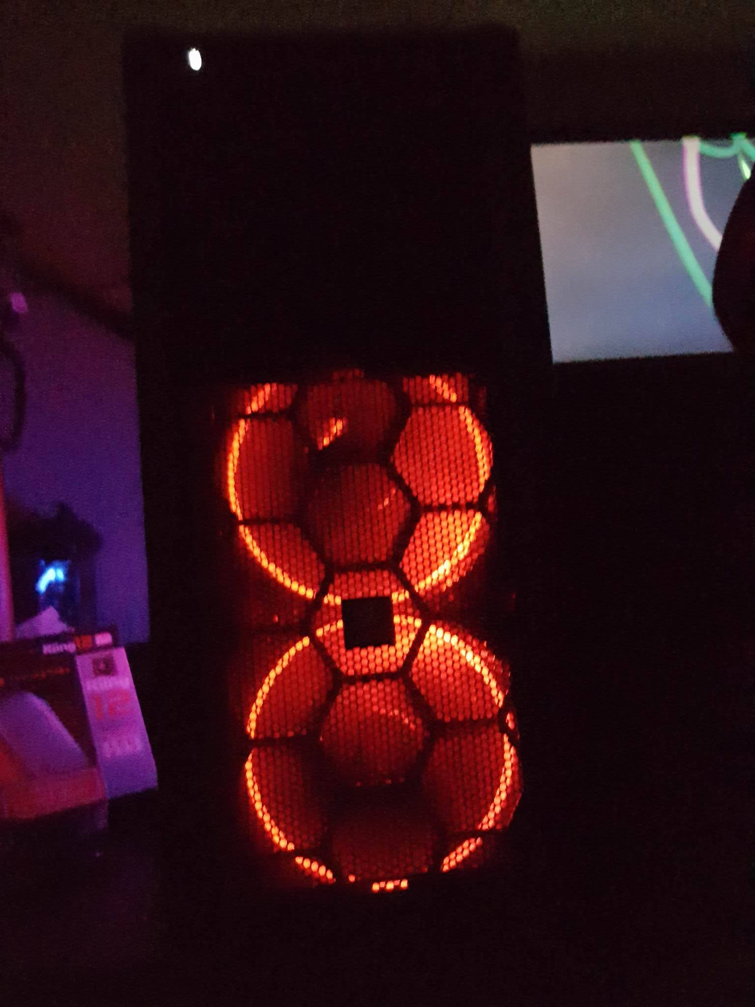

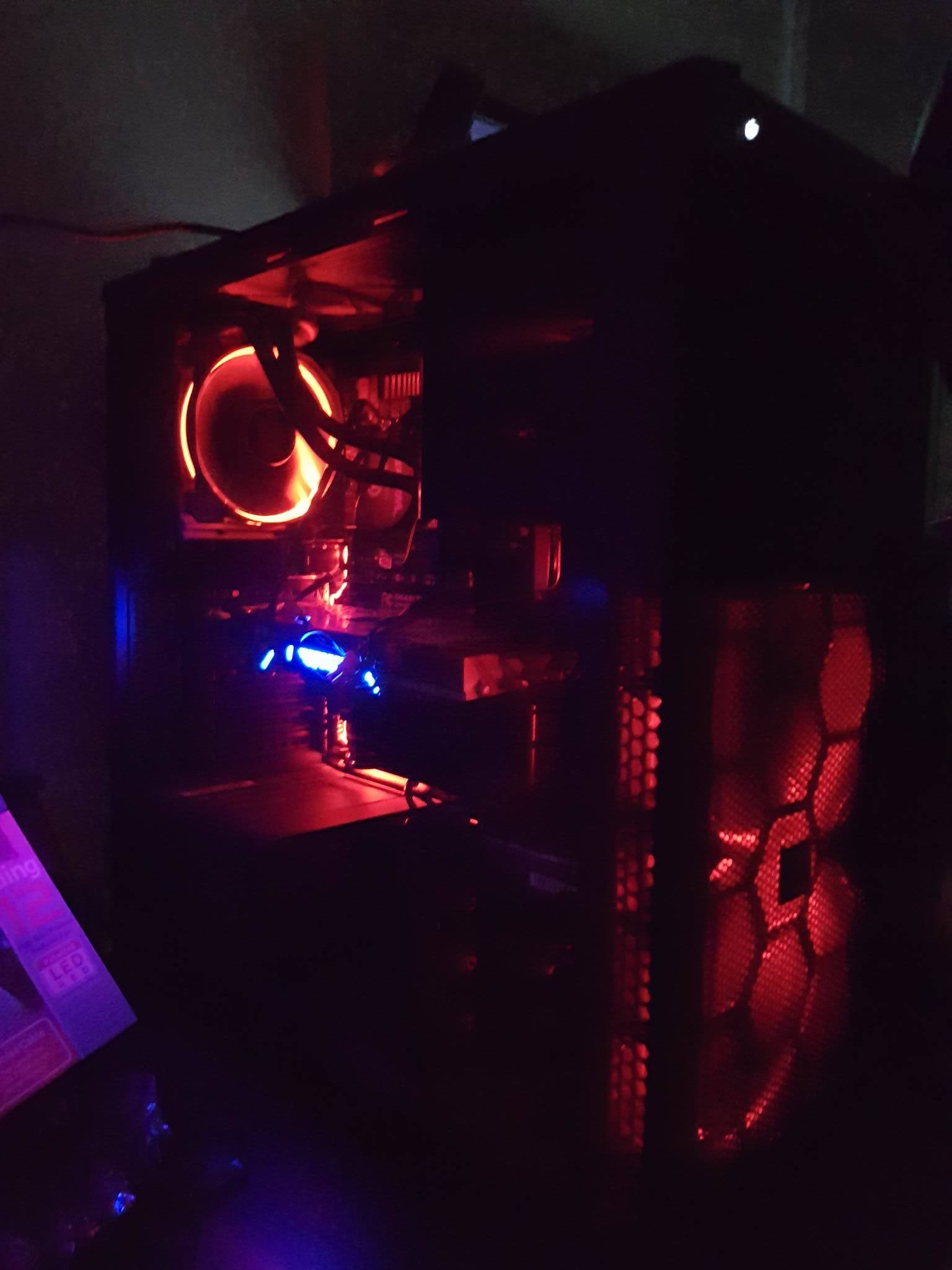

bossmang FREAKY Legacy Donating Member 12,441 Member For: 16y 6m 28d Gender: Male Location: Melbourne Posted 27/01/17 11:22 AM Posted 27/01/17 11:22 AM (edited) yer I have connected all the new fans to the mobo and I havent got any system fan spots left. and I bought 4 fans. :/ my pc has no molex connections anywhere either. atm the fans are on high set up from the bios like that. a bit noisy doesnt bother me though. looks like I should get a fan controller unit thingo. what are some good ones these days? as I might get a 5th fan. how she looks now the 2 big 140mm fans up front suck in shyt loads of air now the whole case temp has tropped heaps. very happy. and the 2 120mm fans are the exhaust. Edited 27/01/17 11:24 AM by Ford Freak 2
