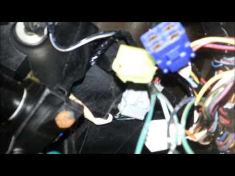

Ralph Wiggum Moar Powar Babeh Legacy Donating Member 19,334 Member For: 20y 10m 13d Gender: Male Location: Perth Posted 01/04/16 03:57 AM Posted 01/04/16 03:57 AM what brand of headunit? The mobile office connector behind the interior fuesebox has acc power, constant power and earth. Perfect spot to pic up what you need Blue plug in this pic/video Also search term "bf falcon mobile office aux power connector" returned this- WTF google? 2
