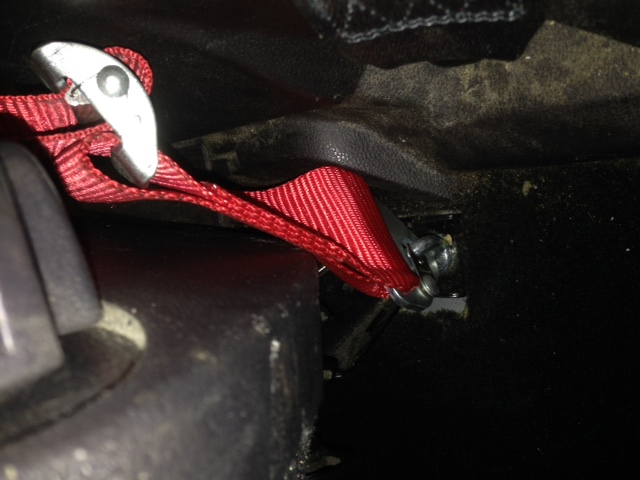

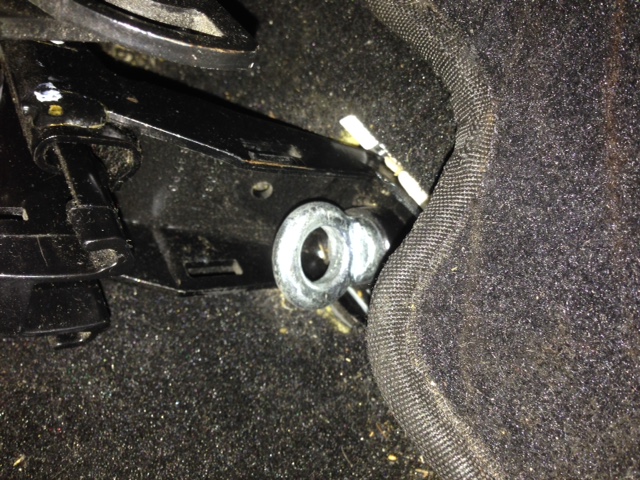

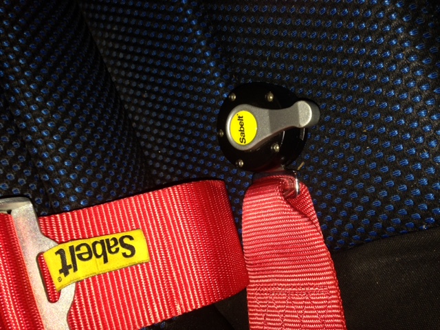

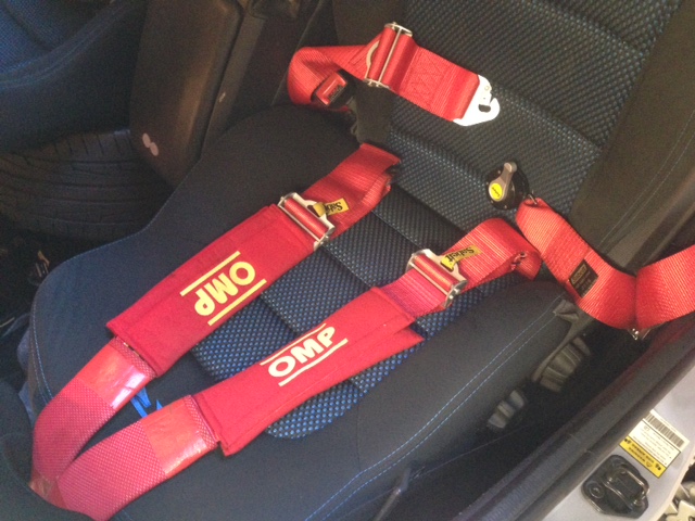

nelsonian101 Legacy Donating Member 961 Member For: 18y 20d Gender: Male Location: Sydney Posted 07/11/14 11:07 PM Posted 07/11/14 11:07 PM I recommend the CG lock as a first stage.I used one for a year or 2 and was great for stability until wider slicks were used. Too much hanging onto the wheel then.Next step was a simple 4 point harness mounted to the rear 2 seat base bolts for the hip section. Remove and replace with eye bolts.Rear, shoulder straps attached to the rear seat belt bolts under the rear seat which is very easy to remove. Just cant show you pics because I have 3 baby seats in the back at present and it's a bitch to remove them, but you get the idea.Great thing is the 4 point is versatile. Works with the stock seat belt too. No stuffing with air bags. Get a quick release one as pictured.You can also just use the hip section 2, I.e. 2 point harness with the stock seat belt.You need padding if you run the rear straps too. Cut into your neck a bit as this set up isn't ideal as a race seat.Works very well for me though.Hard to strap in first time. Make sure it's the last thing you do. I.e. trn off AC, traction control first etc as you cant reach anything in a harness on the dash. 2
furiousgibbon Member 86 Member For: 18y 10m 26d Posted 08/11/14 03:02 AM Posted 08/11/14 03:02 AM awesome, thanks for the info guys. I did some reading on the CG Lock this morning and just ordered a couple of them, so I'll see how they go at round 2 on December 4.I think the basic seat structure in the XR6 and the F6 is the same, but fabric would be a lot grippier than the 'leather' in the F6. I'll see how the CG Lock goes, if it keeps my hips in place I think I'll be much better off. The harness install looks great and easy, just wondering how the scrutineers will judge it the seat bolt mount points, they seem to get more fussy at every event and the CAMS schedule only mentions seat belt points as acceptable (but doesn't say what isn't).The NT01s were excellent but in the F6 I only have the Sport Maxx to compare them to. I've driven R888s before (a swift sport on the ring, and my E21 bimmer), and these aren't much different, definitely not as soft/squidgy feeling but I was running 36psi cold as I got a fricken screw through the front right just after I put them on, so I was nervous about the fresh puncture repair and didn't want too much tyre deformation.
