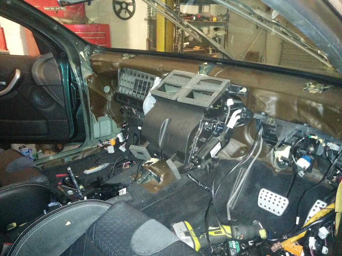

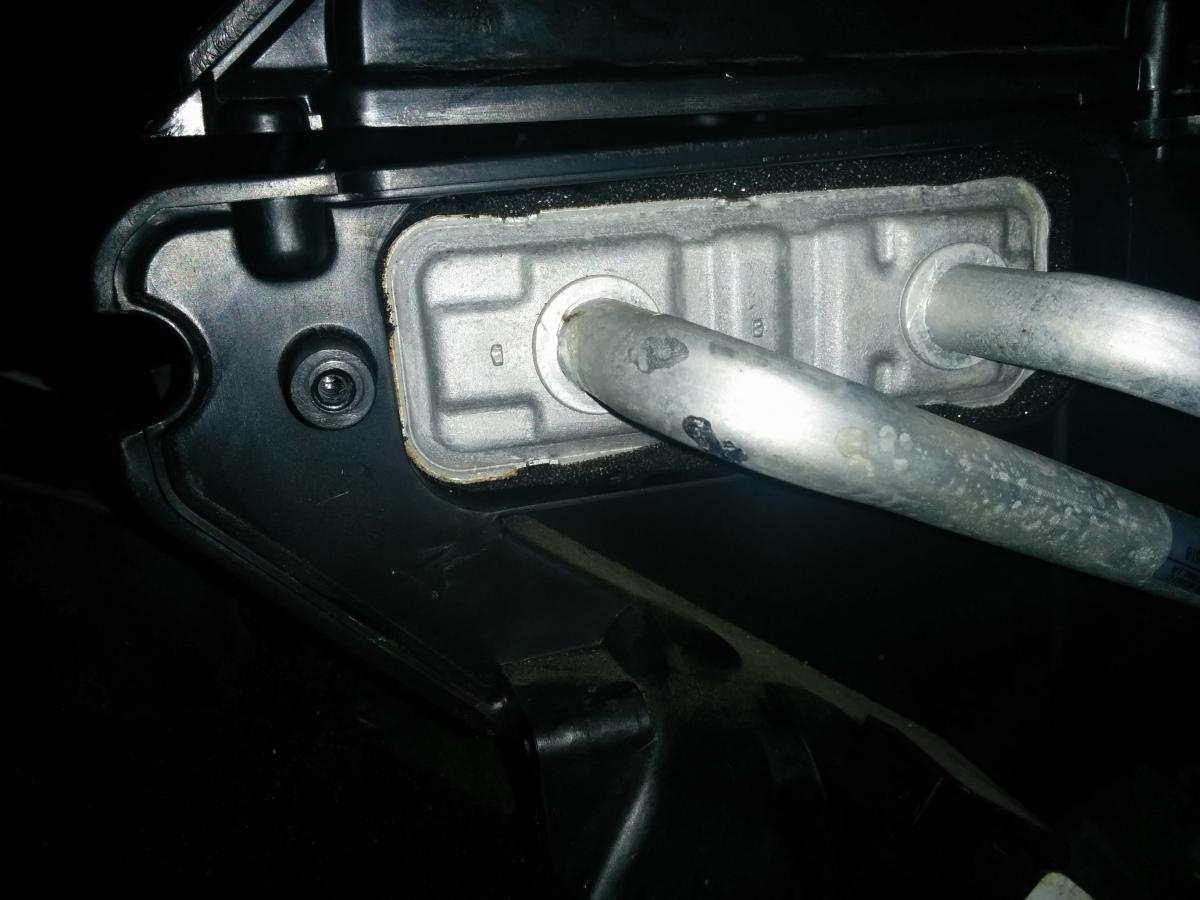

Ralph Wiggum Moar Powar Babeh Legacy Donating Member 19,334 Member For: 20y 10m 6d Gender: Male Location: Perth Posted 09/01/15 01:27 PM Posted 09/01/15 01:27 PM Set out to find the source of my Evaporator water leak.Symptom-Wet carpet/feet on drivers side we accelerating/cornering (left turns only) with enthusiasm and only with AC set to max cold ie "low" and max fan speedCurve Ball- Undercar drain is still working when car is stationary.So after a couple of hours I had this-and here's what I foundnuthin suss you say?Well with the pipe clamp removed the heater core does this- The lower sealing foam hes deteriorated the result is water sloshing up past it when taking a left hander or giving it the herbs (at least I hope i'm right as it's a helluva job to go round 2 on!)So tomorrow I'll be off to find some nice high density self adhesive foam to replace the failed bit and will probably back it up with some silicone. 4
